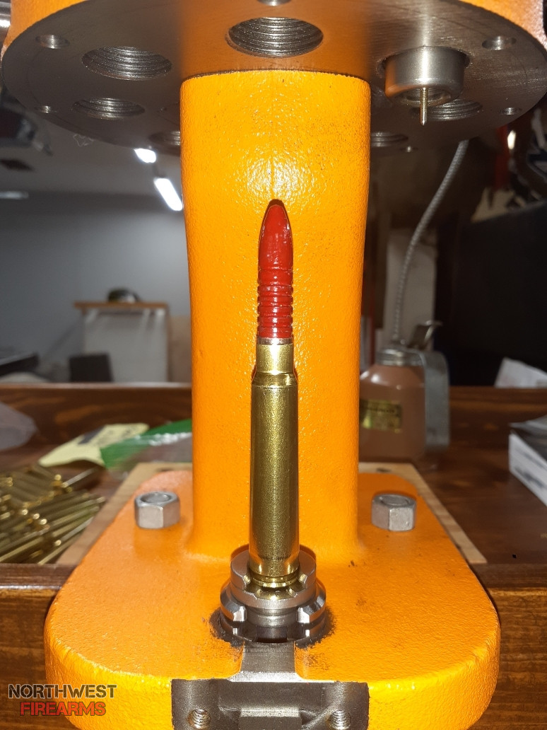

They work so well powder coated I actually went through my storage recently and melted down all my lubed boolits and recast them for coating. So much easier and cleaner to coat and process on the press. Not smokey when you shoot'em. BHN doesn't seem to matter as much either. Size matters😁.
