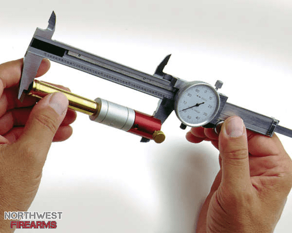

Will the Hornady Lock-n-load headspace gauge work for this?
Yup, that's what I was referring to above when I said case comparator. You start by measuring brass fired in your rifle, then set up your sizing die to bump the shoulder back by the amounts I listed above. Bear in mind, everything I said refers to full length resizing, if you're going to go with a neck sizing die, things are a little different. I've looked at both, as well as bushing dies, and have decided that for my loading, a standard full length sizing die is what works for me. Later.
Daved
When you get to using this ^ you'll be able to see the relationship between a brand new unfired round, a fired round and your resized brass. I use that unfired round as the basis for sizing my fired brass. Trim lengths, stated as "Trim To" in the book will put you within the specs for the chamber of the rifle. Something to note Re trim to lengths. One book states trim to length as 0.000". Another book will give two lengths, min and max. min= 0.000", max=0.010". This means you have 0.010" to play with when trimming. I don't want to trim more than I need to so I only trim for uniformity rather than trimming to the minimum.
