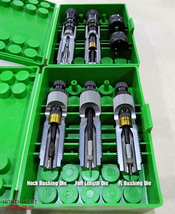

So to help me understand this better, a neck size die only touches the neck not the shoulder?
no.
A true neck size die will size the neck and bump the shoulder back. A bottle neck case will grow in length more than dia. So neck bumping is basically always required.
Reference attached pic of cutaway dies. You can hardly notice a difference between the FL (full length) die and the NK (neck) die.
And a full lenght die when backed out just enough to bump the shoulder that critical .001-.002" isnt fully supporting the entire case as its design intent?
Incorrect, it is.
A full length bushing die will always support the body of the case almost fully. Your talking a fraction of a percent less support from raising the die a few thou.
(Bit of a tangent but may help)
They also make whats called a small base die that are specifically made to size further down the body (even into the web/head area) than a regular full length die body would. These are basically made specifically for AR's/ semi auto/ machine gun fired brass whose chambers are ALOT greater maximum tolerance for reliability/cycling. Since this brass is most likely to fat around the base to fit any other chamber it needs a small base sizing die to get the bottom head area back to normal. This works the brass more and reduces brass life so generally they are avoided unless needed. Such as when you do a regular FL size and either drop it in a chamber type gauge or your chamber and it doesn't close the bolt.
There are many variations of full length sizer dies (SB) being one of them, they will ALL bump the neck and size the body to a certain degree.
This is also why i recommended the sheridan windowed guage, so you can physically see where your case isnt fitting the gauge..
(Might be the mouth, shoulder, body or base)
Calipers and the comparitors are very handy for measuring how much you bump the neck but its harder to measure the body of a case in a precise repeatable way unless you have like a optical comparitor or something. A case gauge has its place on the bench as well imo.
A phone call to the actual die maker might really help you understand the minutiae between their various dies they offer.
Redding customer support is top notch.
For instance im pretty certain Redding makes full length bushing die which is basically a full length die body that accepts bushings that you can order in every variation of .001" diameter. keep in mind those are outer neck diameters not inside which can vary with brass neck thickness and especially if your neck turning (which im sure you arent) which is basically think custom lathing the neck dia (cutting) to a custom diameter for uniformity)
They also offer this same die in a standard threaded stem format. And also one with a micrometer adjustment that separately controls how far down the bushing sizes. (So theres several adjustments, the die body up and down and then the bushing adjustments up and down as well.
Now again im fairly certain at least redding (last time i spoke to them) also make just a neck sizing die which has the same floating (self centering) bushings and bumps the shoulder but does not really size the case body.
This would be considered true neck sizing. Where the body isnt really touched. The case is left "fire formed" by the chamber of the rifle and springs back a bit when chamber pressure drops for extraction. Due to the elasticity of the brass.
