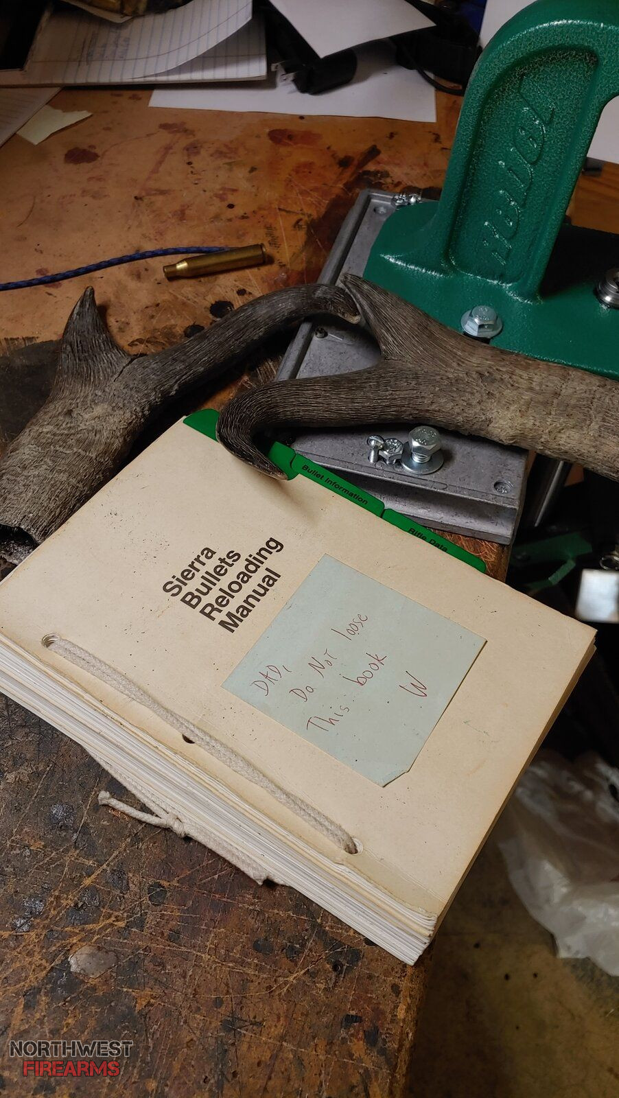

I'm pretty confident what little powder Ive scored will be ideal for this cartridge as its listed near the top of all the load data I've found so far 2lbs of IMR4831, I also scored a pound of R23 as part of the deal. It better work anyways cause it took me several weeks to find scouring the classifieds.
And speaking of load data a quick moment of serendipity connecting the past with the present as I found this old Sierra reloading book sorting thru a box of my late fathers stuff who passed away a year ago this week, yes its been a sobering week but the note I left my dad on the book years ago brought my whole day to a stop. (The horns he took with the very rifle Im reloading for).
dude that awesome! you should frame it in some UV resistant glass or something. its probably so outdated alot of the powders arent around anymore. but who knows, maybe some. im sure its a collectors item at least. NOT saying you should sell it.
glad you found it.
i wish i was close to my dad and had memories like that.:s0158:
glad you found it.
Its so old I dont really plan on using it though IMR 4831 is in there for my caliber. Its missing its cover but it says its the second edition and has a copyright of 1978 inside it which is odd because Im guessing it was about 25+ years ago when my dad got into reloading for a short while. I will keep it but not frame it but will figure out how to mount those horns on some wood and put on the wall next to mine.

I so enjoyed the photo of the note to Dad, the goat horns and the .25-06 case resting comfortably. A sentimental "still life".
I gave my father's .25-06 (Ruger No. 1) to his best friend when Dad passed. Last summer the friend (now one of my best) phoned me and said on my next visit I would be taking it home. The very first rifle I bought when I came home from the service (having all my guns stolen) was a Browning 78 in .25-06. The single shots now make a "helluva pair to draw to" as Dad would have said.
