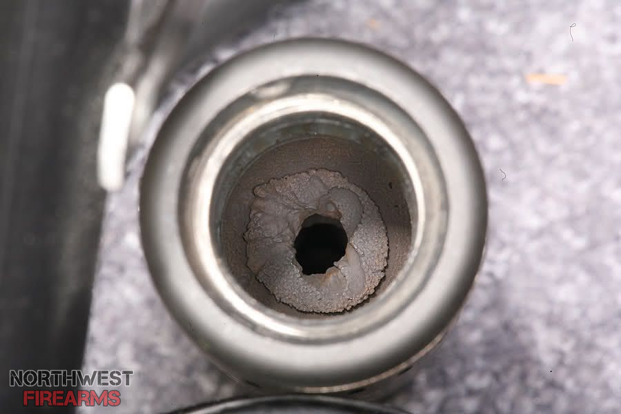

The muzzle break helps with erosion of the first baffles, unlike a flash suppressor which allows all the hot gasses directly against the 1st baffle.
OK, so the brake and flash suppressor both vent gasses out prior to the can. Wouldn't this be counter productive to having a can in the first place?
It's more of a sacrifice than anything to do with how the gases move. At any length superheated particulates exit the muzzle at extreme velocities, sandblasting whatever it comes into contact with. If it's a brake, those particles hit the baffles of it, vs a flash hider where the first thing those particle will hit is the blast baffle in your silencer. IE, it helps the investment you waited so long for, and went through all the paperwork for, last longer.
Baffle erosion is a real thing.
Which would you rather have?
The muzzle break vents some of the gasses sideways and that helps reduce erosion, but it's the suppressor jobs to slow down the super heated gasses before they exit and run into the cooler air outside the can, thus reducing the decibels.

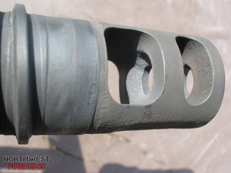

Not to question our resident 'Smith, but depending on the unit being installed, if there is any gap, I.E. a crown, it creates a mini blast chamber and will erode the crown and back side of the unit installed same as the baffles inside the suppressor! Ever pulled the brake off a well used AR, you'll see exactly the same effect! Now, If the break leaves the crown fully exposed, that's different, and that's when you WANT a true crown, just make sure there isn't a short bit of thread or extra material between the crown and the beginnings of the brake, other wise your going to see the same erosion in that part of the brake and it can effect the accuracy same as a bad crown! It really sets off my OCD to see ill fitted brakes or flash suppressors, especially when the crown isn't addressed!
