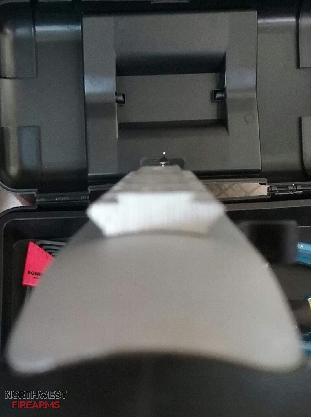

On my 10/22 takedown the rear rail for attaching reddots or scopes is too high and blocks the rear iron sight. Ruger should have put a v down the center. So even if you have a QD mount you will still need an Allen wrench to remove the rail in order to use your iron sight and then you'll have 4 holes in the reciever. No biggie it comes with plug screws . I'm sure I have seen aftermarket ones with a V down the center to allow the use of the iron sights . Just a heads up if you skipped using the iron sights on the applicable models.

Looks like you are far from alone with this.
https://smile.amazon.com/MRUB1022V2-Ncstar-Ruger-Mount-black/dp/B00VFVV7P0/ref=sr_1_2?ie=UTF8&qid=1525638127&sr=8-2&keywords=NC+Star+10/22+rail
NcSTAR Black Weaver Scope Base Mount for Ruger 10/22 1022 10-22 Rifle Rail V2 | eBay
Amazon and Ebay for starters offer one made by NC Star that claims to fix just this. Has a v notch down the middle. I don't know if Ruger has changed something here also. Had a hard time getting a good shot of it but on my 10/22 Take down the rail does not block the sights. I had a hard time trying to get a good shot of it with my phone. The rail is annoying on mine as it does come close to blocking the sights. I think I will try one of the replacements from Amazon. For $10 it looks like it's worth giving it a shot.

Even though it looks close groups will suffer. I believe I was shooting way low when I tried it with the rail. I need the bead at the bottom of the V.

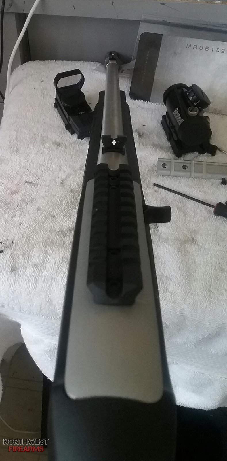

Try that one from NC Star. I have one in my cart now for the next order to give it a shot. For $10 I figure it's well worth trying. I found it first on Ebay and it was getting some positive reports that it did fix exactly this problem. My eye's don't work well with iron these days so after the initial trip out with our latest 10/22 I slapped a dot on mine. After I took it off to try to get a camera shot of it I tried to put one of the quick mounts I found a while back and have fallen in love with. I was kind of surprised to see it would not fit the Ruger rail. Apparently the rail that comes on with the Ruger is not a true 1913 rail. The slots are too narrow to use the quick release mount I have several of now. Will see if the NC Star one does work with this . If not it will be simple to alter one slot to use the quick mount. Will let everyone know how the NC mount works when I get it too.

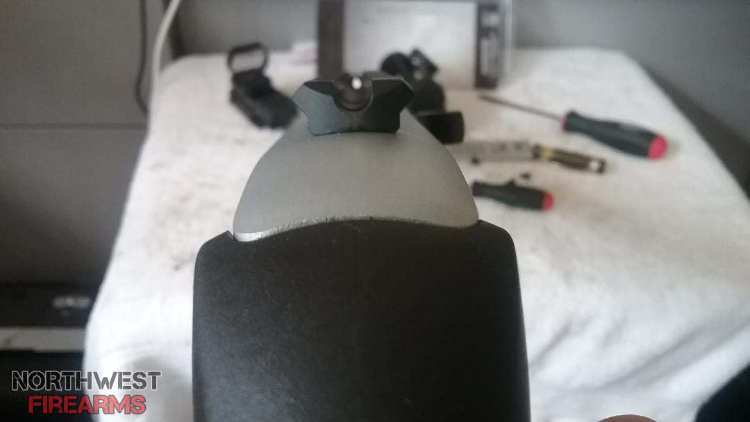

MrMillspecer and any who have a 10/22 this NC Star mount works just as advertised. Got one today from Amazon, $10. It works great. Not only does it allow full view of the iron sights it is a true 1911 rail so now my favorite quick release mount will fit the rifle too. The one I bought is black and the rifle is stainless so does not match. No bother to me. Now when Wife see's it (it's her rifle) she may kick. If so I will just bead blast the thing since I suspect it's just some kind of coating on it and it's some kind of aluminum alloy. I am going to order another one for the older 10/22 we have too.
View attachment 458510 View attachment 458511
Thanks for the info Alex. I ordered the same one and it works great. It gives a nice view of the sights and I can even see them under the red-dot. Well worth the 10 bucks spent on the 10/22. Avoid the UTG brand on these mounts if you want to use your irons. Ruger should have grooved theirs at the factory. The allen bolts are an upgrade as well.

I replaced the flash hider looking thread protector on mine with just a standard stainless one. When I was ordering the new rail I searched for 1/2 /28 thread protector and of course Amazon had several of them. So tossed one in the order that was prime. I don't think my Wife even noticed that yet. :) She surprisingly did not mind that the new rail was black. I looked at the packaging and it is as I suspected, just anodized. So if someone wants one to match the rifle better I would guess it would be simple to just sand or bead blast one. I was also surprised to find the factory rail was not a true 1913. Strange that Ruger did these like that but the fix it simple and cheap :)
