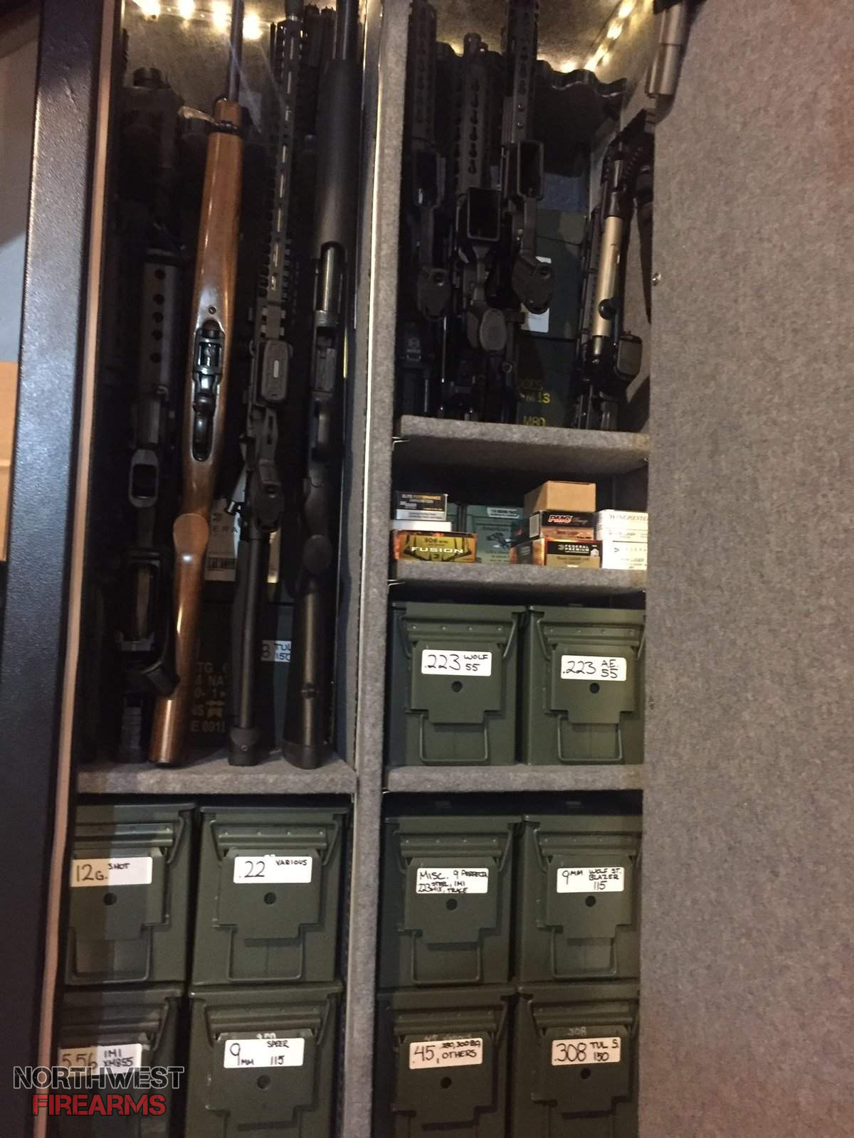

After all, one can never have too many 10/22s...
That's all relative to how full your safe is already :)
If you alternate barrel down, barrel up, you can easily fit more in there.
