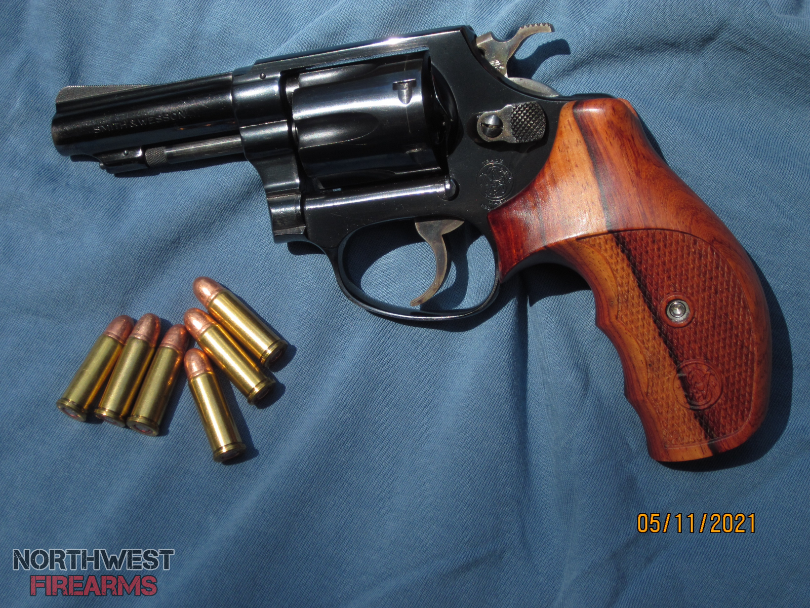

A 3" 30-1 in .32 Long I inherited from my mom. Probably 25 rounds through it. Thai stocks.
Sweet revo! .32 Long is super fun. I've loaded with success using a few fast shotgun powders, generally under 100 gr flat nosed coated lead, IIRC around 800 fps.
