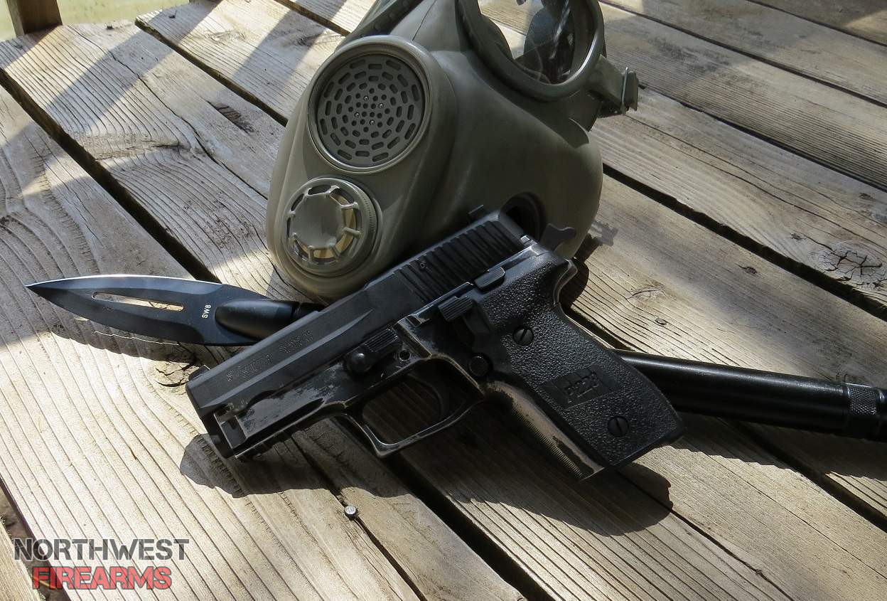

Well, I tried 2 attempts at home duracoating again and just not happy with it. Im just not going to try that anymore. so I said F it and put on some rustoleum and then took half of it off with acetone and did a Mad Max build. Damn ugly now
I'll take it back a part and have a professional coating done. at least no one will probably steel it. :D
Actually, I've already changed it. I did a light acid etch on it to try and make it look a little like pewter. The nice thing about building your own is I dont feel bad experimenting

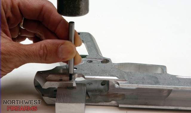

These measurements help when cutting the frame. a good caliper is helpful here
Then the sear spring pin installation instructions are on the front page of the matrix site and the new recommendations to make a small bevel in the rear rail. Get your frame coated or anodized before putting this pin in. the kit comes with an extra pin, pin driver and the block for the frame like pictured
