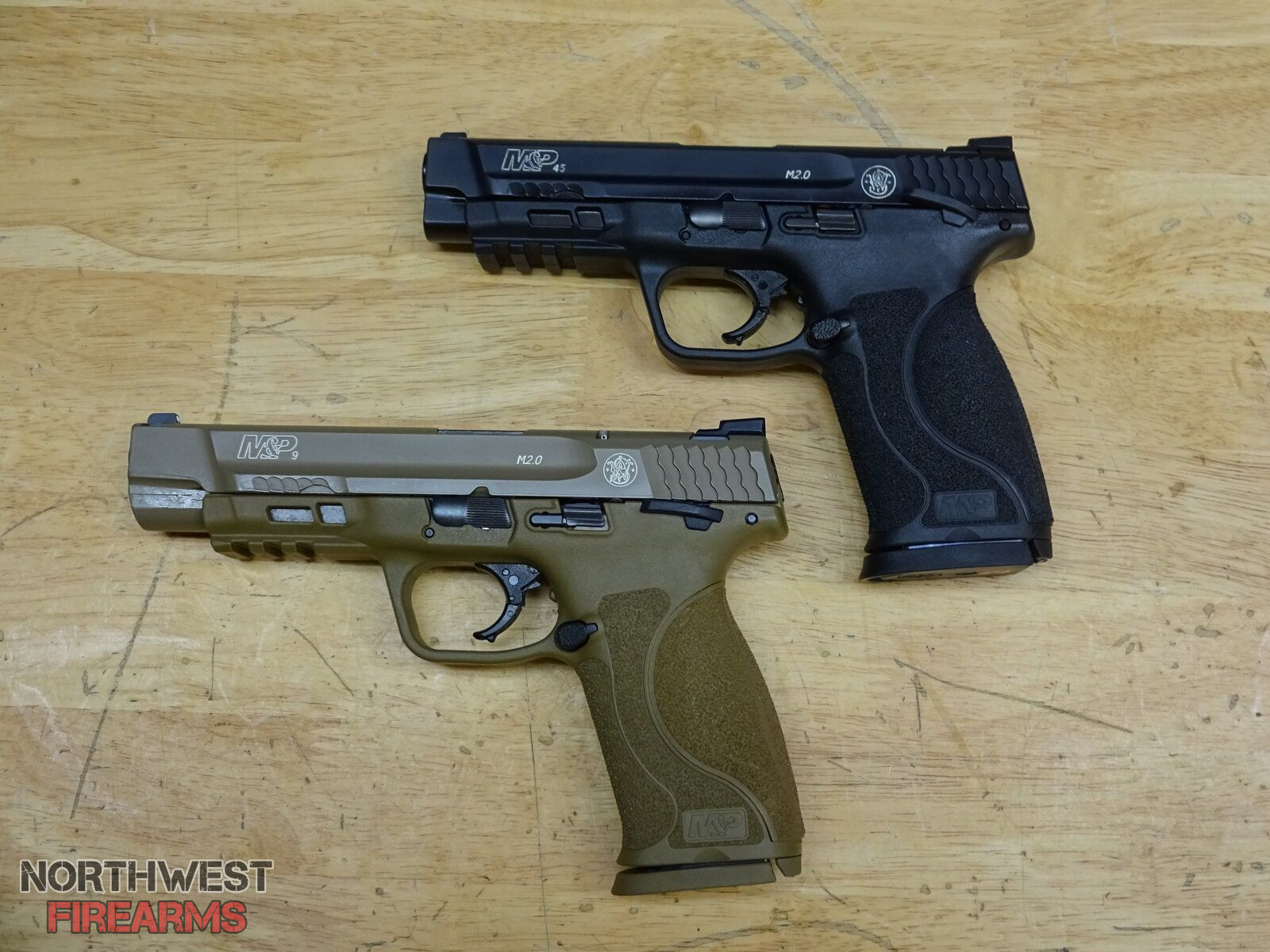

If it must be 45 and you want a safety, I would look hard at the M&P45 2.0 Compact. It has a 1911 grip angle and is available with a thumb safety. The compact is full size in frame (10 rounds 45 ACP), but has a 4 inch barrel vs the 4.6 of the full size. Using the small grip mod, its no bigger than any double stack 9mm. Even fits in the 9/40 M&P holsters. It shoots amazingly soft for a 45 that weighs 12 oz less than a steel frame 5 inch 1911.

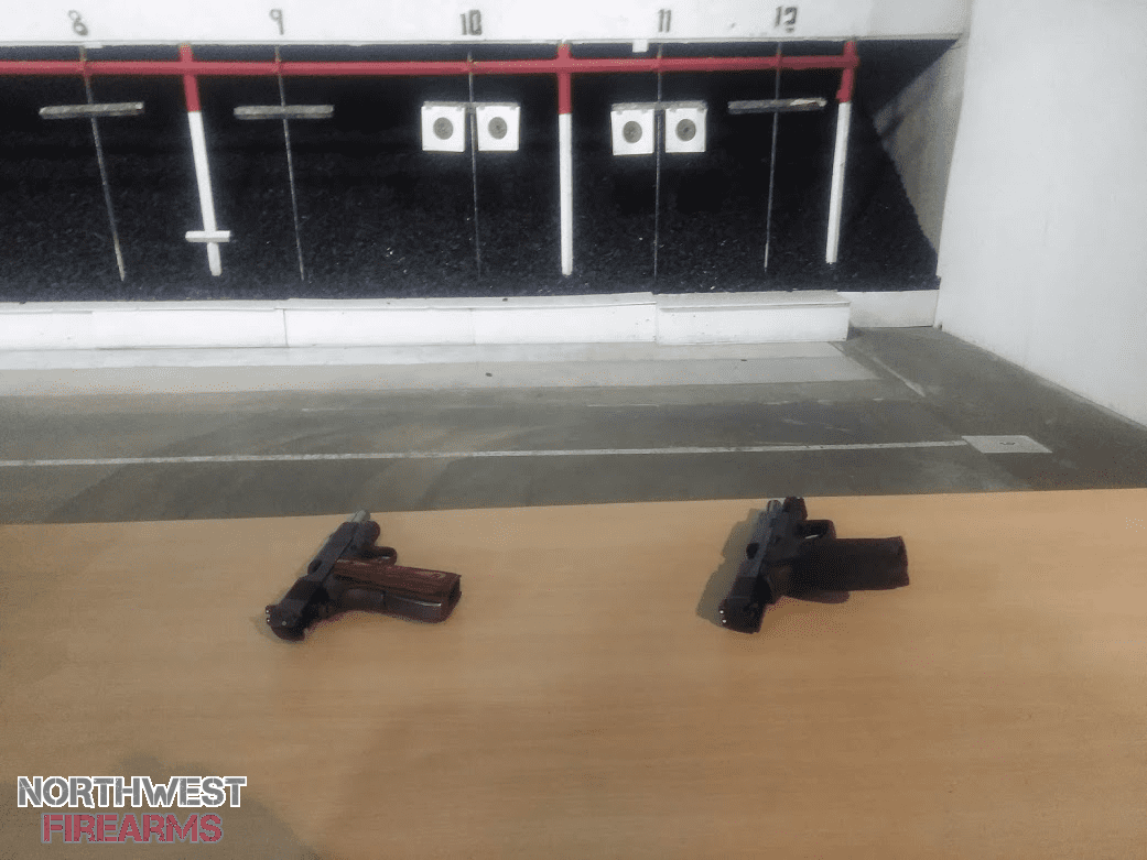

I agree with the idea of the M&P 2.0. A heavier handgun like a full size 1911 vs. a M&P 45 2.0 will recoil less?? WRONG:oops:
I shot these two 45s side by side. The M&P 45 2.0 recoils less than the full size 1911 45!:eek: The M&P is notably softer recoil.
And the M&P is as very accurate.
