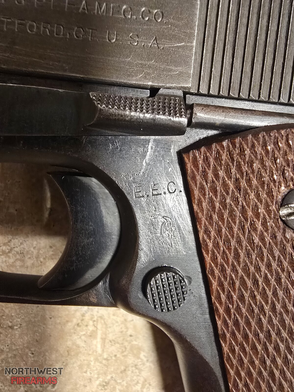

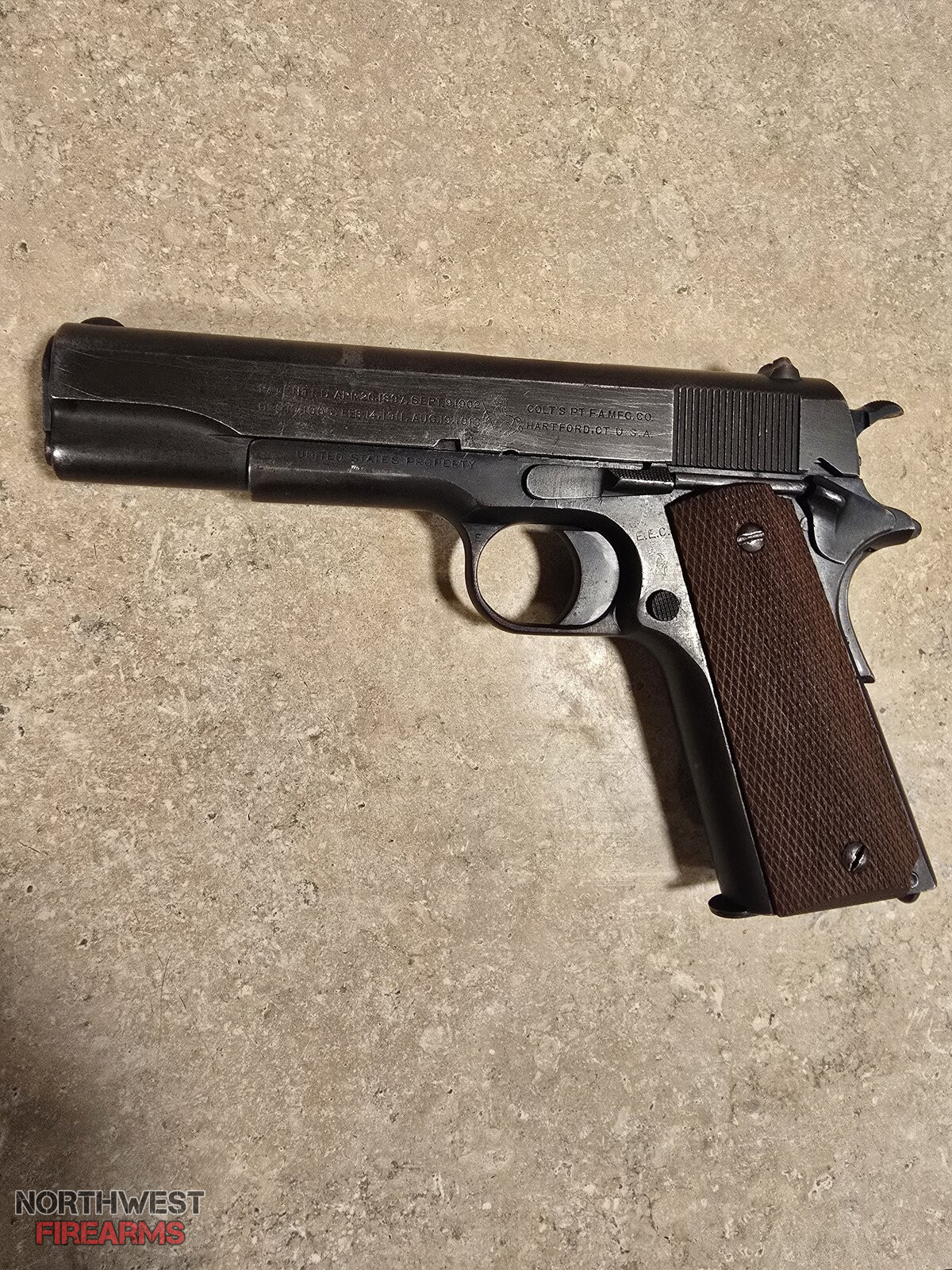

I had previously talked with @Andy54Hawken about this pistol and he answered alot of my question. Thanks you again Andy......that being said id like to see if anyone else could add any opinions and possible facts. This was purchased from a member here without knowing alot about the history of the firearm. I did have a couple "experts" look at it at the Portland gunshow. I received 2 totally different opinions. I guess my biggest question is was the restamped serial number done by the US government or a private party?

I think it is a arsenal re-work.
The 1911 and 1911A1 served for a long time.
I carried and used a Remington Rand 1911A1 , made in 1944 , during Desert Shield / Desert Storm.
No new 1911A1 's after 1945...all issued pistols were from that date and earlier.
So you will see many , if not most , issued 1911's and 1911A1's with many interesting features / parts / finishes /etc....
The military did not and does not care for future collectors...they just want the firearm to work.

I sported a Remie-Rand, too. I also concur with the arsenal re-work conclusion.
That X number range was assigned to Springfield Armory from 1925 - 1953 for rebuilds.
After 1930 there would be initials after the number of the armory that performed the work.

Amazing.... your 1911A1 spent over 33 years of its existence "out of service" stored in a rack or "massaged" on a workbench before you got it!
So far 1911 addicts isn't panning out. Ive been told its a bubby job and its illegal to redo serial numbers. We will see what other responses I get, could be interesting
Oh, geeze...
I've seen arsenal reworks with serial number restamps like that. Nothing I would worry about.
