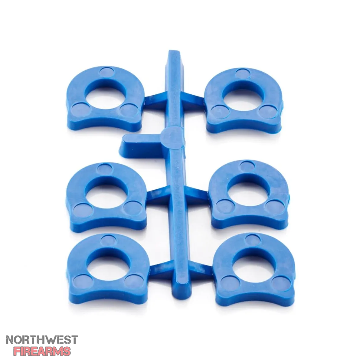

I use a Wilson shock buff on all my 1911s. I have been running them since I got into 1911s +40 years. ago.
Protects the frame. Anyone else use these??
This is a rabbit hole I actually went down recently when trying to figure out what springs I should put in my Colt Commander. Seems like most 1911s these days come with 16 lb springs. Curious if Wilson Combats 18 and 20 lb kit is too stiff and would cause malfs. But I'm trying to prevent the alloy frame from getting battered while practicing with defensive loads. On that subject has anyone tried the WilsonCombat shock buffer kit? Are they legit or just a gimmick?
I tried some ed Browne shock buffs and the 1911 that they were in chewed them to bits and the gun malfunctioned. I don't use them any more.
Of course. They make them out of frangible material so you have to keep buying them.
I make mine out of dense black rubber plumbing gaskets. I don't know the material specifically but they don't fall apart.

I tried the Shok-Buff (note they are only rated to 1,000 rounds), and one came apart, so these are no-gos for me.
