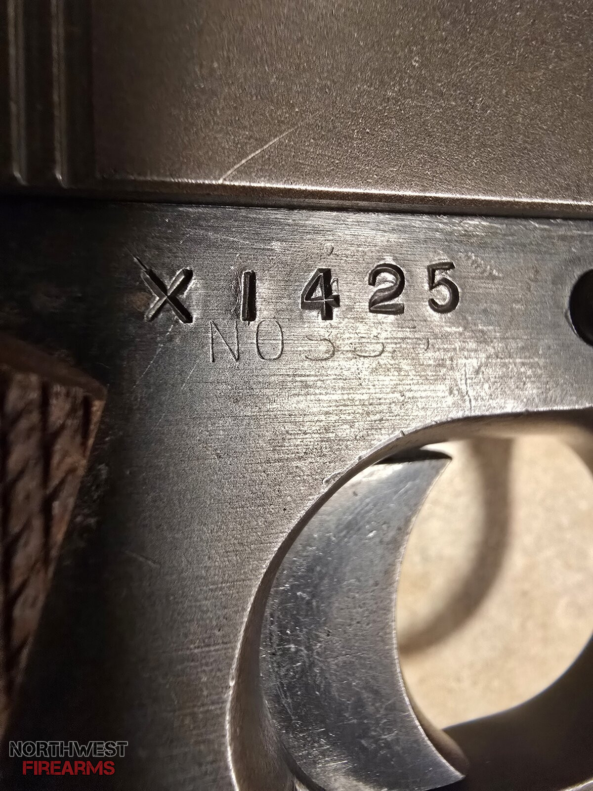

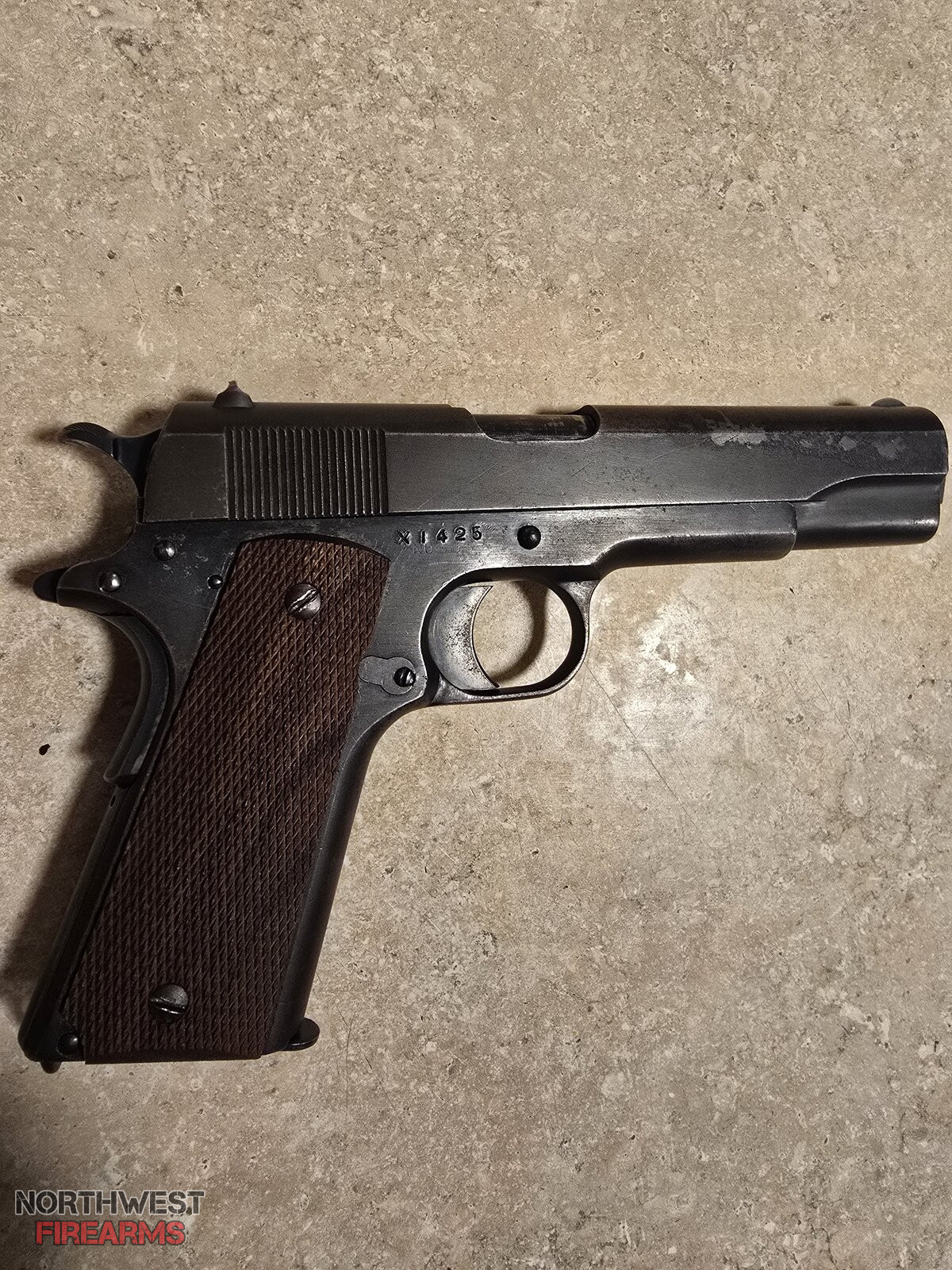

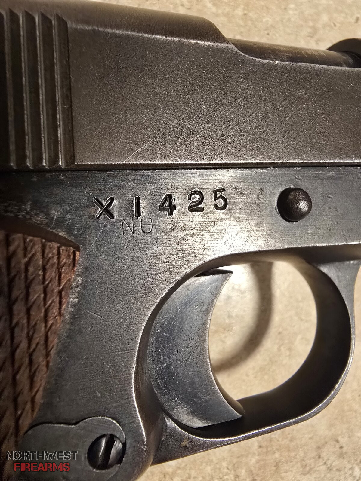

The NO of the serial number appears correct for Remington UMC frame.
Looks like 88 but can't pick out the last digit.
There are processes that can used to bring out the numbers.
As with stamping, the indent impresses deep into the steel a few thousands below the surface, thus disturbing the grain enough to pick out digits even though the surface may be smooth.

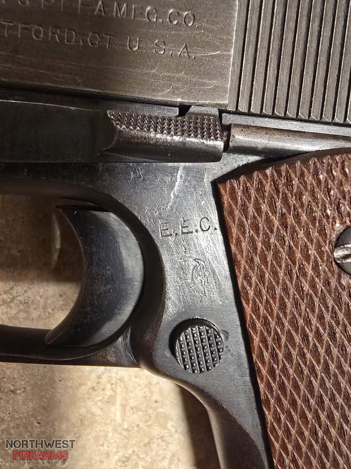

Bottom of main spring housing should have a E
Checkering on the hammer from rear (towards shooter) to front should cover about 3/4 of the spur...and can be either fine or course checkered

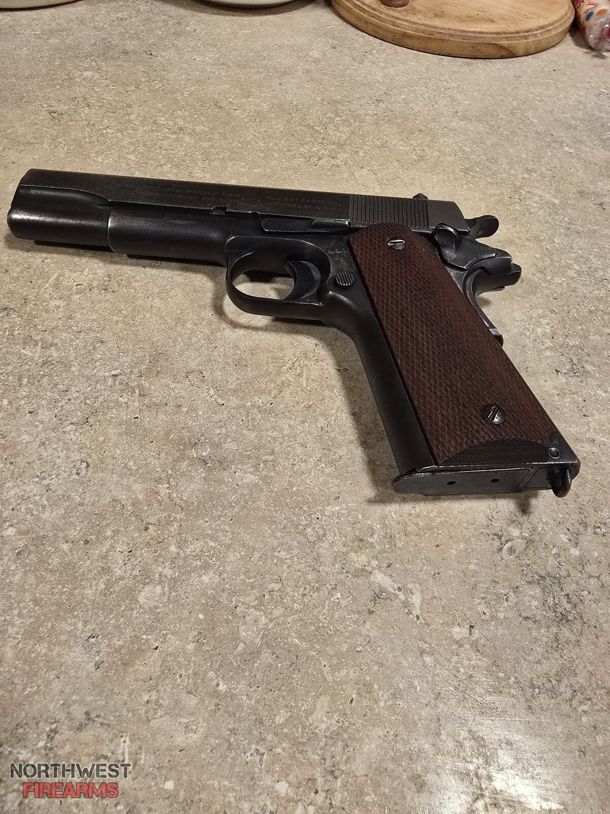

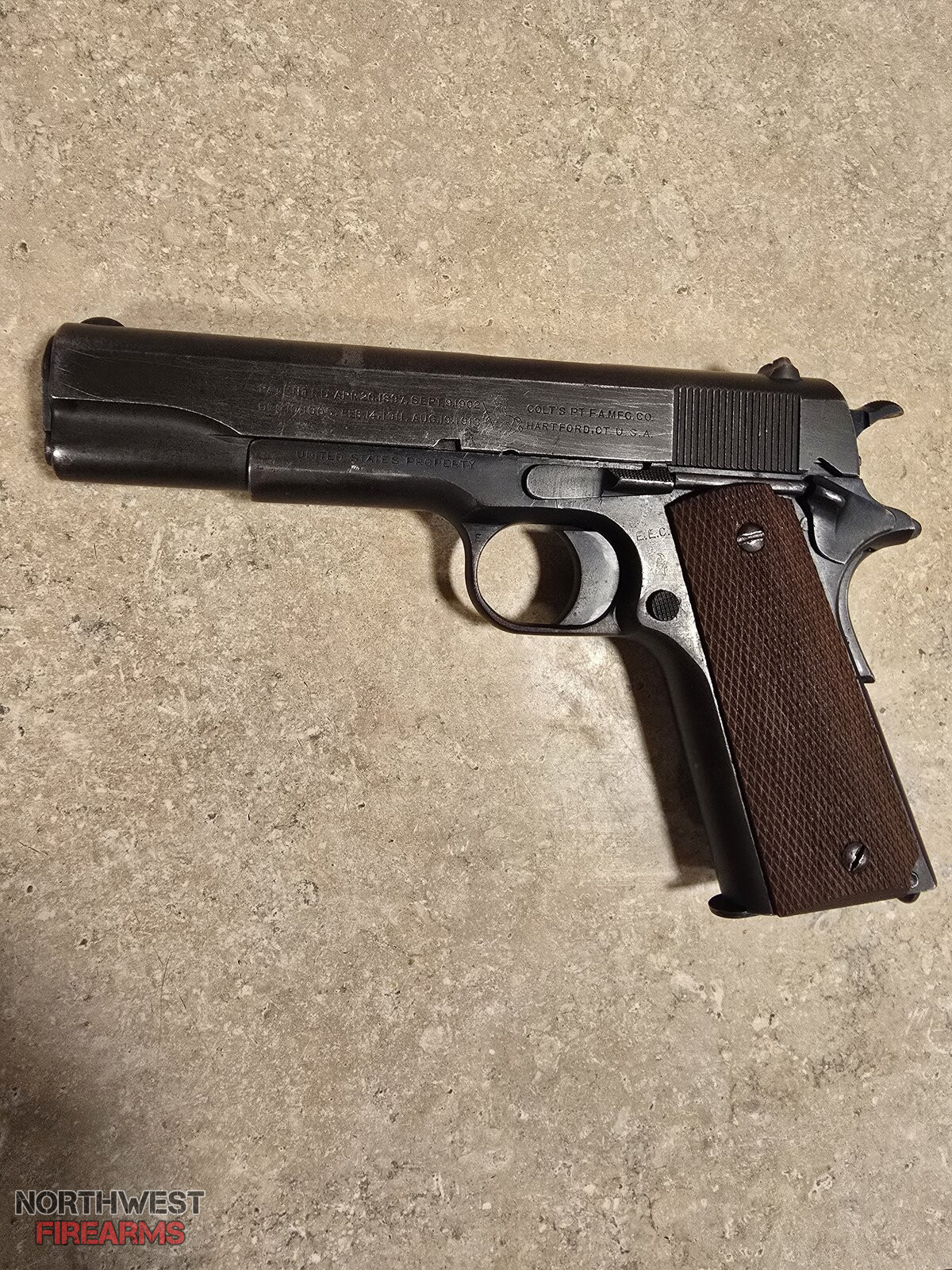

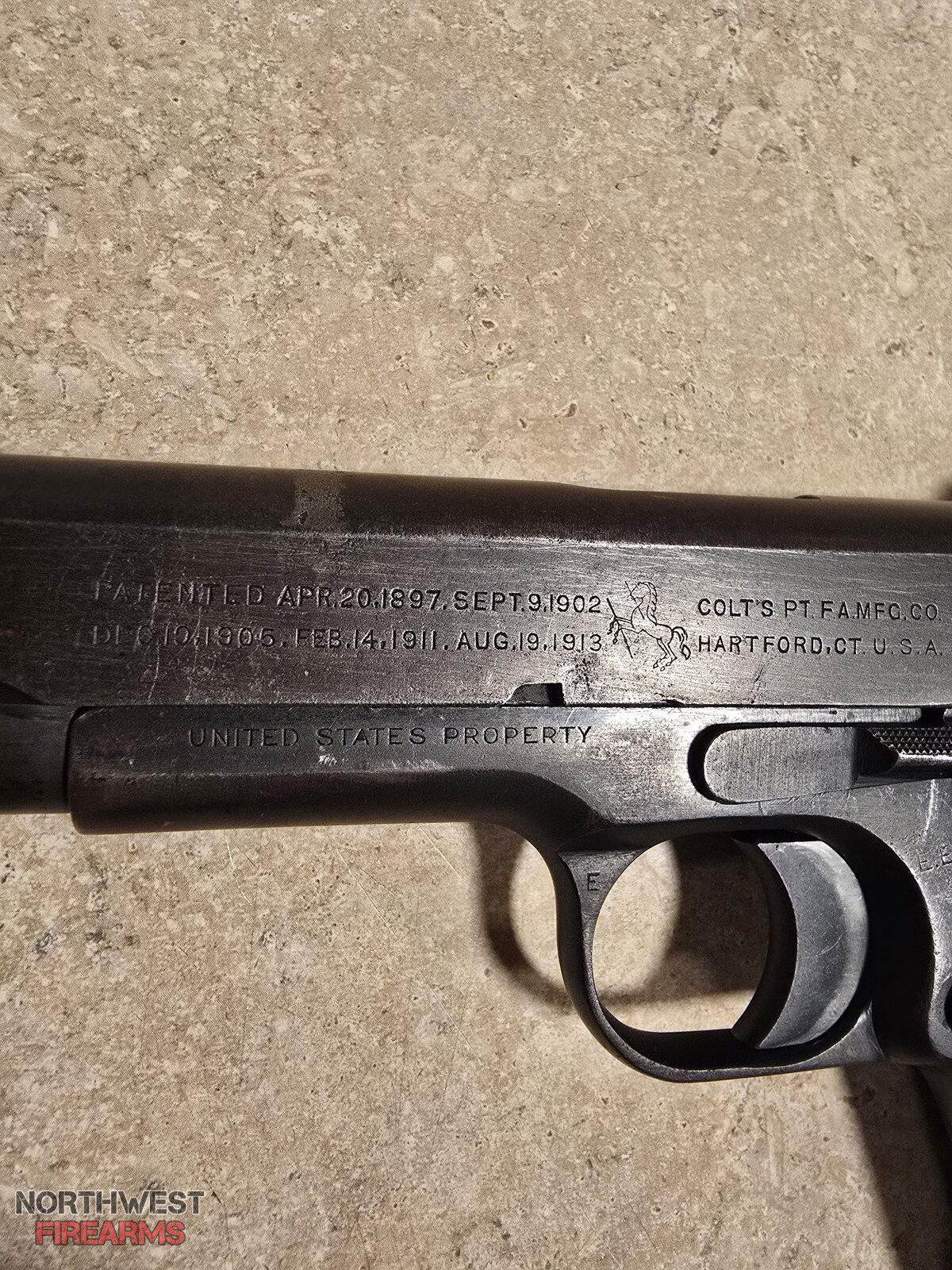

I had previously talked with @Andy54Hawken about this pistol and he answered alot of my question. Thanks you again Andy......that being said id like to see if anyone else could add any opinions and possible facts. This was purchased from a member here without knowing alot about the history of the firearm. I did have a couple "experts" look at it at the Portland gunshow. I received 2 totally different opinions. I guess my biggest question is was the restamped serial number done by the US government or a private party?

Any input helps

I wouldn't worry about any legal issues pertaining to this gun. At least not federal ones.
The renumbered pieces of the US military, I always wonder what causes this to happen. Were there legal reasons? It seems like I've read somewhere that stolen weapons were sometimes renumbered to avoid confusion with reporting paperwork previously filed. Or technical reasons? Such as a top end so far gone that they just started over again with a bare frame. And if so, what would be the problem with using the existing serial number?
The Colt slide has the older markings on it. But this design was used for a long time. In this case, it looks like it's been mated to that frame for a long time, the finish appears to be consistent from one part to another.

Over the years, I've seen WW1 era 1911's and Model 1917 revolvers with serial numbers and United States Property markings obscured or obliterated. Even though these guns were sold as surplus via the DCM between the wars, knowledge of that process probably wasn't widely known at the time. Which probably resulted in a certain amount of paranoia about ownership issues down the line.
Do a FOIA request.

Just something to consider with re-arsenal / re-worked US military firearms....
Very often it is a case of "Parts is parts".
The military wants a serviceable firearm...and did care to make sure it was all "parts correct" after servicing.
Collectors obsess over parts and the like...
Which is a waste of time , in my opinion with re-worked / re-arsenal firearms.
A part needed to be replaced....the arsenal found a replacement...the firearm works....that is all that mattered.
I would say that...The pistol in the OP ...is indeed "parts correct"....*
It has been re-worked and GI issue parts were used....therefore it is "parts correct"...
For a re-worked GI firearm.
To say otherwise , takes away the history of this particular firearm.

Yes! From what I have read the remington umc frames where known for being very poor when it came to compatability with other parts. I seen a number somewhere that 5 out of 20 would even function when new off the factory line. Thus making them more scarce in the wild especially as a rework. Seems most where tossed when they got to that point. Im definitely not a collector so it makes no difference to me as long as it works. I just like knowing the history

Yes, couldn't be more correct. When the pistol reaches an arsenal for a rebuild, they use what they have on hand that will put the pistol back in service asap.
It is obvious that something was off with the original upper, thus the Colt replacement.
Collectors weren't much in demand, and even so like @Andy54Hawken stated...they are still parts correct for what was done. Still a solid piece of history.

So you have a very rare unique pistol and you have discovered a lot about it so far I can add this :
Sadly yes that's is a real deal
The U.S. government needed a way to re-serial number damaged or defaced frames it looks like Springfield Armory was assigned serial number block X1,181 through X4,385 (these were used starting in 1925 and ended in 1953 ) The frame in question is a Rare Remington UMC frame that was built in 1918 -1919 only 21,676 UMC pistols were made the second rarest pistol made and accepted by the American government With Singer being 1st place.
Hence the word "Sadly"

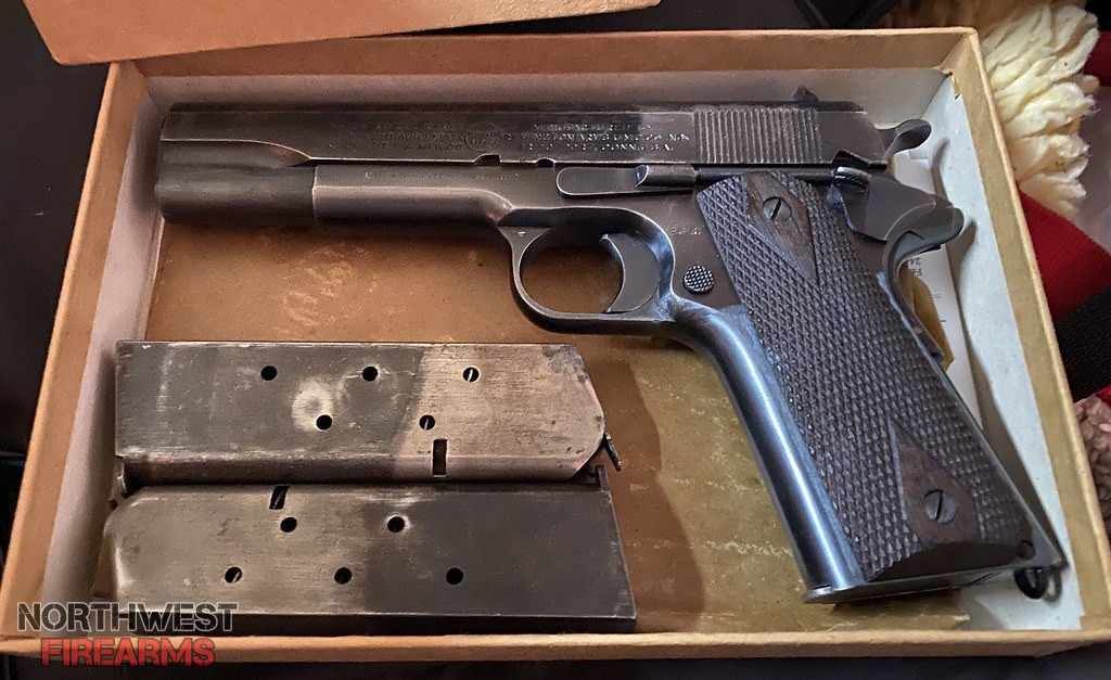

52274592882_0a45b6b086_b.jpg ABDA1D4B-603A-4BA5-8A3B-4E774D454974 by Jeff Lee, on Flickr
As far as the old 1911's I am not a expert but I have a few books to help😉
51704944844_3c31669dea_b.jpg 2787B232-CD45-4061-96CC-5AF84CA1DE11 by Jeff Lee, on Flickr
Can you tell if has original stocks?
No those were not made until 1924 (when they came out with the 1911a1 model ). if they are Colt stocks I would have to see the back to verify it .
Here is a set of full checked stocks on a 1939 Colt Navy
54204655156_ba4143f73d_b.jpg 46C1585C-B0CA-40A1-B17B-FE3615AC5D47 by Jeff Lee, on Flickr
54205077260_a4310b4f4a_b.jpg CF87A42F-B9E3-4BCB-8C1B-85044D684B14 by Jeff Lee, on Flickr
