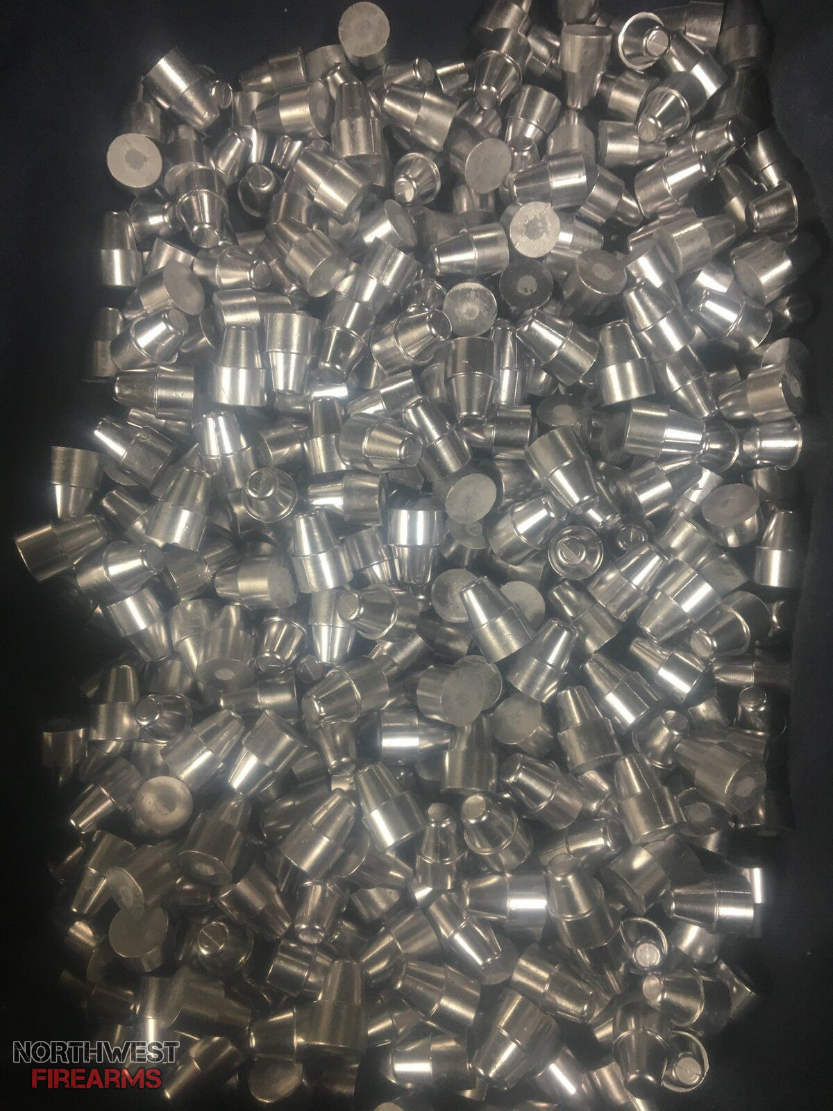

Bullet manufacturer?I worked up a load that shot well and revisited the press to load another 200.
These 220g bullets are a little top heavy but clock in at 1020fps and group well.
