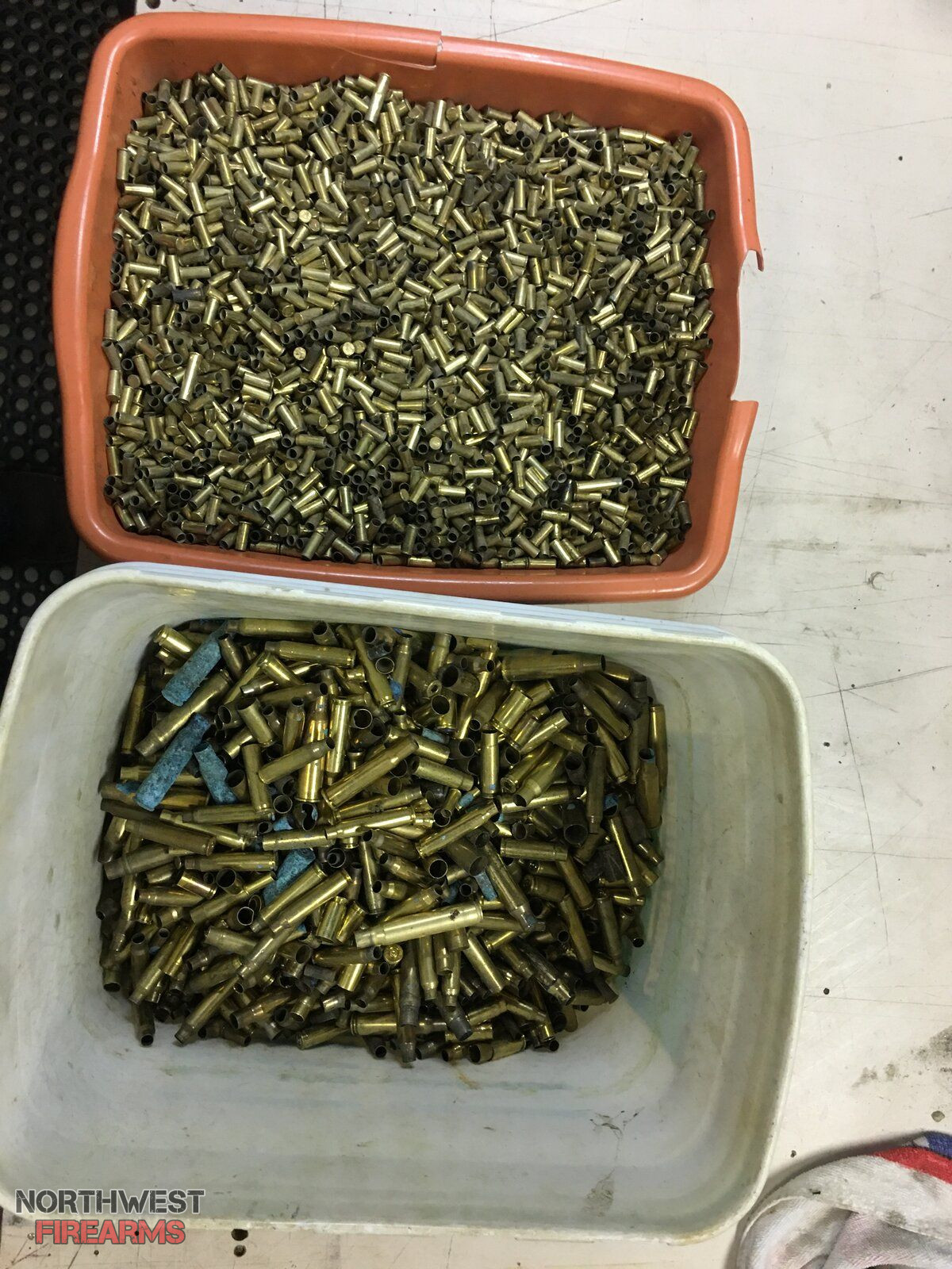

Oh and just show you that I am taking it easy after tweaking my back this weekend. I went through my brass recycling bucket, yeah pretty sad right and I have 15.7 pounds of 22 Long rifle cases.
67D9DDA9-25A0-4A3D-BDE8-04CEC108C05B.jpeg To tell you the truth there hasn't been that much brass left for me to pick up at my pit because of brass whores that are invading it. I've already ran two off.:mad:
