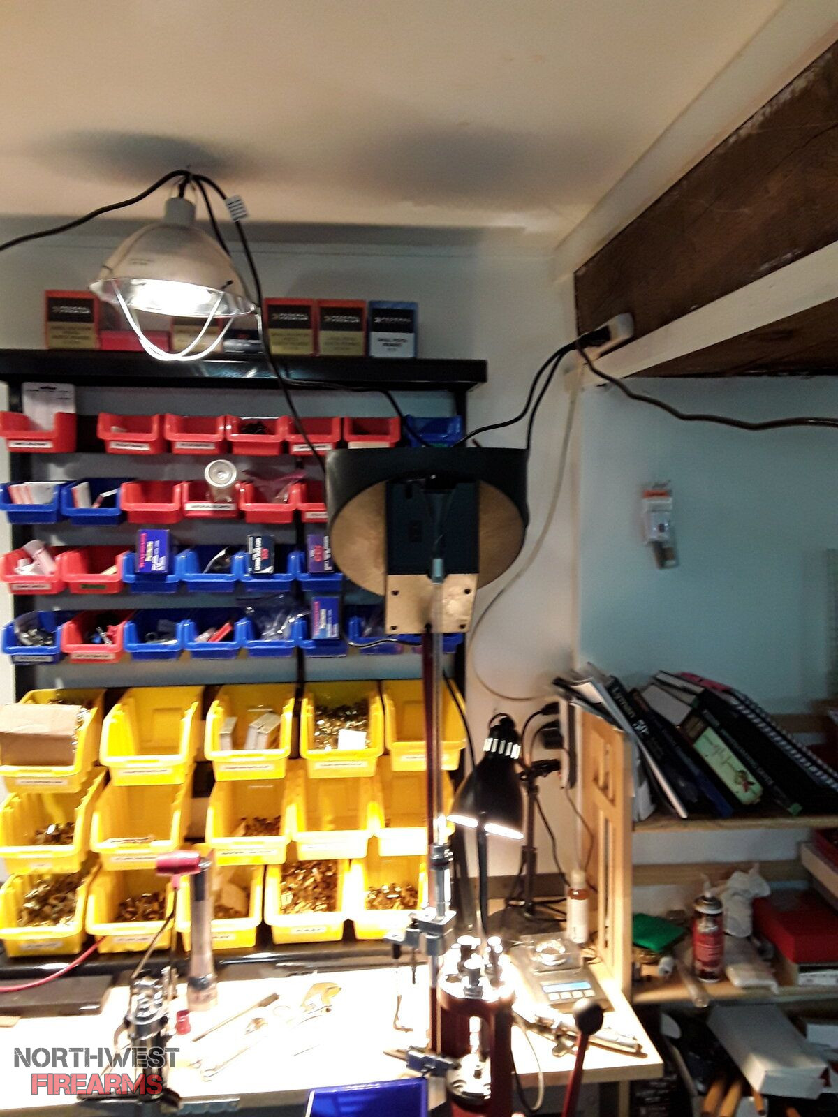

@Whisky Tahoe , wow... didn't know that machine existed. Pretty nice, and not as expensive as I expected.
I talked myself into needing it last year when I was reloading my 338-378 Weatherby cases and noticing the necks were separating on half the cases after one or two reloads. That brass runs ~ $5 each!
Now if I was honest, I would have realized I'm never going to survive shooting enough 338-378 to recover my cost. Fortunately the real value is with competition quality brass prep.
AMP has great research that supports annealing in general regardless of which method is being used.
Check it out! Brass Annealing Machine | Home | Annealing Made Perfect (located under research)
No arguments against annealing from me. Neck tension seems to be a critical factor in making consistent and accurate ammunition.
The only ones I had seen previously involved a sort of stand and holder, kind of a lot of money to do it by hand, it seemed to me. Having a way to make it precise and repeatable seems worth a little more.
Welp, time for me to quit yakking, and get to reloading, got a big box of handmade poly coat bullets, waiting for temporary housing.

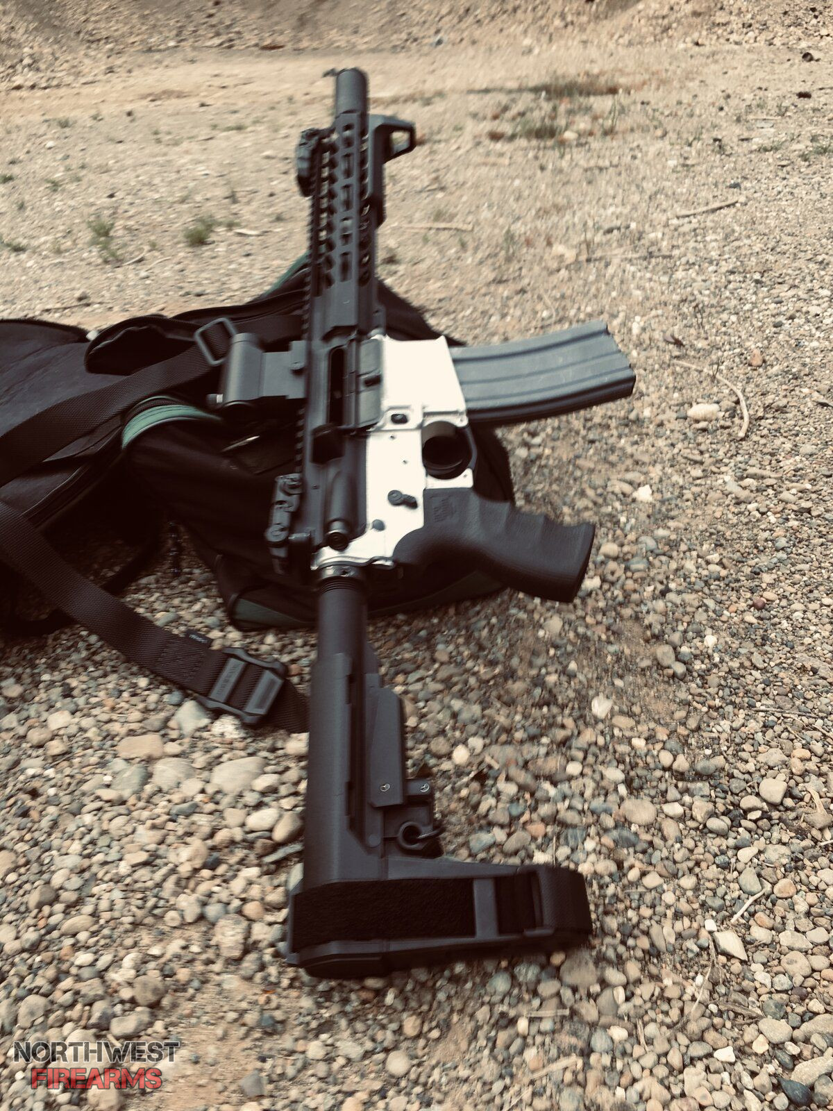

my home built 300.
The .300 BLK appears to have some real accuracy potential and a fun round to experiment with.

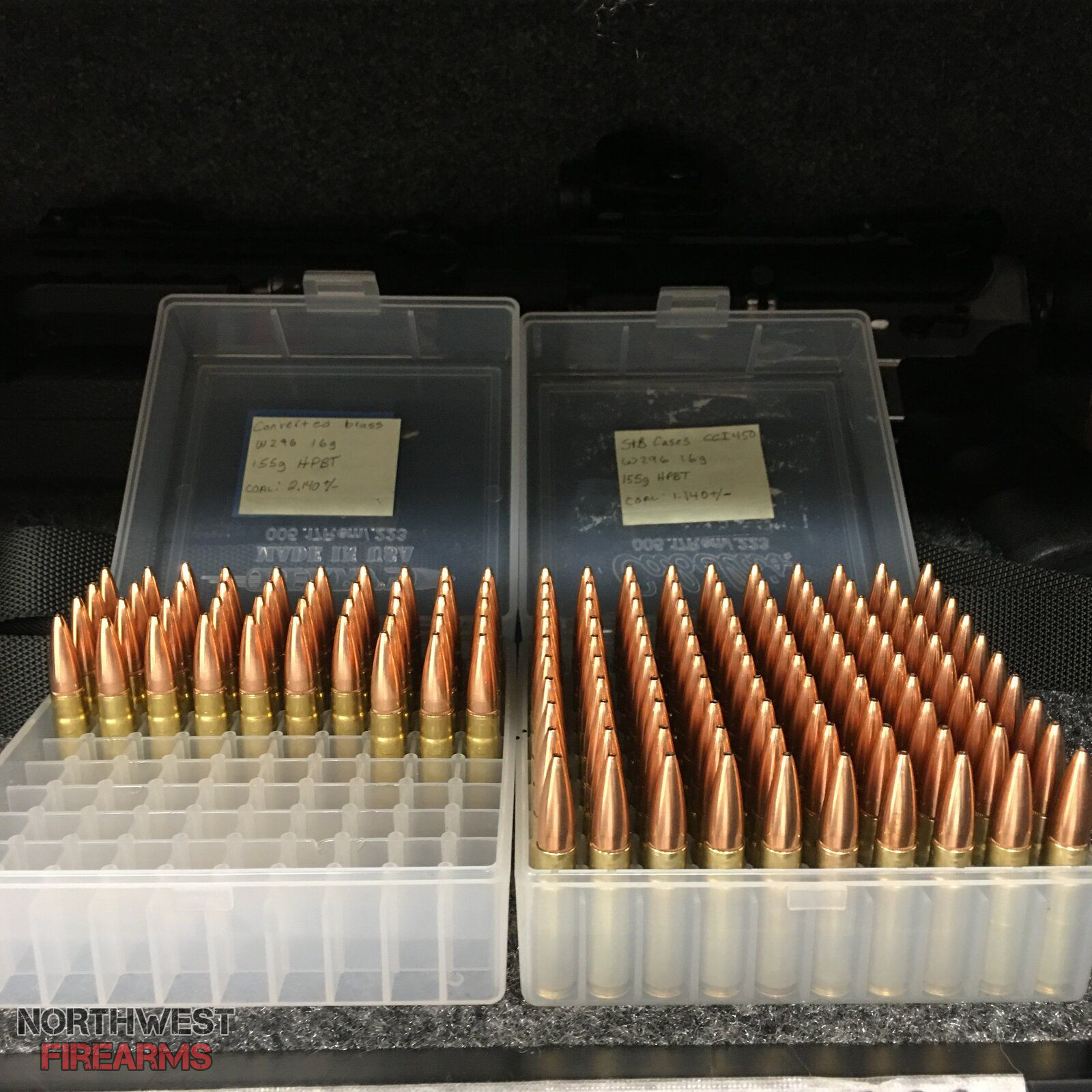

After a successful load ladder test I loaded 193 300BLK with 16g of W296 with 155 HPBT pills. I loaded two magazines with 25 in each that's not in the pic.;)

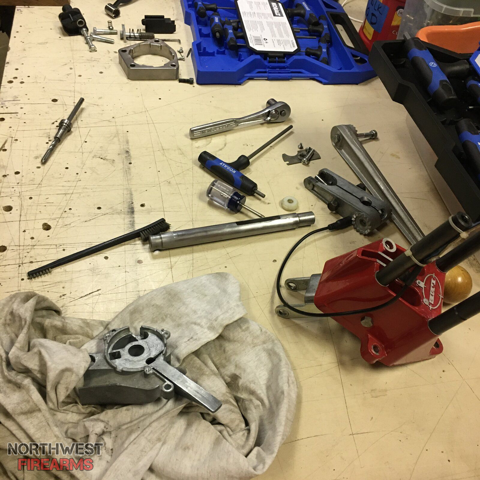

During this loading session my Lee Pro1000 went titts up so I switched dies to the 4 hole Turret. :(
