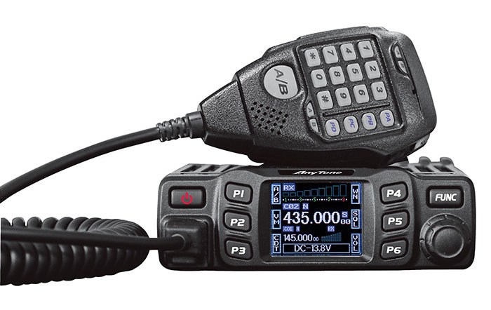

I cannot stress enough how good this setup is especially for a entry level class. First of all, the Laird Antenna is probably the best mobile antenna that I used on the GMRS. I can easily get hook up from Sherwood homebase to Enchanted Forest (Turner) very clear without any special gadget or repeater. My other Antenna couldn't even go 1/3 of that. The features and ease standard use of the radio is beyond novice. I couldn't believe I'm getting all these hi-performance equipment for $200. By 37 years ago I think I spent $600.00 just for a CB radio and antenna setup on my mobile which this new GMRS out performs it. This is a good setup for your SHTF communication. Never the less I still have a CB radio setup as backup for such frequency and radio can be your last communication option and cannot just be scrambled especially in the time of emergency.
