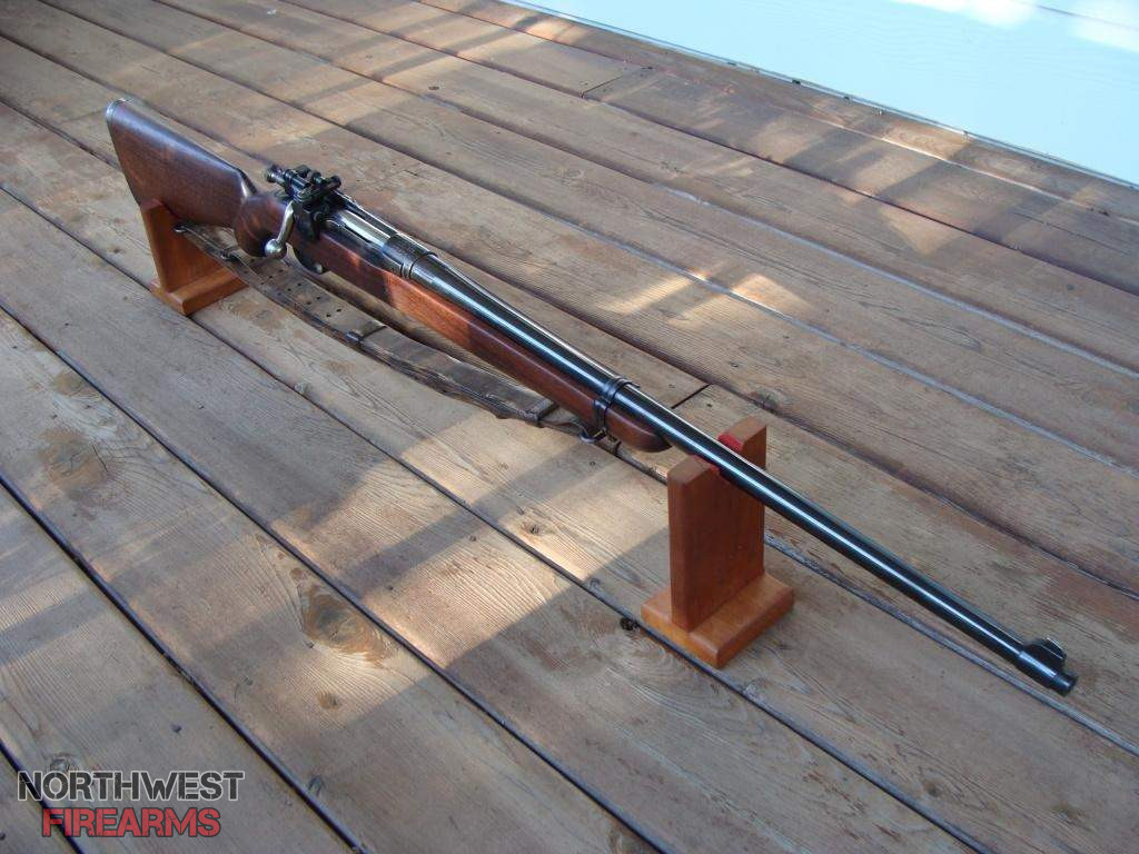

DSC04471-1.jpg I have been thinking of restoring this one but.........it looks sweet, and shoots even sweeter! May just have to leave it alone and find a good un messed with one to enjoy! That and my oldest has all ready claimed it when I'm gone!

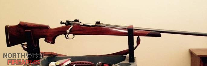

There is a Commercial Mauser down there with a mid 50's Swarovski scope on it I have been drooling over for some time. .375 H&H mag. They want a lot for it, but I figure I can keep weedeling them down until I can get it for a good price! $2500 is a bit to rich for me!
My father in law was given a whitworth Mauser a few years ago in .375 H&H. I will likely have to build one eventually, but it will likely be on an Enfield. I already have the stock, just have to find the action and barrel, sights, scope mount, etc. etc.
