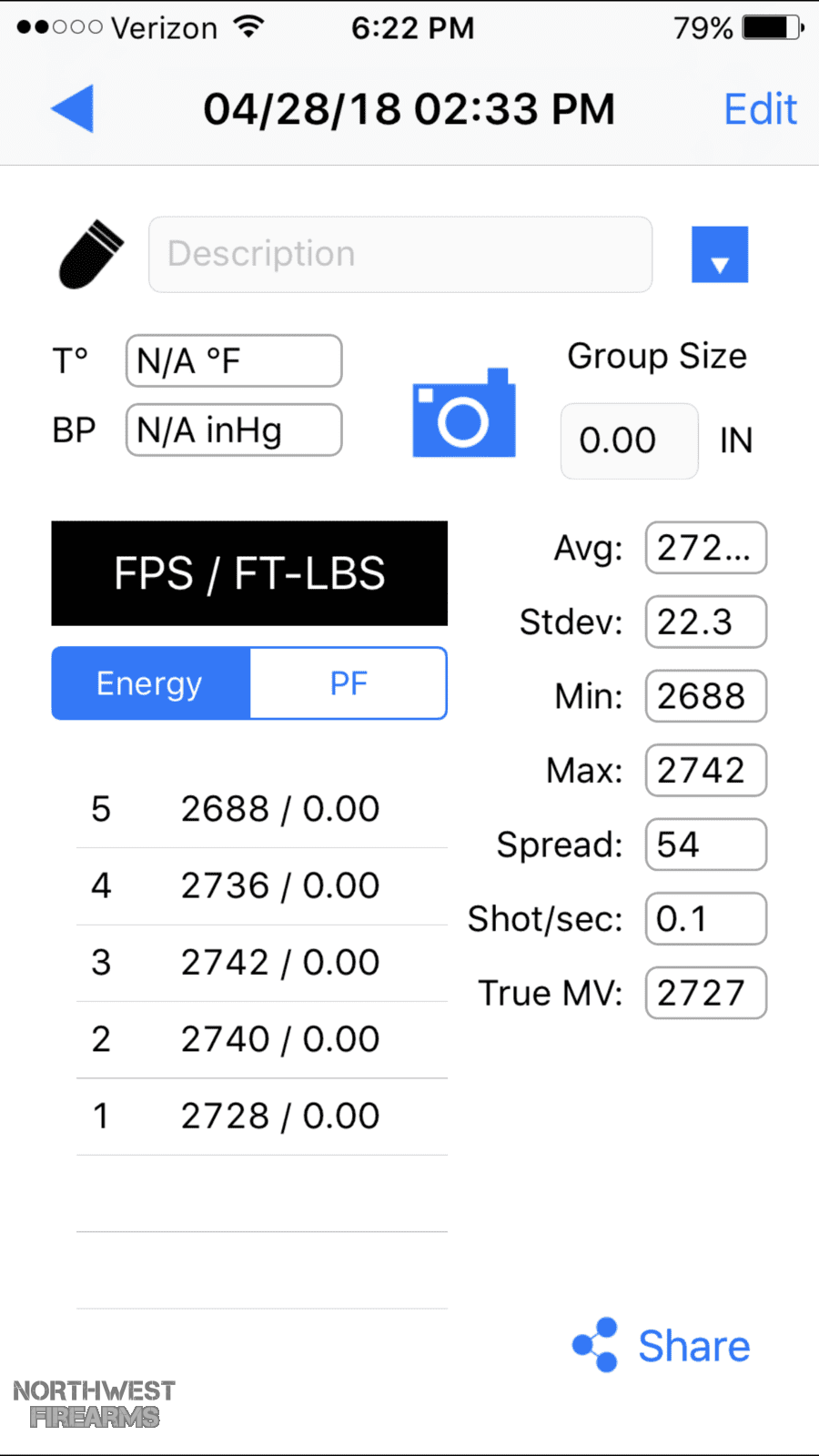

IMG_7397.PNG How to lower my sd into single digits? I double check my powder and still have a sd of 22, spread 54 (5 shots). If not single digits at least a lower double number.
Interesting that if you take the 5th shot in the string out your sd falls to 6. If that was a 10 shot string and that 5th shot was still the only oddball your sd would be much lower than 22. I like larger shot strings for analysis. 5 shots is a little skimpy on data. The things @Goosebrown listed above are all good things to try, weighing your projectiles and brass being the easiest thing to try first;).

Looking at my brass, all were lc but 1. And wouldn't you know it was the one that shot 2688:confused:

223, 77gr nosler cc pills, cci 400 primers, imr 8208 powder, basic hornady dies, and yes barrel break in.
Would love to try a different powder but I have close to 16lbs of it so it will have to do. I will be switching over to starline brass after a couple more firings.

-Curious though if this was done from a cold barrel? ...and from the more experienced folks, if it was cold, could that have something to do with the #1 velocity?
That's a great question. If cold, rerunning the test correcting the "wrong" case and after a few "fouling shots", there might be a single digit SD already.
