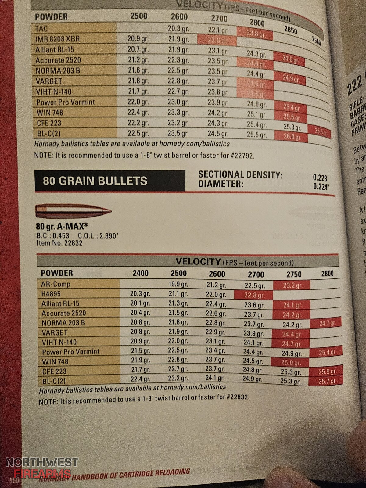

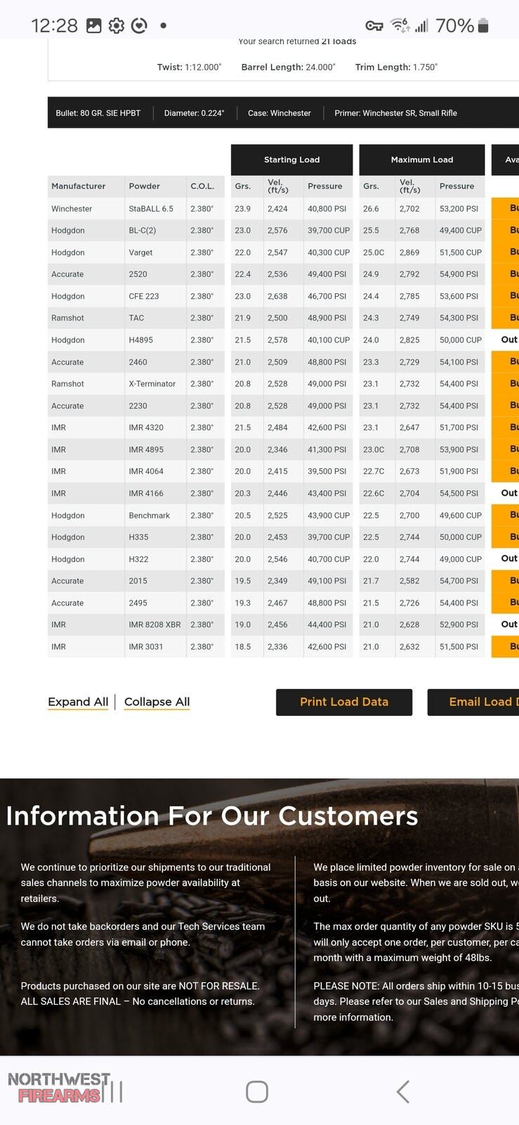

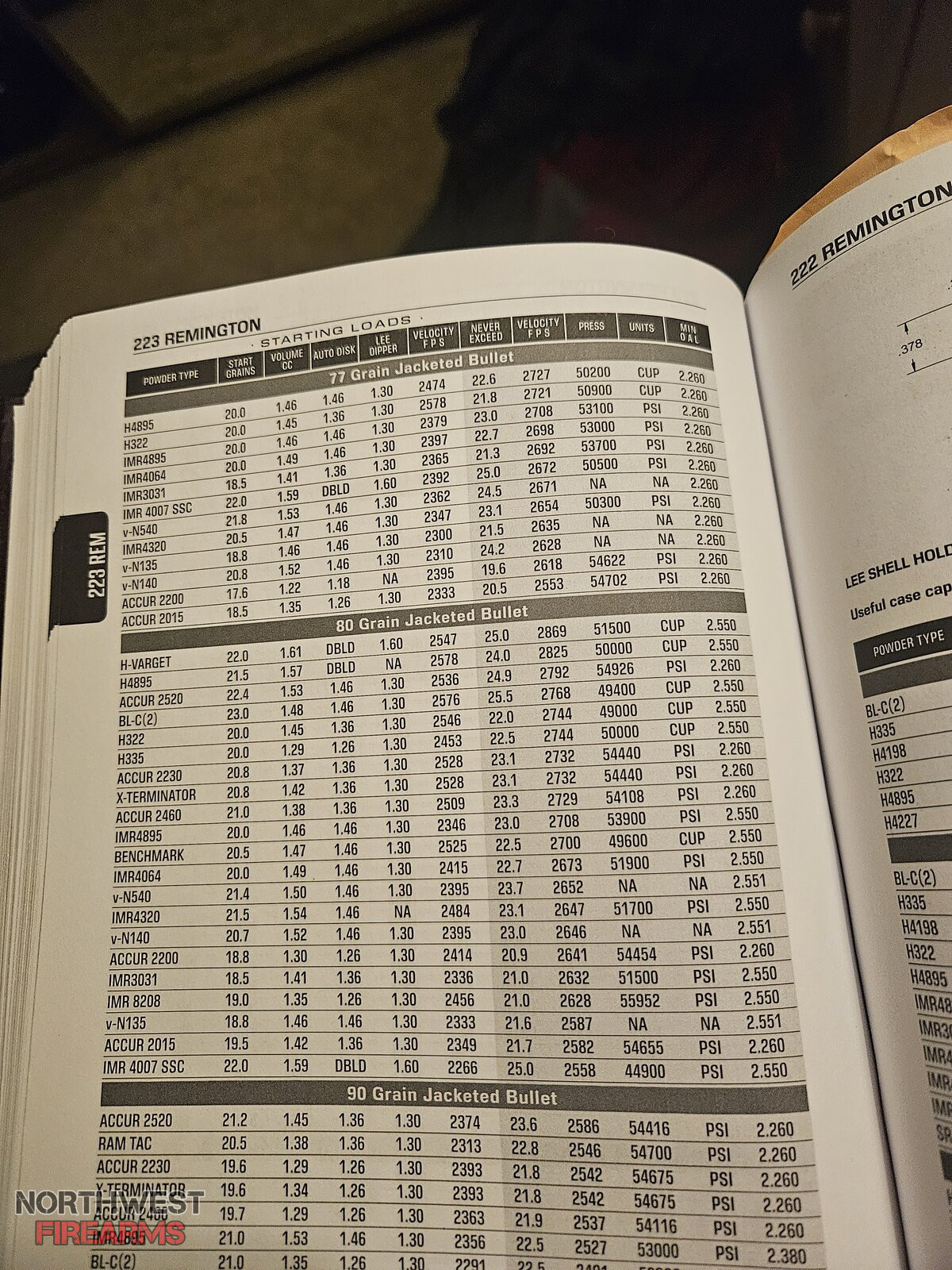

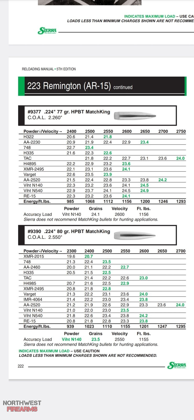

I found all of that data but it's all for 20-24" barrels with a 1:12 or lower twist.
Looking for under 20" barrel with 1:7 to 1:9 twist rate.
You may have to improvise. I can't imagine how many pages the load books would be if they had to develope different data for each barrel length and twist rate available in all calibers. My understanding is the load data is just a guideline and you have to tweak it to fit your individual firearm and component selection.
Top left has a selection for pistol data (typically 15" for rifles). Just looked, 70 gr is the heaviest pistol load they have
Yeah I found similar info to that, not sure why they chose 20" and 24" for an AR-15 given most are 16-18".
Because almost all people loading 80's are shooting mid range (600 yards) or longer and use that extra barrel length for velocity. They are also loading them longer than mag length. Look at the OAL of the load data posted, most of it is much longer than mag length of an AR.

I just looked on the Hodgon site sub sonic data and they have loads for the 77gr bullet yes in a 24" barrel so maybe not the end all be all for you but it might be a starting point for load development. If a load is sub sonic in a 24" barrel it should be even slower in a 20" or less.
