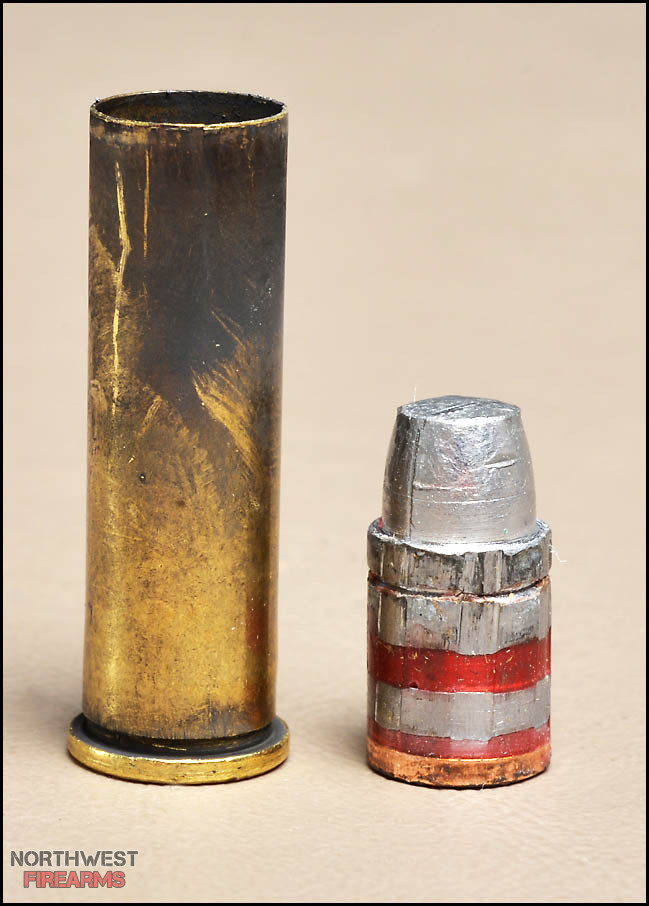

Oh yeah, ran a across this a while back:
Brand new brass in the factory bag.
It wouldn't have caused a squib, only a dud.
But i keep it in my drawer of reloading mistakes.
