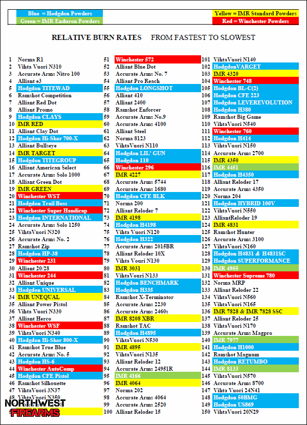

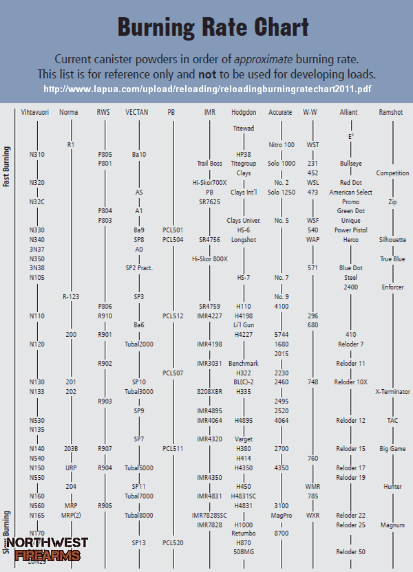

Burn rate chart is the most common predictor

As stated above, I believe that the Burn Rate Charts would be your best source. I have never taken a match to say #1 on the chart and then to #159, but with a quick stop watch trigger (might need Jerry M for this) and a consistent flame source you could figure it out. An interesting test setup might be the use of a Flintlock "lock" as the ignition source.

Using something else or using less conventional primer choices, could be some of the reasons, somebody might be concerned about how difficult a particular powder or type of powder is to light. We know black powder ignites very easily, smokeless powders not so easily. Some smokeless powders may need more pressure than others to ignite well. I am familiar with burn rate charts but did not assume that they also predicted the energy, pressure, etc needed to ignite them.
