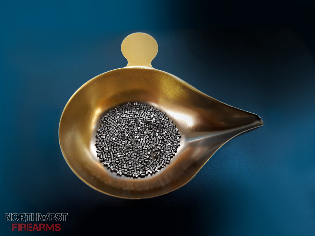

I have not received it yet, should be today. I'll pour some on a pan like that one for close scrutiny.Have you received your MP 540 powder yet? If you decide to break the seal after arrival can you post a close up pic of the powder kernels? The best pic of the N540 I could find was on the vv website.
Thanks for posting those pics, look forward to your ladder test results and welcome to the forum.Powder is a darker black color, with kernels of powder measuring approx 2.20mm long by .90mm wide. Doesn't fit with vv n540s dimensions. Pictures of the powder

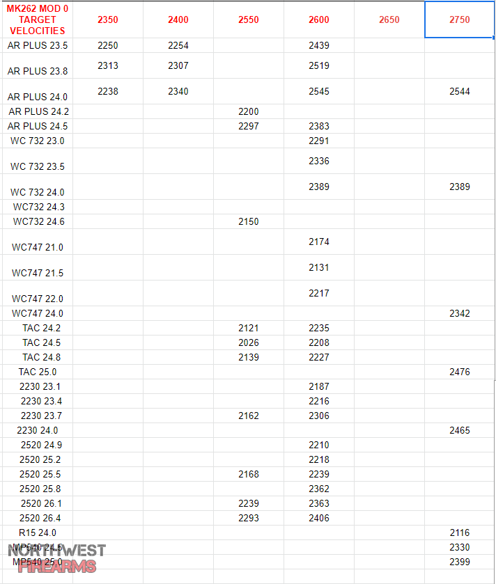

Thanks for sharing! How was your accuracy? I'd also be interested in a follow up in 6-7 months once its warmed up a bit!Alright gents. After and eventful end of the year, I've finally got some good data. I decided to load WAY past published max for 77gr but not much higher than the max for 75gr
almost all of my loads passed the 2750fps mark. But since this is pertaining to MP540;
26.0gr yielded a 5 shot average of 2763 out of a 20" 1:9 barrel.
Recoil wasn't stout and the pressure signs were limited to some light ejector swipes, primers looked absolutely fine.
25.8 might be better for shooting when its NOT 20* and snowing.
The WC747 and WC732 that American Reloading often stocks both also gave good velocities.
WC747 @ 25.0gr - 2682
WC732 @ 25.5gr- 2782
Your mileage and safety may vary. I wouldn't hesitate to shoot any of these or the other loads i tested today.
25gr of Shooter's world AR PLUS got me 2899fps!!!!! No serious issues though- beyond some obvious ejector swipes.
Unfortunately I only shot five round strings for velocity. Shooting for accuracy maybe in the spring or when my spot isn't under two feet of snow.Thanks for sharing! How was your accuracy? I'd also be interested in a follow up in 6-7 months once its warmed up a bit!
