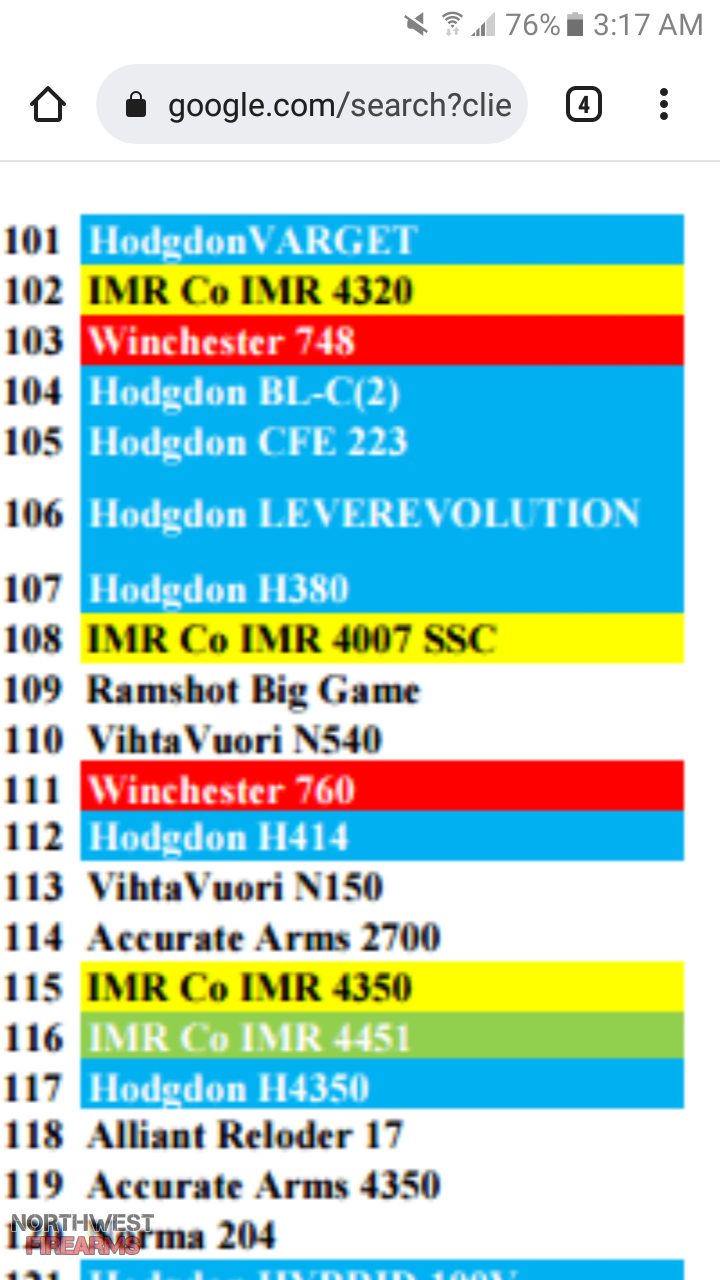

I think if we were to look at only the stick powders in the 104 to 110 burn rate range on a few different burn rate charts, we could narrow down the few powders that this MP 540 compares too.
I am pretty sure based on the burn rate range they quoted that it will work for heavier bullet loads which was what I have been looking for.
I am not sure what other charts could be included for comparison?
I sent one more email to American Reloading asking them which burn rate charts they use. I am probably not going to wait for a reply before placing an order. I will report back here if they send the info on which charts they use. Even if we were able to determine which powder this was, it could be a bad batch that was either too fast or too slow to sell as canister grade by the manufacture. I believe we can safely work up loads with the info we have.
Here is the reply I received to my last email asking which burn rate chart they were using.
"Yes its bases on the first one. Between W748 and W760"
Here is the chart he referred to as the first one.
I am about 99% sure this is MP 540 powder is VV540.
This bodes very well.
This may not bode well for the powder if it is VV N540.

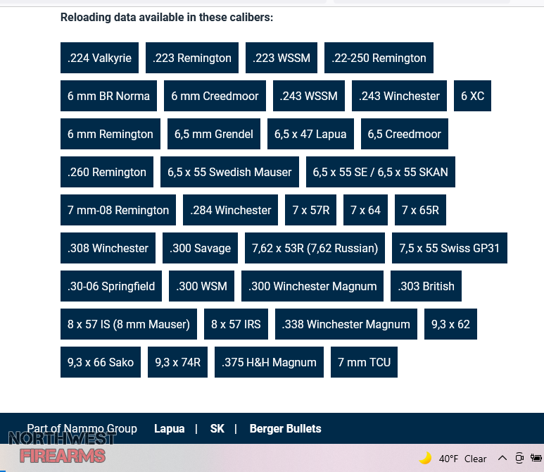

"Among Vihtavuori product line we have only five types we call N500 (N530 ... N570) which are by composition double base powders. N500 rifle powders contain small amount of nitroglycerol to add a bit more performance required mainly for extremely long distances. Even with these products we have added a special additive as well kept nitroglycerol content rather low in order to minimize the barrel erosion effect.
So, my opinion and advice is to keep barrel and throat erosion on minimum by using only single base powders like Vihtavuori N100, N300 and 3N.
Best Regards,
Mikko Vuoristo
EURENCO Vihtavuori O"
