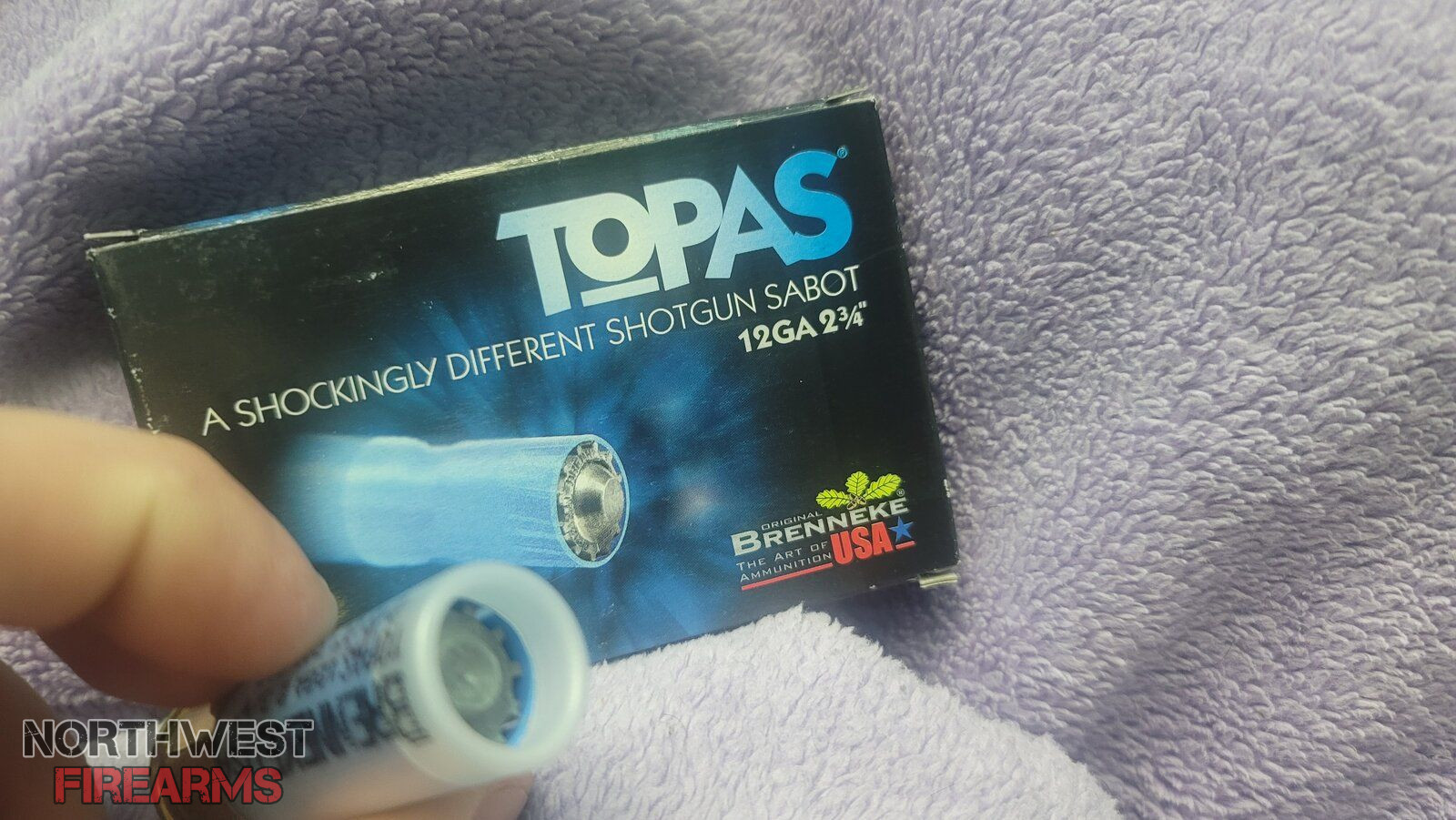

Perhaps I don't understand exactly what you mean but it sounded like these sabots I have.
Those are just a high quality Foster type slug.
They do not typically spin - much, if at all. The "rifling" on them is intended. to work with chokes.
