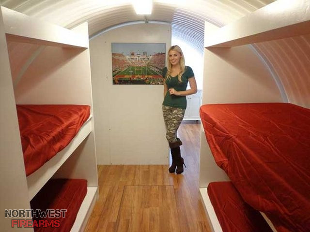

Neato! And, yah, that can't be an inexpensive proposition.
Agreed. But if you think about 2 shipping containers, ALL mods and work to get the 2 prepped and secure, you are probably pushing close to the price of this system?
