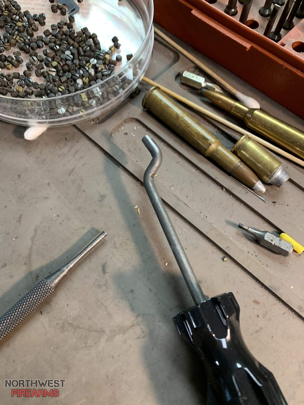

You're looking for the long gone "Ruger popper". It was a modified screw driver that fit the angle of the grip frame so you didn't need the hole. I don't have one but I've tried to track one down to no avail. You can make one of the poppers with a screwdriver, some heat, and some time. Quite a lot cheaper than a machine shop. I have a couple GP100s from the early 90s that don't have the access hole and I usually end up using the short end of an allen wrench to depress the plunger.

You're looking for the long gone "Ruger popper"...
I've never heard of these, but now that I know of them I want one! Thanks for showing me an unobtainium item o_O!
I've been digging around last night and found these were sold by Brownell's years back, and after that a guy with the Internet handle of GP100man was selling his version for $10 shipped. He had a lot of postings especially in the Ruger forum but seems to have gone undercover a few years ago. I've joined the Ruger forum and will get 10 posts in sometime today, after that I can use the PM function and will see if he is still around.
Or, I just may make one myself. My 16 yr-old son built a forge that he uses to make custom knives (if you are thinking of commissioning a knife let me know, his work is pretty amazing, both in quality and price) so heating up an old screwdriver and taking it to the anvil will be pretty easy. Just getting the correct length and angles is the challenge. I wish I had a better picture of the shape of the tip (which was hardened by GP100man on his version).
I'll let you know how my search fares, and if I make one myself. If I do making two would be easy and I'm happy to send one your direction.
GP100man's original and then cheaper version once the cost of screwdrivers climbed to almost the $10 he was charging.
The popper in action. This would be better than even using the elongated hole if you have it in your frame. Far better than the allen wrenches that I also use to press this latch.

I've found this tool works great for releasing the trigger assembly ( just don't tell the Ruger this tool was made for the Smiths :D). I reduced the nose diameter just slightly on a hard scotch brite wheel. No need to putting a hole in the grip frame :). Fits right into the grip frame.

Thanks for the tool tip Velzey, I ordered one of these from Brownell's but have yet to use it! I'm sure it will be safer then the Allen wrench or screwdriver I have been using … while these work just fine there is always a chance of slipping and gouging something like the firearm or my flesh!
