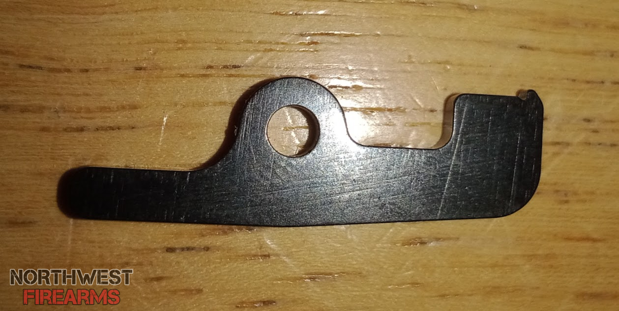

I learned about another problem that contributes to ejection issues and MAY have something to do with the problem I had. Apparently the extractor on them has too small of a 'finger' to grab the cartridge case and in some cases it is resulting in them 'stovepiping' and not ejecting properly. While this has NOT been an issue for me I took my extractor out and can see the finger appears to be very short and a corner of it appears to be chipped off. A recommendation I read to temporarily fix it is to file the the 'flat' down to increase the size of the 'finger' to better grab the case. I did this but have already emailed Ruger and asked them if they will send me a NEW extractor but I am looking at an aftermarket one made by M*CARBO and appears to be a MUCH better extractor and I will probably order one!
Pretty dang small 'finger' to grab the brass!

Got the new extractor today from Ruger.
It's an dramatic improvement over the original but doesn't look as good as the aftermarket from M*CARBO, at least the picture of it.
I find it a LITTLE odd the top (shown) is mostly 'flat' and the bottom is slightly 'beveled' on the edges but there could be a reason for this such as its probably a STAMPED part.
