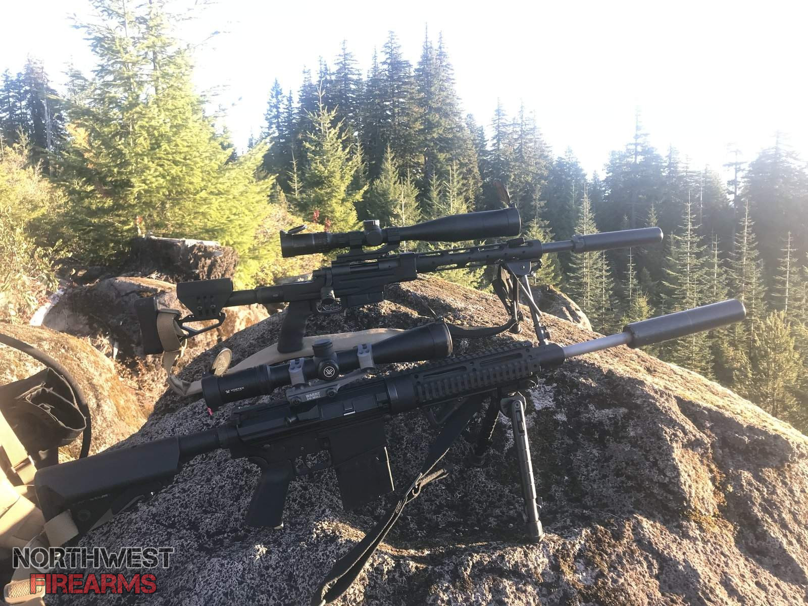

just like nothing says "we're deer hunting" like these two rifles:
my lr308, my buddies rem700

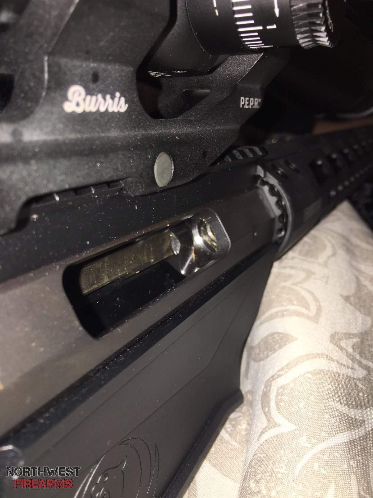

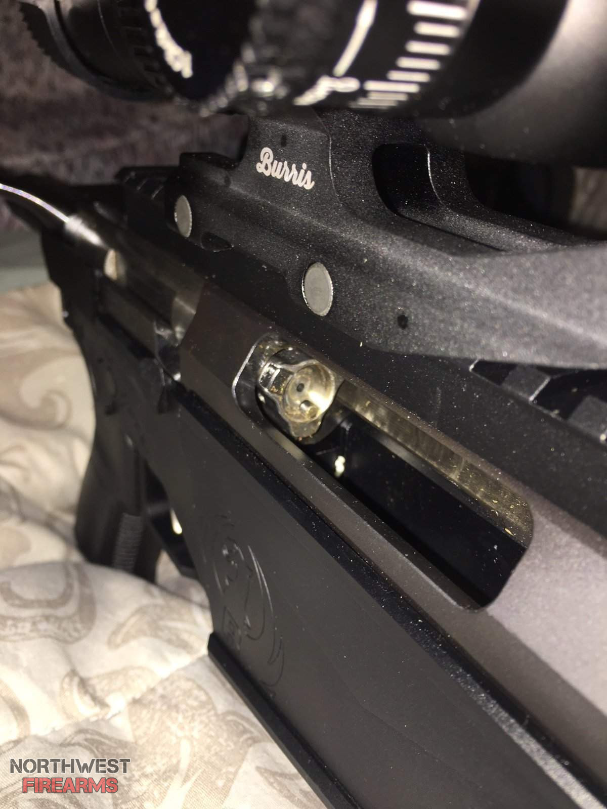

View attachment 404761 View attachment 404762
These are the best I can do with my phone. The bore is clean and the rifling looks even. At least to me. How can some brass shavings affect it that much?
For me the shavings were thick enough to prevent me from closing the bolt because of .001 of an inch worth of brass in different areas. How it affects it I can't honestly say scientifically. I could speculate it has something to with deforming the pill in some manner or putting it at just slight enough angle to be sent down the barrel less than true. Obviously something is not allowing your bullets to stabilize. Curious if you have seen any keyholes or larger than normal holes?
