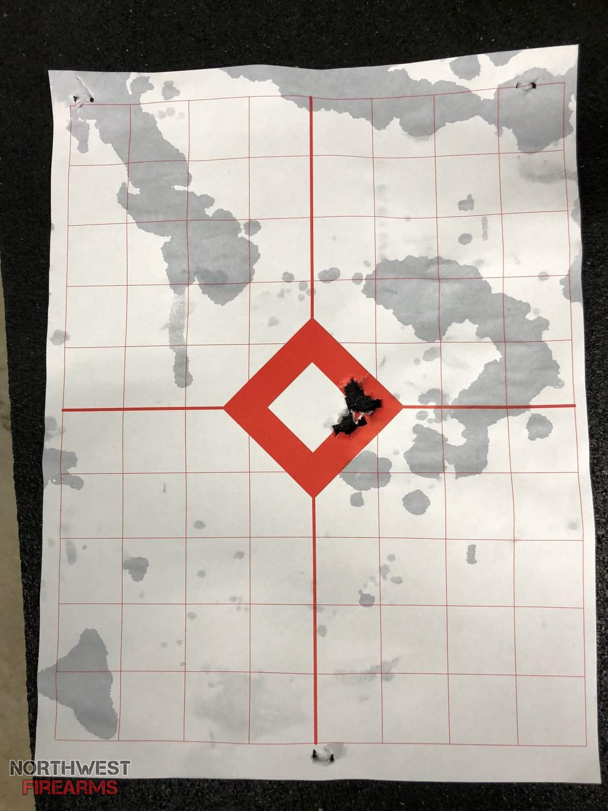

So I took out my RPR today and had a chance to run it for the first time. Set up with a Vortex Viper PST 6-24x50. Ran some cheap PMC Bronze as well as Hornady Black and another match grade ammo. About 60 rounds total. The range I went to requires a 25 yard "sight in" for new rifles.
So at 25 yards, I put two in the same hole about 1" above bullseye. Windage was perfect.
At 200 yards I missed the target altogether. We switch back to the 50/100 yard range. At 50 I'm at the very top of the paper. So a few more shots at 50 and 100 and I'm feeling lukewarm but we switch back to the 100/200/300 range.
From there, I was all over the place, including a 4" group at 100. Constant scope adjusting. Never did get anything better than minute of dinner plate. Had the friendly guy next to me shoot it, as he was shooting the same rifle in 6.5CM suppressed. He has the same results.
So just to make sure I wasn't having a seizure while behind the trigger, I shot @SKrueger 's Tikka. Managed to put two in the same hole at 300 about 1" to the right of center. Back to back. So I know it wasn't me. Not only that but I've successfully shot to 800 on a 2/3 silhouette with a .223 AR platform. I know how to shoot. I'm not the best, but I'm better than 4" groups at 100 yards with a $2000 rig.
So, I'm looking for suggestions. The scope and mount were looked at by several people including the RSO. Everyone agreed it was tight and mounted properly. The RSO said I needed to clean and break in the barrel and try different ammo. Another suggested trying a different scope to factor that out...
My question is does this thing really need a 200 round break-in to be accurate, even 1MOA accurate? Or do I have a possible scope/rifle issue. I have a Bushnell Elite I can rob off another gun and will more than likely do that. But wow, what a disappointment. Great day on the range, but I'm sure sitting here contemplating my choice of a 1000 yard gun.

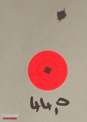

Here is my 1000yd set up, only shot 20 rounds through new barrel before the Leupold cup and it was right there X and 10's my missing the wind was my fault. Kelby action, Krueger barrel, Leupold VX6 7x42, Lapua brass, Berger 185gr Juggernaut, 43gr. H 4895. This works.
Ken
