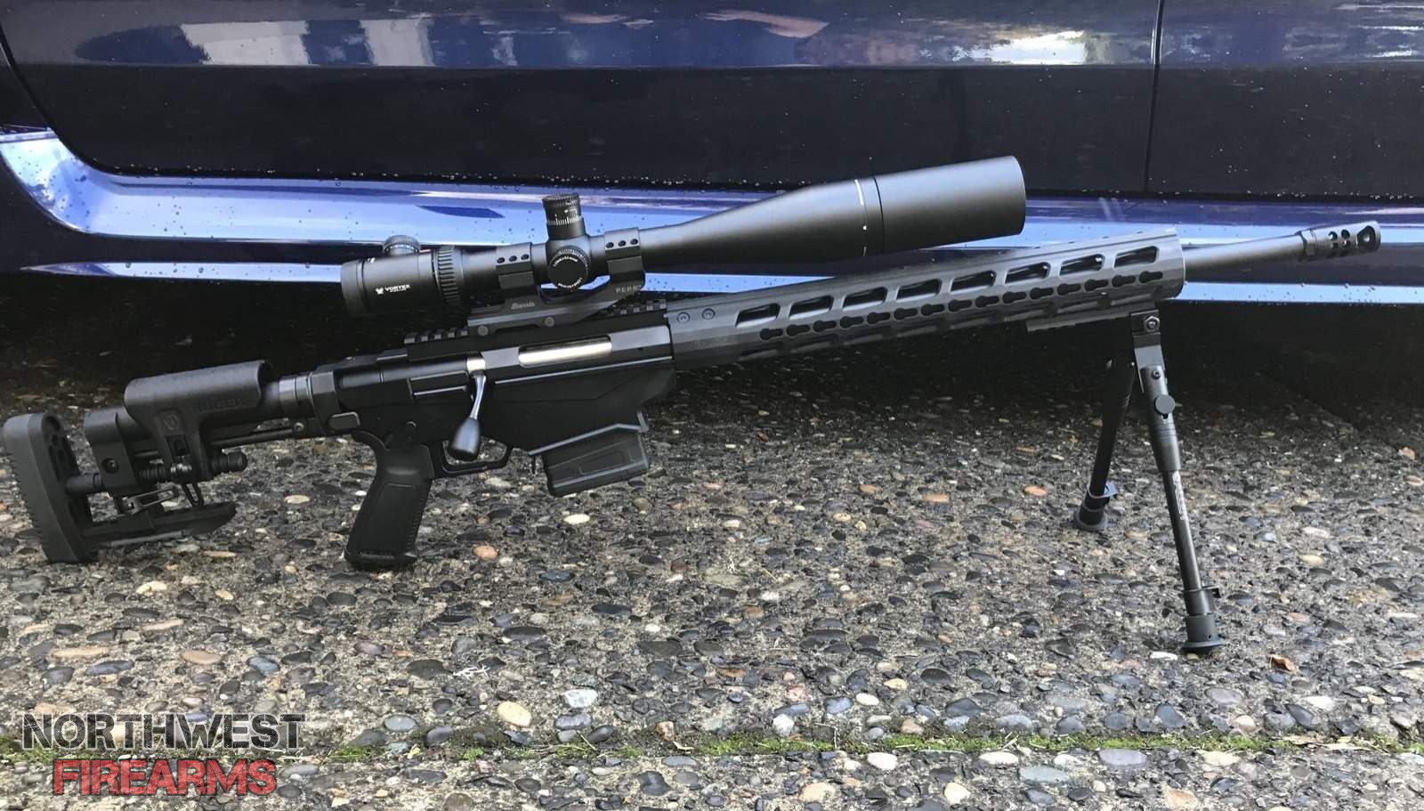

the mount isnt "bridging the gap" between the receiver and handguard is it?
Nope, nothing touching at all. Maybe even a little tall.
One of the Issues I heard about with the Rugers had been in the Barrel Bedding. I think you should give it a bit of polishing, check the bedding and STAY with the same ammo. Using "whatever" Ammunition during break-in is one thing but if you are checking for Accuracy then I don't think swapping out from one Group to the next is going to work.
Makes total sense. But 4 MOA? I would expect that with even bulk garbage I could do better than that.
Yes, I do. And if I can get the darn thing to tighten up I'd be more than happy to have it host one. But right now I want to throw it out a window! :D

ya. WTF? wondering if theres some debris in there.
as a handloader the only time ive had a bolt be hard to close is when i failed to resize my brass properly.
ive had bolt be hard to open from over pressure before too.

These are the best I can do with my phone. The bore is clean and the rifling looks even. At least to me. How can some brass shavings affect it that much?
everything look straight? barrel is going straight thru the handguard and not more toward one side? is it possible the barrel nut might not be tight?
Throws the round off trajectory?
Just a guess
OK, but how? The projectile travels down 20" of rifled barrel....so if the bolt face and feed ramps are crudded up with brass shavings how could that affect the trajectory? And no, no strikes on the break @v0lcom13sn0w. But great question and made me look!
To my untrained eye, everything looks true and is tight.
not sure this would affect anything since a scope is zeroed to the barrel bore but assuming something is coming in contact with the handguard (bipod, shooting bag, lead sled) could the handguard be flexing or vibrating throwing it off somehow?
