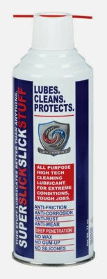

I used to use teflon spray a lot but it doesn't usually last very long. I use Super Lube teflon grease in places that aren't dusty & Super Slick stuff in places graphite doesn't belong
Slick Stuff doesn't attract dust but it's thin so it doesn't last the way teflon grease does
