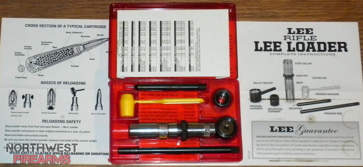

This was my first as a teenager. You just need a rubber mallet and your consumables. :)
