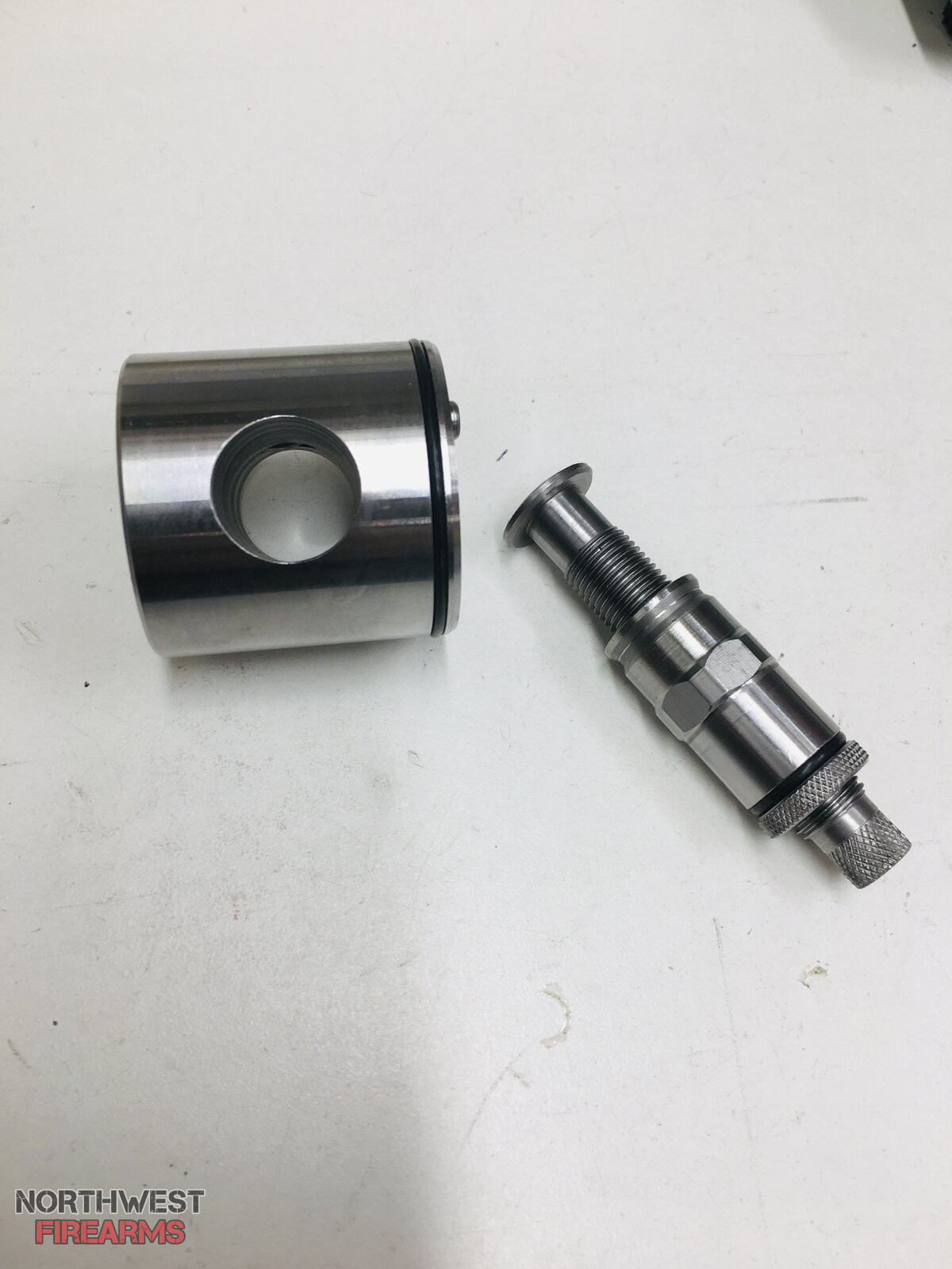

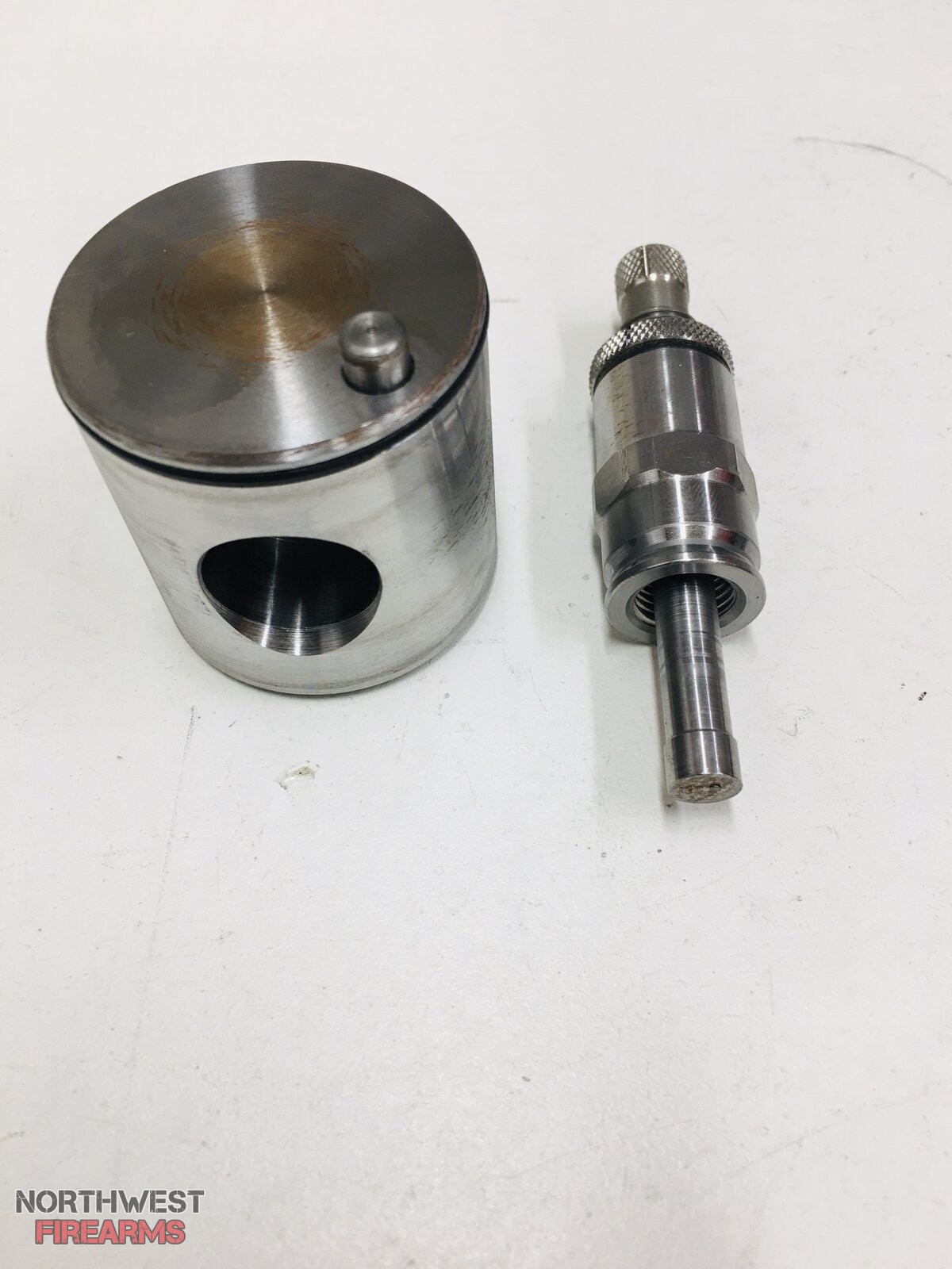

There is definitely a difference in the two, the first pic has a small barrel that goes up into the rotor, the second one is a big barrel for lots of capacity.
View attachment 1772729 View attachment 1772730
Good to see that there is a difference, guess I just haven't noticed it since mines only set for a 20gr max for 5.56. All my large caliber is still done one my single stage for now and I use and auto dispenser for them.
