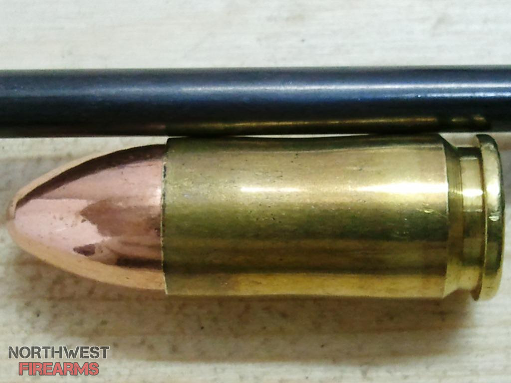

My new dillion carbide 9mm sizer is hour glassing the brass.
Ive adjusted / backed off to where they just slip into the case gage.
Tried on all different brass, shot out of different guns...
I setup my old rcbs other than a couple of scratches it isn't hourglassed...
Anyone have suggestions??

Can't really get a good pic, its the bottom 1/4 is sunk in..
I take it you haven't seated bullets yet? You'll be seeing the base of the bullet bulging the brass. By varying degrees depending on the brass maker. Some is thinner walled/some thicker. Or, some softer and some stiffer. You'll notice on the down stroke. I've never had an issue with the bulge. However, depending on your projectile OAL may need to vary from your book recommendations due to the length of the bullets bearing surface getting into the lands. "Plunk" test in the barrel or course.
A visible wasp-waist between bullet and case head will not affect function. Conversely, a slight bulge indeed can. Some dies will provide almost straight walls, but those are better suited for single-stage presses. Dillon most likely errs on the side of reliable chambering and extraction over appearance. Nevertheless, the pressure at the moment of firing instantly expands the case against the chamber walls. So, it is mostly a moot point.
There must be one or two, but progressive presses are not generally used by competitive target/long range shooters. They are made to crank out max ammo in minimum time. You can adjust your expanding die to expand the case only to the seating depth of the particular bullet you are using. This can help with bullet setback since the bullet, once seated, is bumping up against that narrowing of the case. It can help a bit if you set the depth carefully, but a taper crimp is best.

I had the same problem of the die undersizing the brass, and then when seating the bullet I could see the bullet expanding the brass back to back to bullet size. Everyone said it would not matter and would shot just fine, But they looked like they came from "Bubba's Basement Reloading Emporium!"
They were right, the ammo shot just fine. But I could not turn out ammo that looked like that!
It took me awhile using a caliper to dial in the resizing die to give the right taper and not undersized. Now my handloads look just like they came from the factory and shoot as well or better.
The depth adjustment is a fairly coarse thread, so had to play with it through a few cases to get it right. But now I'm happy with what comes out of the press!

As well, different lots and different formulations of the casing brass have different amounts of "spring back" once sized. The softer brasses would tend not to spring back to their former shape after sizing.

You know, I never though about backing out the sizing die to try and eliminate the bulge from the bullet? Not sure it really matters unless you're entering finished rounds in some kind of beauty contest. This last batch of 400 or so cases I processed I did touch the lube pad with my finger every 4-5 cases to make sizing easier.
Are you using used brass? What are the headstamps of your brass?
If it is used brass, you can try a bulge buster. I run all my range pickup through a bulge buster one time. And the Lee App press can make quick work of the task.

I'm tying to remember what die I finally went with. Best case was with a non-carbide Redding. Then the dies not designed for a progressive press. They tend to have a lot of taper at the die body opening to ensure the case always feeds. These dies don't size down far enough. Your dillon die is a prime example. I think I finally went with a carbide Redding, but the Lee die was ok. I'll have to check.
That's what im coming up with the image that Gonzales posted.
Ive backed off the sizing die, but im not happy with the dillon die.
