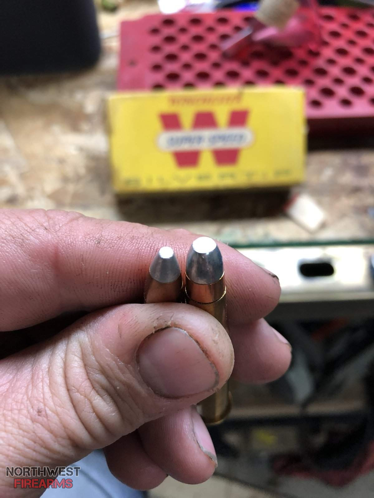

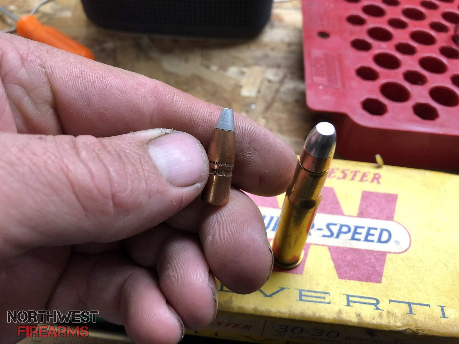

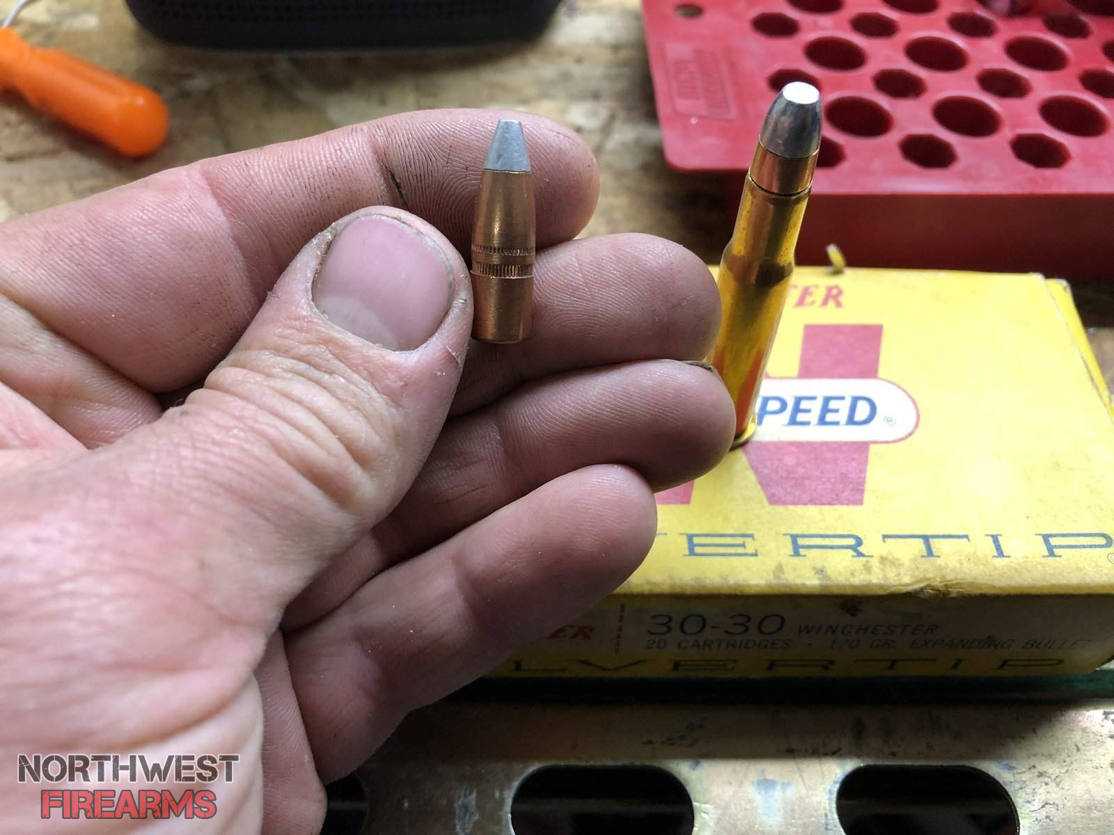

my question(maybe a silly one)is, do these look safe to load in a 30-30 with a tube fed magazine? as you can see in my pics below, the 150 vs the 170 has a smaller point on it.
was thinkin puttin these over some BLC2
or if its not safe for 30-30 just stickin'm back on my shelf :) some guys were saying these pills go for $1/per which sounds outrageous to me. lol.

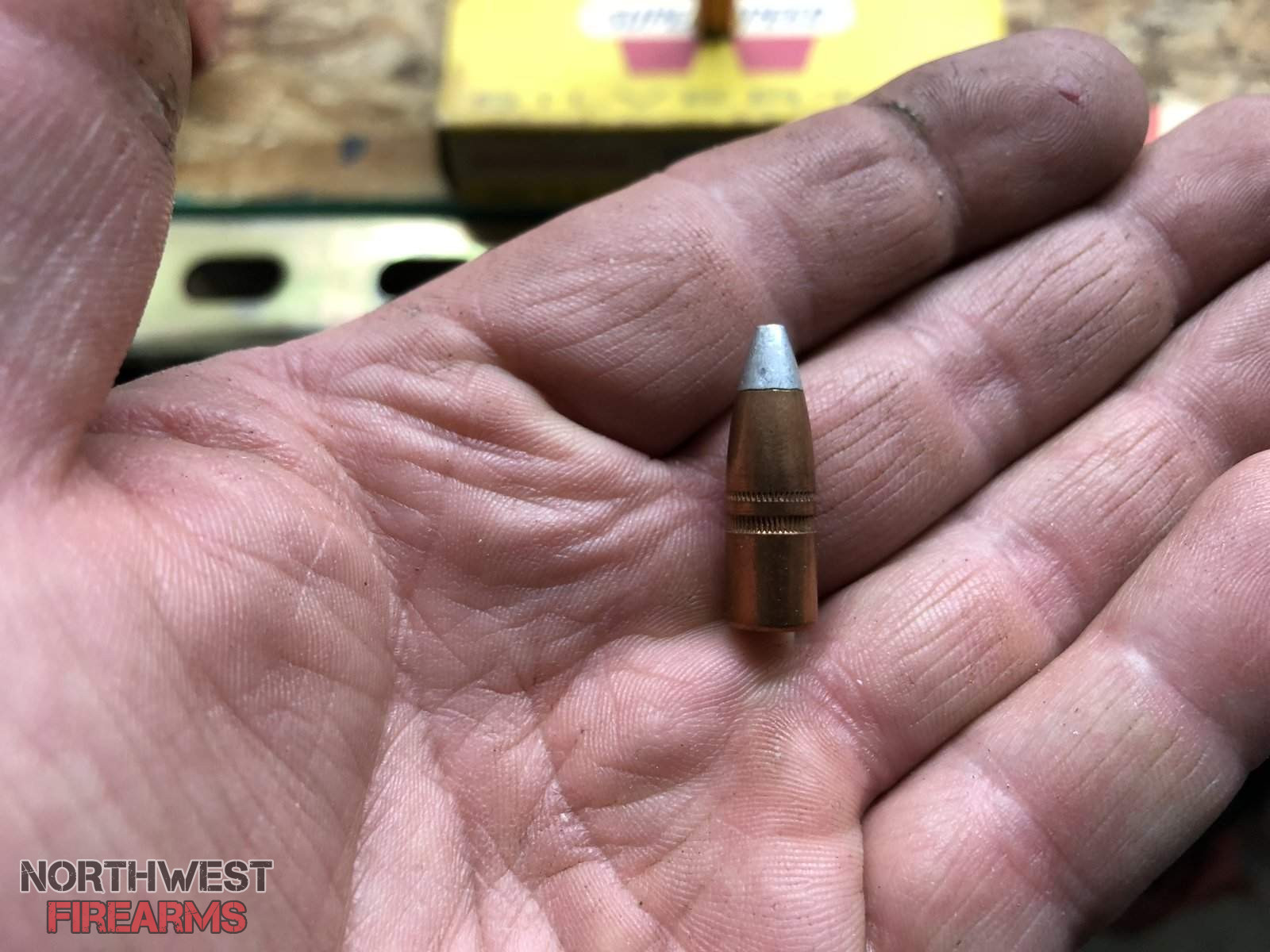

all the info i can find online is for the new nosler/winchester ballistic silvertips and doesnt help.
what do ya think?

You don't want spire points in a tube fed magazine. Too much possibility of a KABOOM from the tip of one cartridge setting off the primer of the one in front of it!

i was thinking the same thing mainly because the diameter of the tip was way smaller than the 170gr. i got these projectiles in a ziplock bag. im pretty sure they probably were for 308/30-06
Does the projectile flat cover the primer completely and some of the base of the next round? If so you should be safe to load into the tube.
If not, you could always take some off the top to broaden the top so they do. Might take a loss in the weight of the bullet but if you take the same length off each bullet it should make for a uniform loss per projectile.

thats a great idea! the way these are now, they would contact the primer. i may just go buy new projectiles :)
I'd not load those 150s in a tube fed 30-30.
They are valuable and I would sell them at a profit and go buy new bullets.

Besides the primer contact issue, would you be able to load them short enough to cycle properly?
Most likely not. And if loaded to the OAL of typical 30-30 bullets the ogive of the bullet will well past the neck of the case and cannot be crimped.
Load to the cannelure of the bullet and shoot single shot or do not use at all.

I've read several places that the danger of a pointed hunting bullet setting off the round in front of it in a tubular magazine is actually very unlikely and the danger is seriously overblown, BUT- I'm sure not going to take any chances!

thanks for the input i think i'll just go buy some RNFP tomorrow or maybe after deer season!
