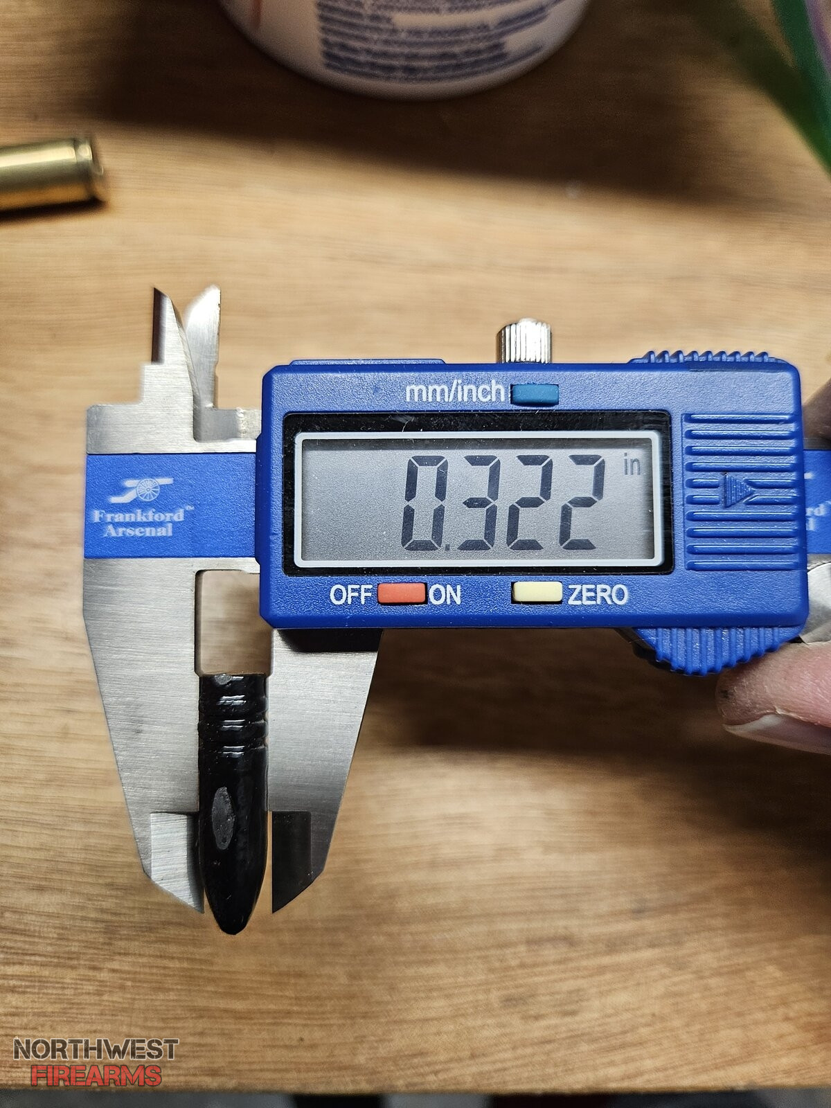

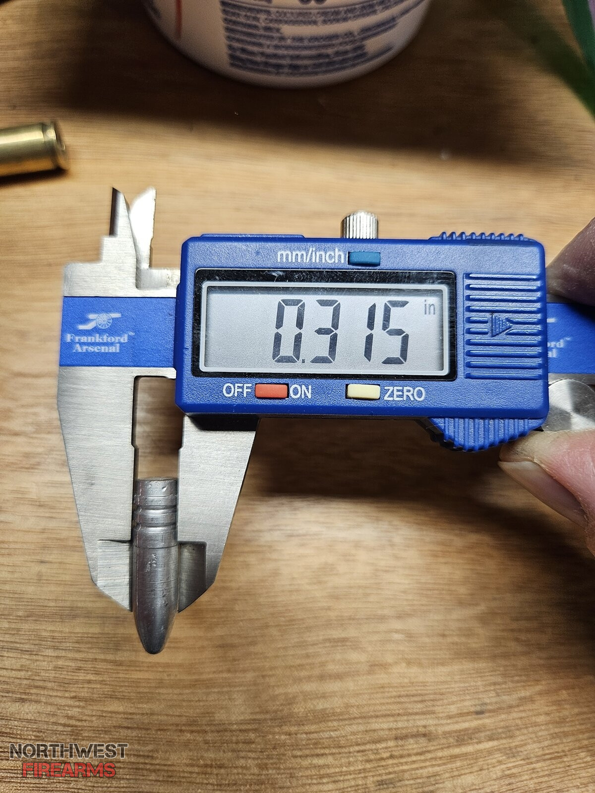

Rcbs 30-180 sp isn't oversize.... should be .309 to .311 at the bands, and .300 or so at the nose.
That was the wrong bullet. I don't know what mould these bullets came from.

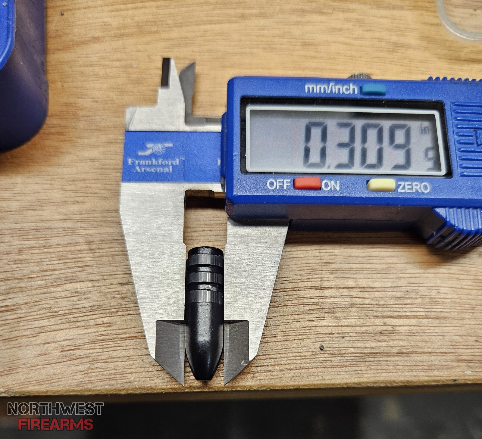

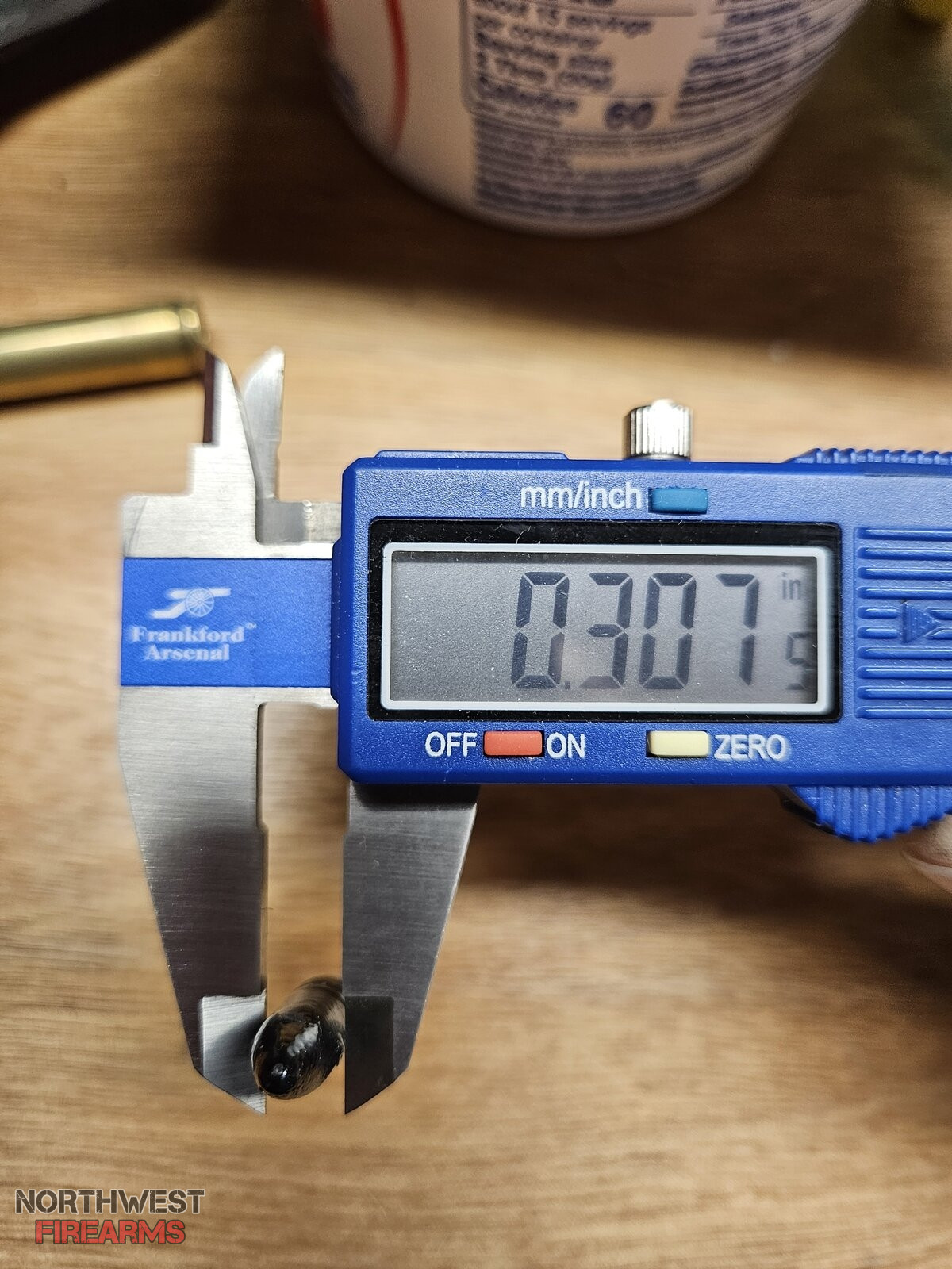

Before powder coat:
After powder coat:
Way too fat... good for 303br, etc... not for .30-06. That nose won't fit normally in a .30-06 @ a normal crimp, like you found. Review the manuals for cast bullet sizing, and shooting....

I coated up some .310 180gr bullets. I am going to load up 15 of them with 16gr of 2400. After coating they averaged around .316. I sized them back down to .309
