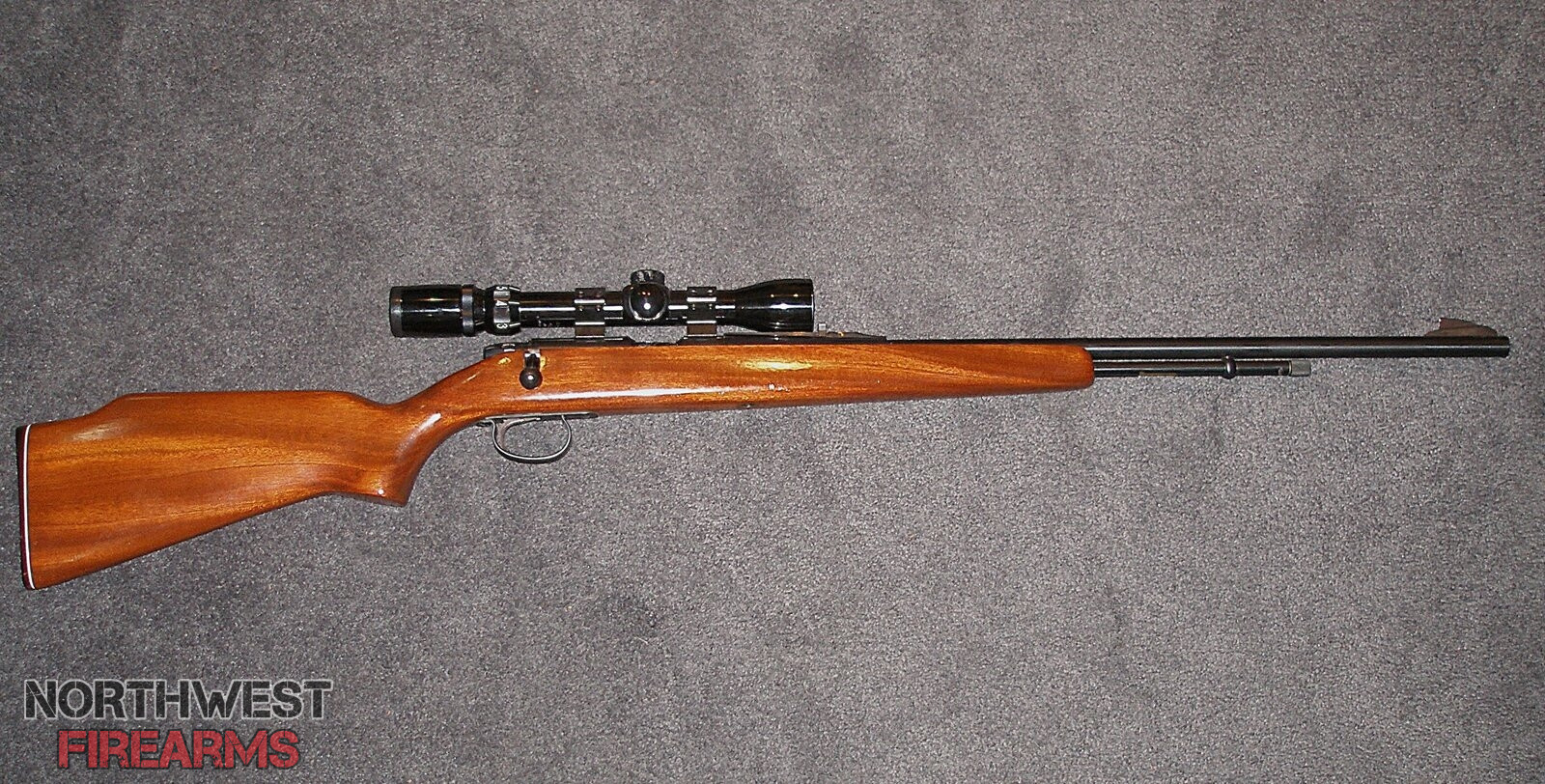

Next, I went to the 25 yard range (50 was full) to zero a new scope on a Rem. .22 bolt action rifle. This is a Rem. Model 582, tube magazine, beautiful wood for a factory stock. But it's been nothing but trouble since it came with Dave's stuff. First, the trigger mechanism was frozen up from decades of lack of use. So I put that aright through painstaking work, as the trigger assy. was never designed to be repaired, only replaced. Next I figured it was ready for the range with open sights. Wrong, the sights are mismatched so it prints on the target way low with no adjustment left. It came with a centerfire scope on it, with 1 inch rings that mount on the typical .22 receiver top dovetail. That scope is a 1970's Bushnell 3-7x. But the power adjustment ring is frozen solid. So I decided to get a rimfire replacement scope. I found one I liked on ebay, a used one about the same vintage as the rifle. I forgot about it and missed the auction. It sold on one bid at the starting price, $15. Anyway, I couldn't find anything else that I liked so on a whim I bought a new Chinese Tasco rimfire scope for $9.00. I thought, "how bad can it be for $9?" Well, bad. It took me a long time to get it mounted, something with the dovetail design seeming to be easy. The aluminum claws on the rings just didn't want to hold. I finally got it to stay on the rifle, but I thought, "Be easy with it; the scope might fall off." When I got to the range, I was 12 rounds into the zero process when it fell off. So back it goes. I've got another 1 inch centerfire scope I might try on it. The steel claws on the 1 in. rings don't have any problems holding tight. In the meantime, that 1960's Remington front sight is too tall. I think it came from the factory that way, but I can see that there is a dovetail in the top of the barrel at the muzzle for a sight that would drift in.
Made with the Monte Carlo style stock, the rifle was obviously intended to be scoped. It's rather uncomfortable trying to use the iron sights due to the stock design.

That 582 Remington deserves a decent scope.
I'd be on the lookout for a nice Bushnell Scopechief (7/8" tube). (70's-80's vintage)
The Cadillac for it would be a 3x-9x Leupold Compact Rimfire Extended Focus Range. (EFR)
That rifle is capable.
I decided to look at the issue with the front sight again. The sight that came on the gun WAS NOT factory original. After taking it off, I can see that it was done some time later. At the factory, they would've used a jig of some kind to drill the holes. They would've slightly countersunk the holes. I knew the sight was a common one used in this era, oft seen on the Nylon series of .22 semi autos. And Rem. 572, plus others. But NOT on the 582.
Sight that's been on the gun. Note the the dovetail under the sight.
Here is the sight I replaced it with, which if not Rem. factory type is very close:
I had some left over filler screws. I didn't want to monkey around with countersinking at this time; maybe later.
In this picture, I've placed the previous sight next to the new one, you can see the difference in height which explains why the rifle was wildly out of zero:

I have a OLD 572 . I replaced the barrel from the auto version . The old barrel has the dovetail and the newer auto barrel has that newer two screw front sight. Was a real bear to find matching factory sights for both barrels. I feel your frustration.
I already had some of the appropriate front sights, which I used one of. Now, I've got the swoopy 1960's front sight left over. Which I see on ebay bring good money.
