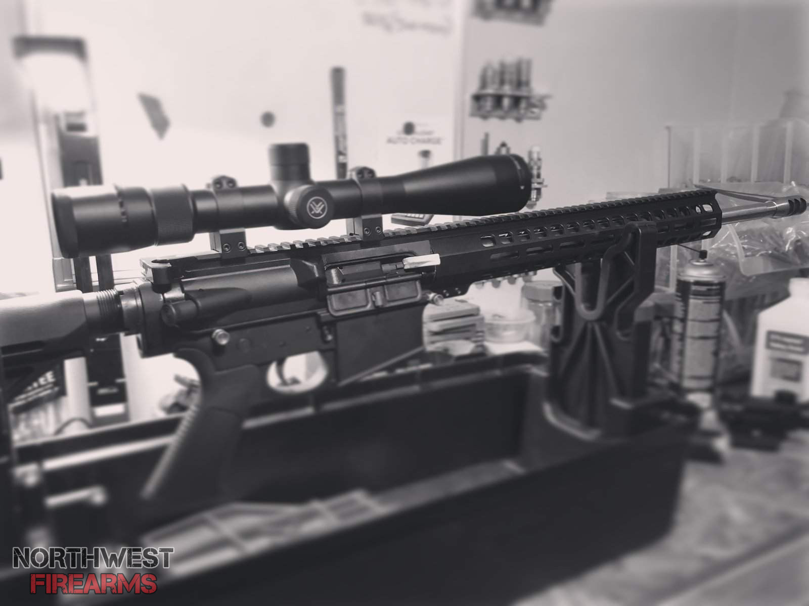

    So I went down to Sportsman's Warehouse today and they had a special pricing on a little Nikon Pro Staff it's one of the long range BDC 4-12 power w with a 40mm front end.
    I bought a set of 1 inch Riser rings and slapped it on top of the rail.
    I was a little bit concerned that the front end might be too close to the handguard. Here's some pictures I think I've probably got a millimeter of Clarence between the handguard and the scope. do you think this is going to give me trouble or am I a okay to leave it the way it is. I don't know if the handguard moves around on your shooting it or not.

    You are probably going to have trouble getting a proper cheek weld with those low rings. Should have gotten the AR height rings for the proper cheek weld. I wouldn't worry about the handguard touching the scope, you have plenty of room there.

    Put some grease or lipstick on the scope bell and see if it marks up your handguard.
    If no transfer of goop happens, just make sure you’re confortable in all your shooting positions.

    I like low optics and I have a low cheek weld.
    If it stays true and handguard doesn’t bop it, leave it alone if it’s comfortable to shoot

    That scope is too low and not because of the handguard issue. The standard AR scope height is just over 1.5" above the picatinny rail, but 1.93" also has a large following as is gets you above top rail mounted lights and lasers such as the DBAL-A3, as well as thumb over holds. Even taller mounts like 2.04" for gas masks and NOD/NVG use.

    There is low and then there is digging your face into the stock. The in-line design of an AR pretty much dictates a higher line of sight than most rifles.

    That is a drag, I told the guy I was putting it on my AR, I even showed him the picture of it. I've practiced shouldering it and it does seem like I have to force my upper jaw into it a little more than I am used to... Crap.

    This is my lowest though @ 1.125” —- 3/8” below standard on the AR-10 centerline to top of rail. It’s not uncomfortable for me. Benefits maybe if a 30mm tube?
    My Vortex Spitfire from top of rail to centerline is 1.5” (standard) on the -15.

    Scope is too low, go 1.5” or higher...
