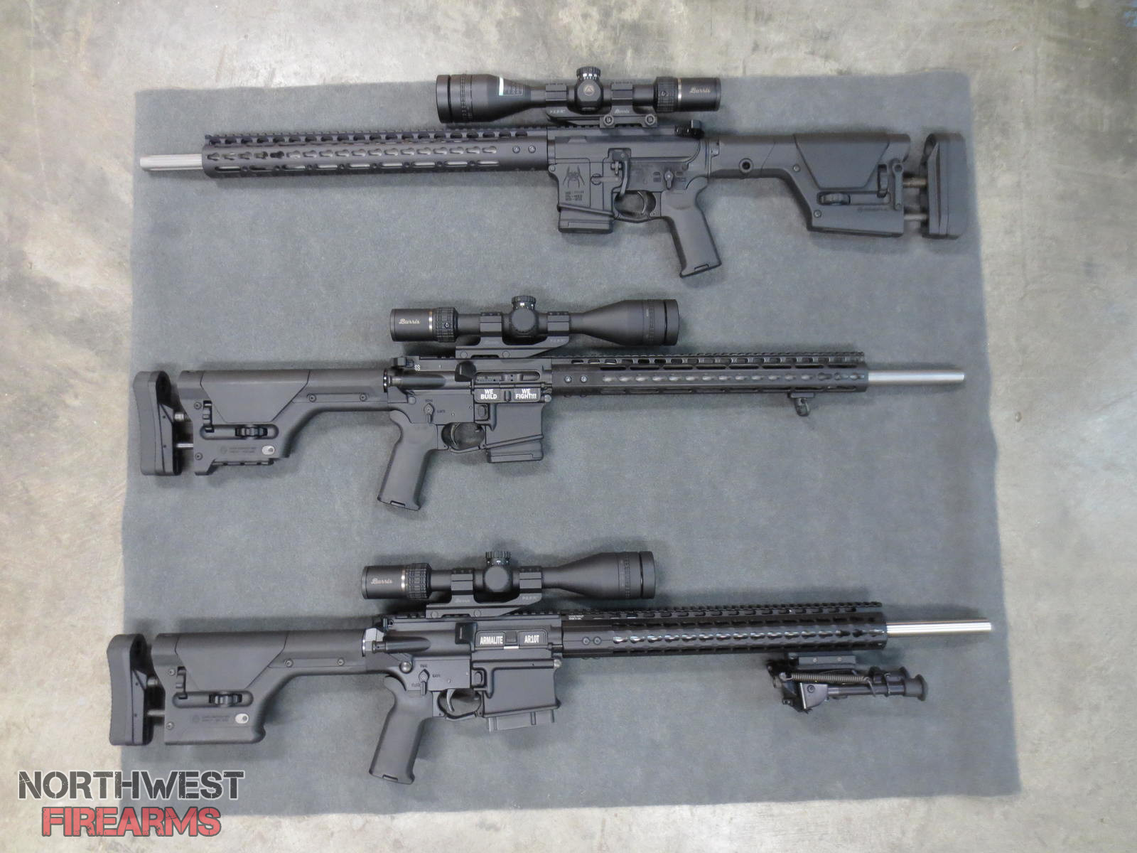

I respect that. You will enjoy working with the AR platform. It can be addicting though: Just a warning. By the way, if you want to see how the P.E.P.R mount looks on some AR's, here are a few of mine:

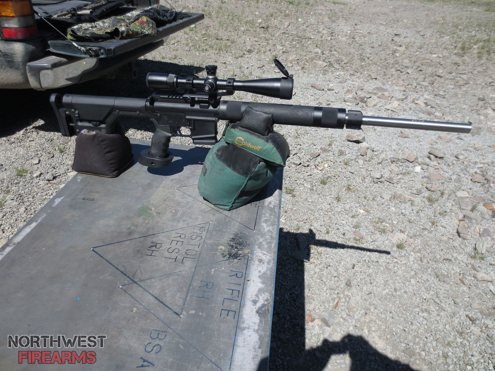

The top 2 are ar15's, the one on the bottom is my AR10... Your Nikon should work just fine on your AR too. I started out using my Buckmasters 6-18x40 on my left handed Stag. (See pic below):
That was with the Leupold Mark 2 mount though. I ended up replacing all of my Leupold, Aero precision, American defense recon and other mounts and switching them out with Burris. They are strong and have proven themselves to me. In the pic above, you'll see what Directdrive was talking about with not being able to get your 2 piece rings far enough forward for your scope on your AR. You can see how the cantilever mount places the scope in a more forward/natural position on the rifle.

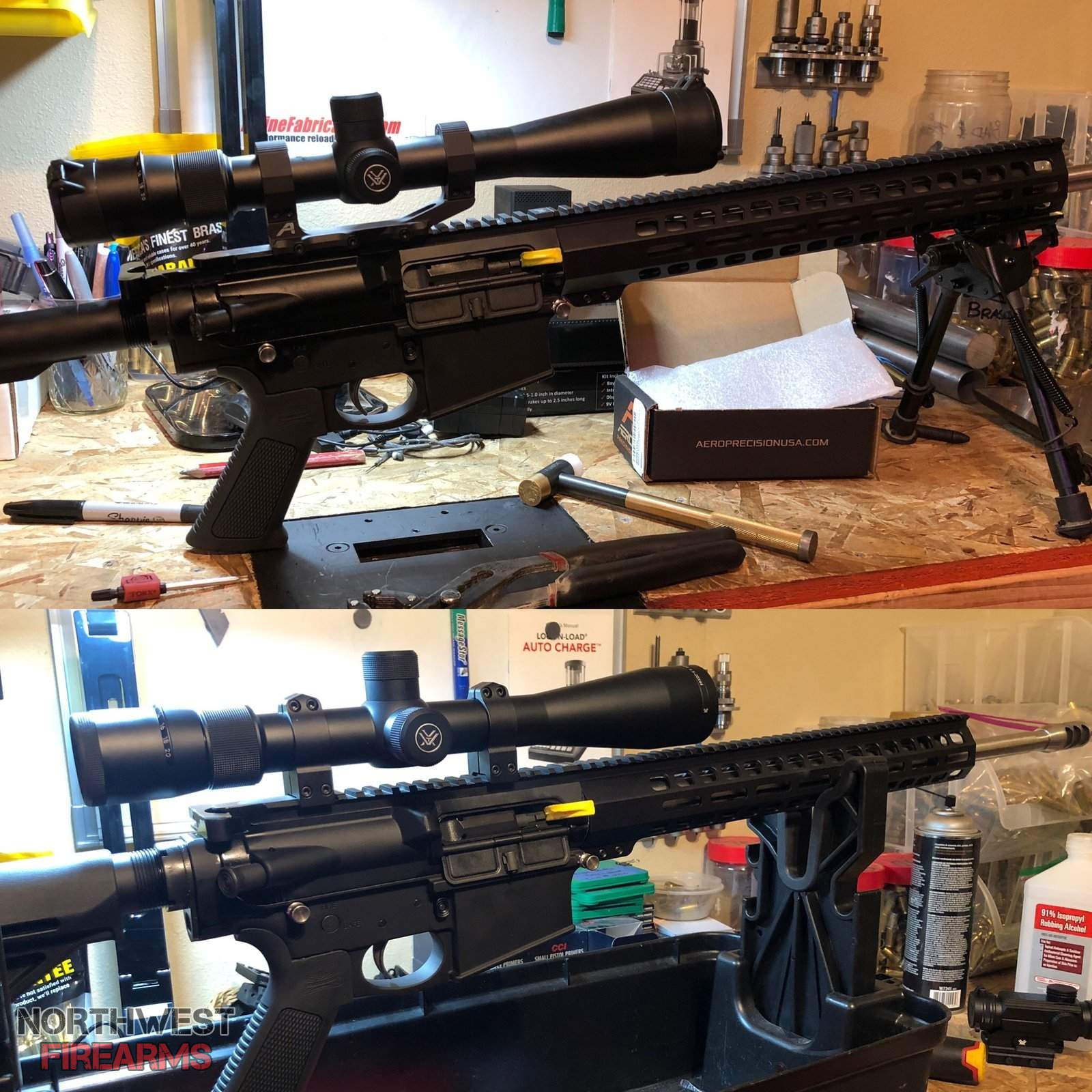

I ordered an Aero for the 30mm tube. Apparently my mind was confusing my bolt rifle mentality with the AR 1.5" mentality.
Now and before:
My other AR's all use 1.5" CL on the optics so I can't figure out why I thought this was so special.
My apologies.
Well, after a crazy week, I decided to do something fun tonight and took your advice and got the Burris Pepr set up with that new scope.
What a difference in my cheek weld. Thanks for the advice, once again you guys helped me out.
