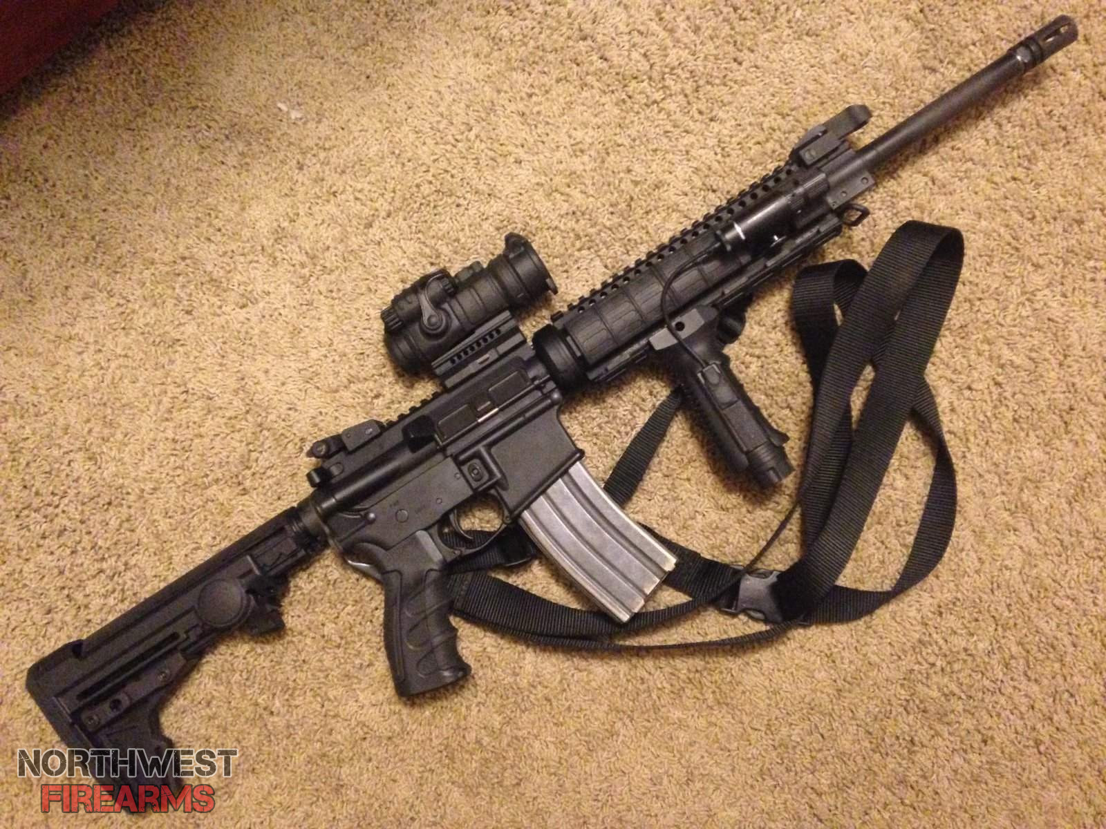

this is the grip 23 with a flat bow, pretty much have all my AR's set up like this
