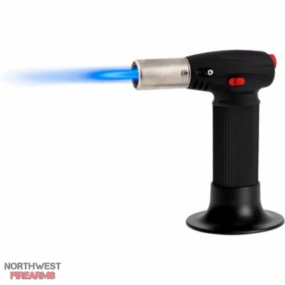

Just a little heat with a butane "crack pipe" torch.

This. A some high heat.
I've used it to repair valve covers, fill in unwanted marks on lowers and barrels. It will take a lot of heat and hammering but if you go at it with high heat, the polymers will melt. Don't chisel on it; go with heat.

This. It does take heating the surfaces to 600 degrees that may have an affect on finishes. You might consider using a welders blanket (carbon felt) to cover all areas except the area you want to heat.
The other, safer, option for a small bit like that is using a solder iron/gun for directed heat. Not all soldering irons will get hot enough though so check the specs.
There are chemical options using acetone and vinegar... some people say... but I've found that really only works cleaning up excess and doesn't do well getting into the actual bonded area. Mechanical effort is still required. YMMV
Soldering iron. Not torch. Press biggest tip you own to sight. It will heat up without really heating up the surrounding metals.

That flew right over my head. When I read it I though he was talking about a plumbers torch. You know... for cracking apart old metal pipe welds... "crack pipe torch". 🤣

Yes, it's easy to scorch a blued surface with a torch. I'm wondering how well the surface was prepared prior to the initial JB Weld bonding. It might be that a little pressure might dislodge the sight. Dollars to doughnuts if you didn't want it to come off, a little unintentional bump would knock it away. When you want it to come off, it's on like the Rock of Gibraltar.

If you use a tight flame, try wash cloth soaked in water - it helps reduce the thermal transfer.

You can buy a butane lighter just about anywhere. Especially in those minute marts that sell lots of glass vase with the little water level filler at the bottom.
