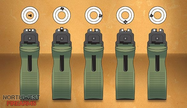

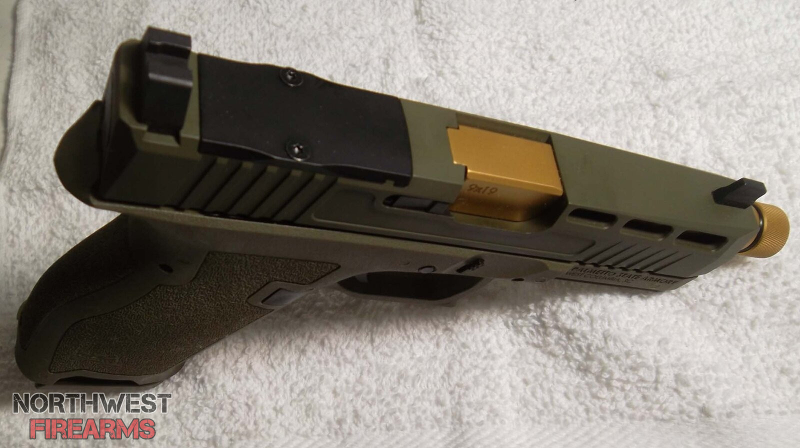

Howdy... I was gonna ask you in the Dagger, what is the right way to adjust the height "up"?
Thanks. H
File down the front site.
Thank you. That's the part I didnt know so I'mm do that.
I really like this practice gun. The recoil is twice than my other gun. (it feels like someone shooting the gun off hand) So after a few rounds then I switch to the Glock, its like paper! :s0006:
I'd swap the sights before breaking out a file.
Well, yeah. But a file at the range might be easier to start than having to push a sight out and a new one back in?
Thank you for the input. In this firearm, I'm thoroughly okay with filing it on the fly in the range. This is just my practice gun. Nothing special. I just wanna keep this gun simple, no red dots or anything.
Need more information. Do you mean that shooting from sandbags at 25 yards, your group is consistently low? To correct this, take a small amount of material off the top of the front sight. Your Dagger's iron sights are designed to co-witness with a RDS so there's plenty to work with. Go slowly, even 0.01" makes a difference. Or install a RDS and adjust it.
