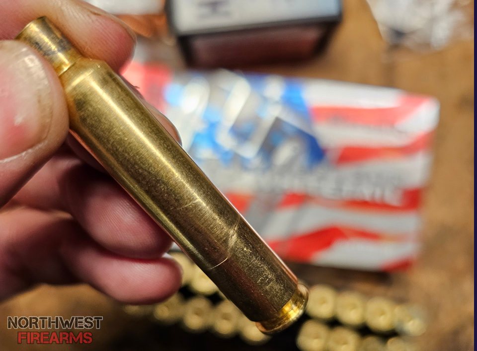

Quick post, today I fired the Hornady factory ammo to fireform that brass and found pressure signs and split cases.
With factory ammo.
pic.
Weird, can't say I've had that happen with their brass before. Was it just the 1 case or multiple?
Multiple. Flat primers and the other cracks were all typical where case head separation would be.
I had two boxes, different lots. The other box was fine, though 2 flat primers was otherwise fine. The second box is where the cracking occured. There was a very notable difference in velocity. The bad lot had an extreme spread of 174fps thru the 20rds in the box. 174ES over 20rds is horrible.
Factory ammo, not handloads.
Could have possibly been a bad batch that got past QA if the other is ok.
