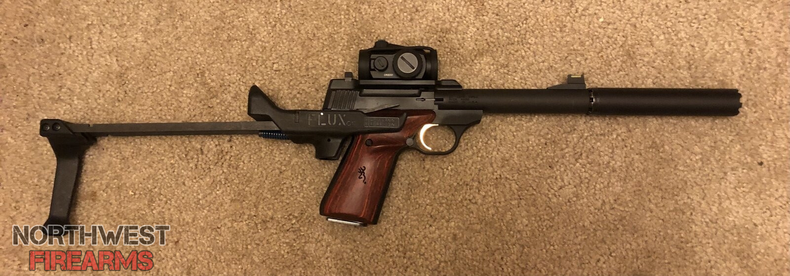

I own a Buckmark and really like the pistol but also like the idea of something like a Flux brace option for it. I haven't invested anything other than some research on line when I found this post so I thought I would ask.
Flux brace clears the frame but not wood grips. If you had aftermarket grips that you could grind down if needed or flat grips it would probably work. You would have to figure out some way to keep the brace on there though. Also flux brace are extremely hard to find now because they have been out of production for so long.

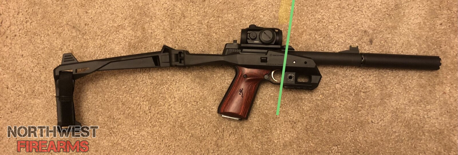

You can find these recover tactical braces extremely cheap, ala $60ish, and if you cut it at the green line it would likely work but again you will have to figure out how to secure it to the gun. That front part of it would have to be cut off. This pic is of it just sitting in the brace and brace will not go on all the way due to that front part. You would also have to take a dremel to the part of the brace that touches the stock/receiver to make it fit snugly but that should take less than 5 min to do.
The opposite side has the slide release which would get in the way also. I have n oversized pic rail on the top of mine and have seen things that fit to a top rail online like this.
