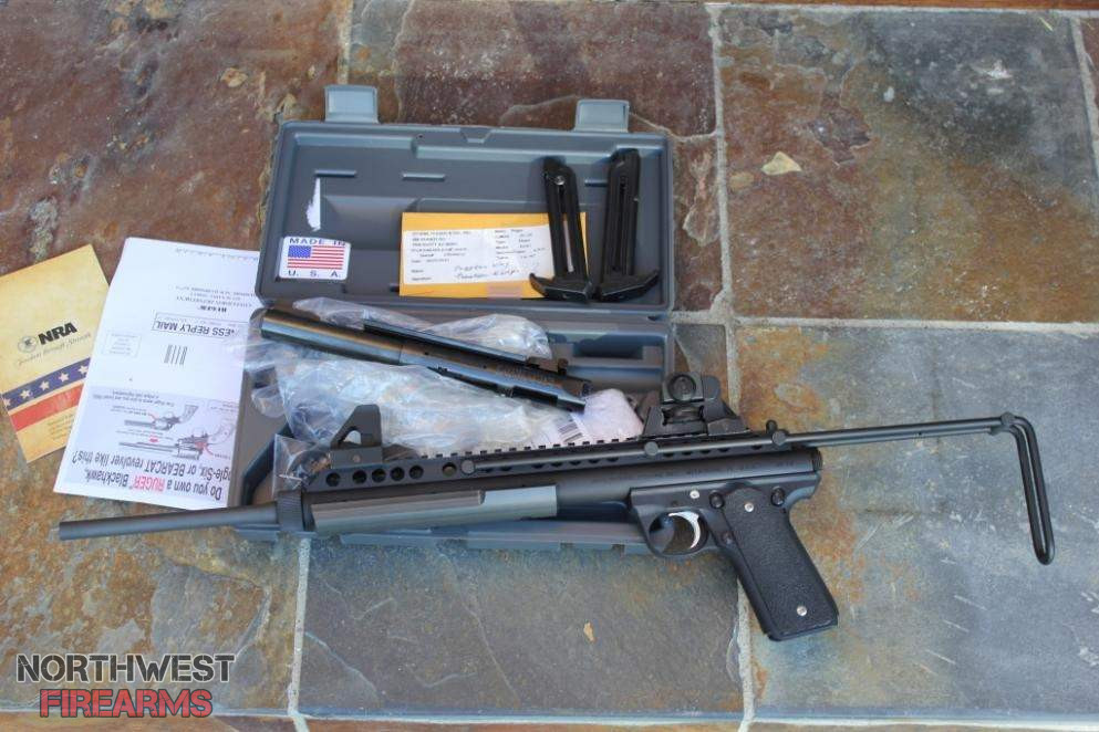

There is a commercial version of conversion with a wire buttstock (I'll try to insert a copy of a pic):
They aren't cheap, but I'm guessing neither was having Clark Custom make and install a barrel for you.
The wire stock has stops on it to keep it from collapsing to less than 26". I guess in some areas where they measure the overall length differently, the stops can be removed to allow it to collapse to even a smaller package.
I have seen that conversion unit and considered it for a while. Ultimately I just didn't like the "tactical" look it has and wanted something a little more traditional lookinig. The wire stock looks uncomfortable as well, I bet it is really cold on your cheek too. The cost on the Clark Custom barrel and installation is pretty spendy, it's up around $500 right now, but what else am I going to do with the money? When you get that itch for a custom gun, it just has to be scratched...
