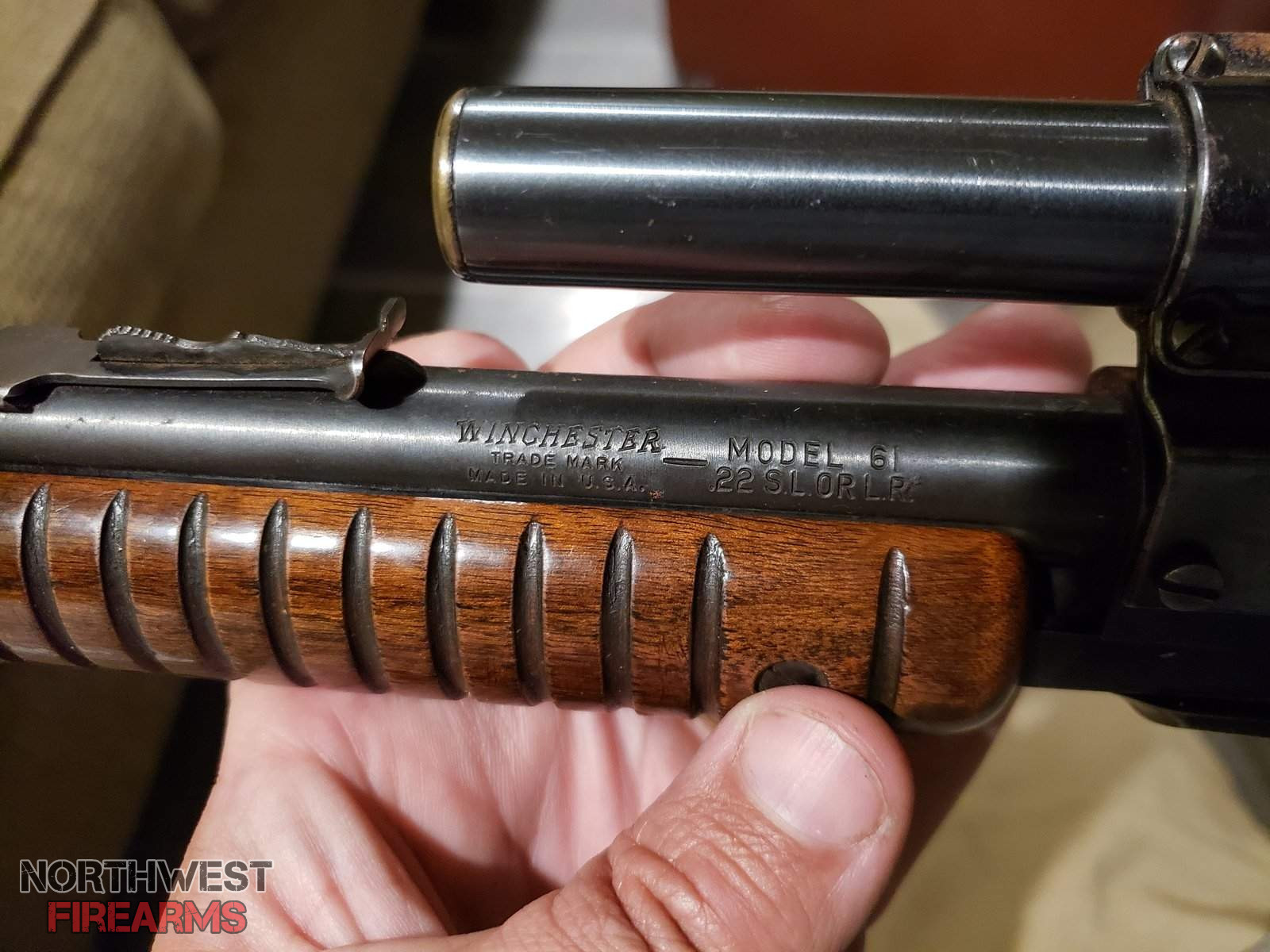

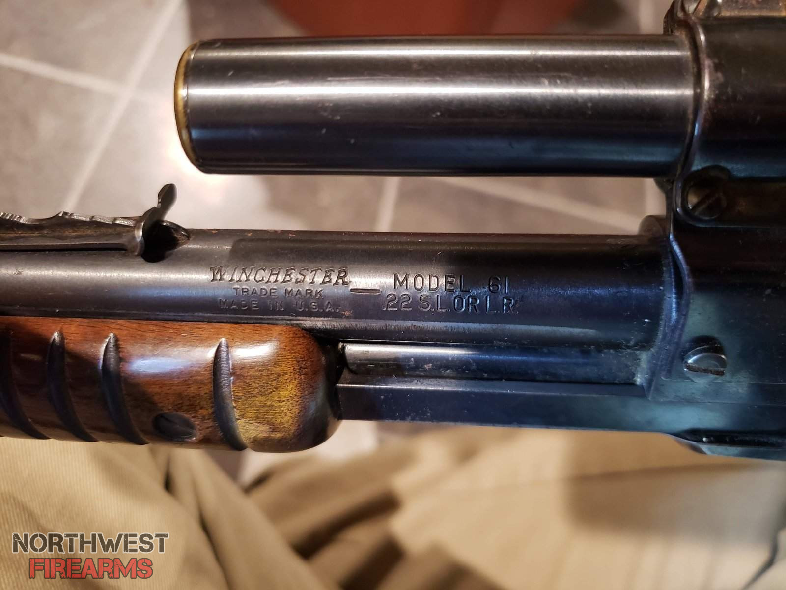

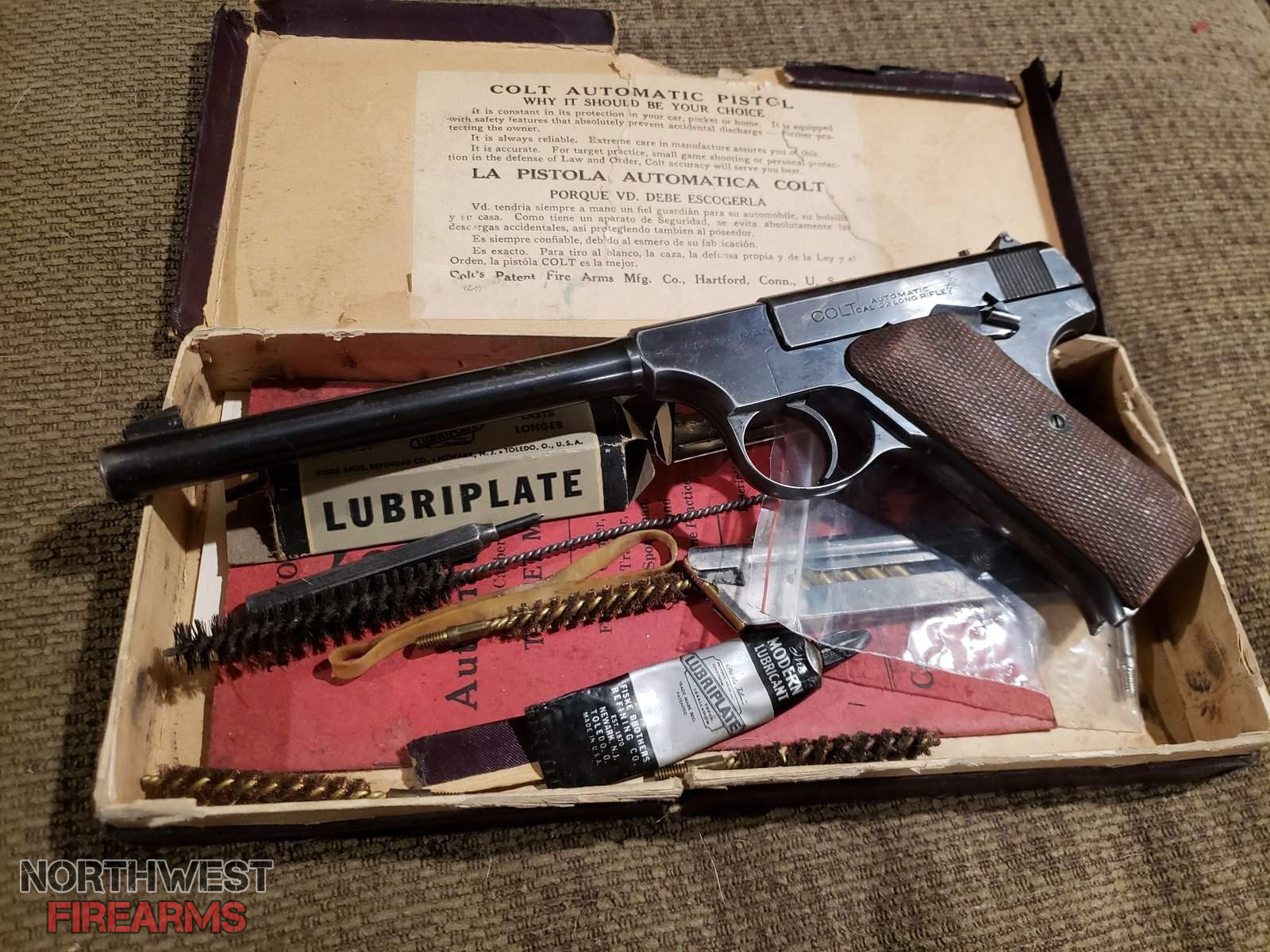

A friend has asked me to help her sell her father's guns. A 1929 Colt Woodsman and a 1953 Winchester 61. Both appear to have some value in the $500 range to a collector; however, both have some minor surface rust.
The 61 is in worse condition but the Woodsman bluing is really thin.
I'd like to clean them up to get top dollar but I'm afraid of hurting the finish/value. Any tips?

Oil and cloth to start....
CLP works well, you can use 0000 steel wool with it, but go lightly. I would just hit the active rust with it. Remember that bluing is controlled rusting, so anything that will remove rust with take the blue right with it.
CLP and bronze wool works wonders as well.
If you have a "Oops moment"... a touch of cold blue ...let it set up and then followed with a wipe down of CLP can at times , blend in real well with existing patina....I have done this to "blend in" repair work on old guns.
That said ...any use of cold blue will affect collector value...
Andy
Some good gun oil and your fingers. Gently wipe the oil all over the metal, let sit for awhile and then just rub the oil around with your fingers. Gently wipe off the excess oil and then see what it looks like.
First time around oil and a rag. Then nylon brush and more oil. If the two previous don't get the job done then steel wool. Both are collectible so you don't want to be too aggressive with the steel wool. But if you do then stick with 0000 as suggested above.
I would never use steel wool on bluing. It's just too harsh. As a buyer, I will accept a little rust any day rather than a steel wooled finish. Bronze wool is much gentler and might be appropriate when used judiciously and with lots of oil.
If you were to re-blue the entire gun, then steel wool is ok. I think most guys with an interest in these classic guns as shooters would likely prefer the honest wear over a re-blue.
The Woodsman looks pretty good wear wise, as is. The wear is all in the right places. The box is a big plus and the two toned magazine is probably worth a hundred by itself.

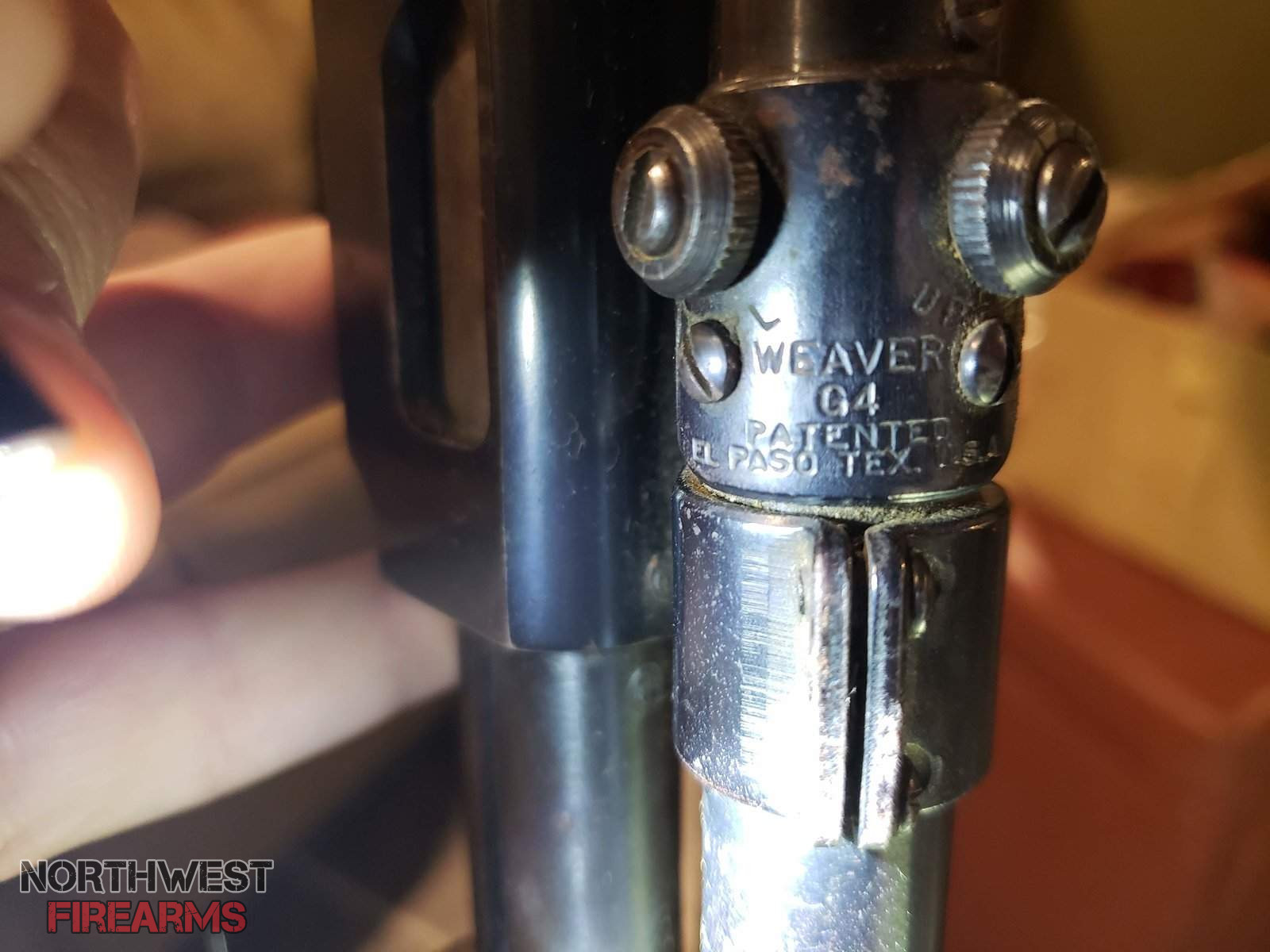

The 61 has a Weaver G4 with an N5 mount. Drilling the receiver to attach these mounts was common practice prior to the advent of grooved receivers in the middle 50's. Those drill holes detract somewhat from value.
If it were me, and I wanted "top dollar", I would consider showing the rifle without the scope and mount attached. Each is of marginal value and I think would visually detract too much from the piece. You can fill the holes in the receiver with screws available from Brownell's.
The scope and mount could be left alone, cleaned up, steel wooled, or re-blued as you may wish and then thrown in as extras on the side. A replacement N5 mount in good shape is available on ebay for around $20. A G4 scope reasonable shape would sell from scarcely more. These were fairly low end in the Weaver 3/4" rimfire line of that period (early 50's) and are very common.

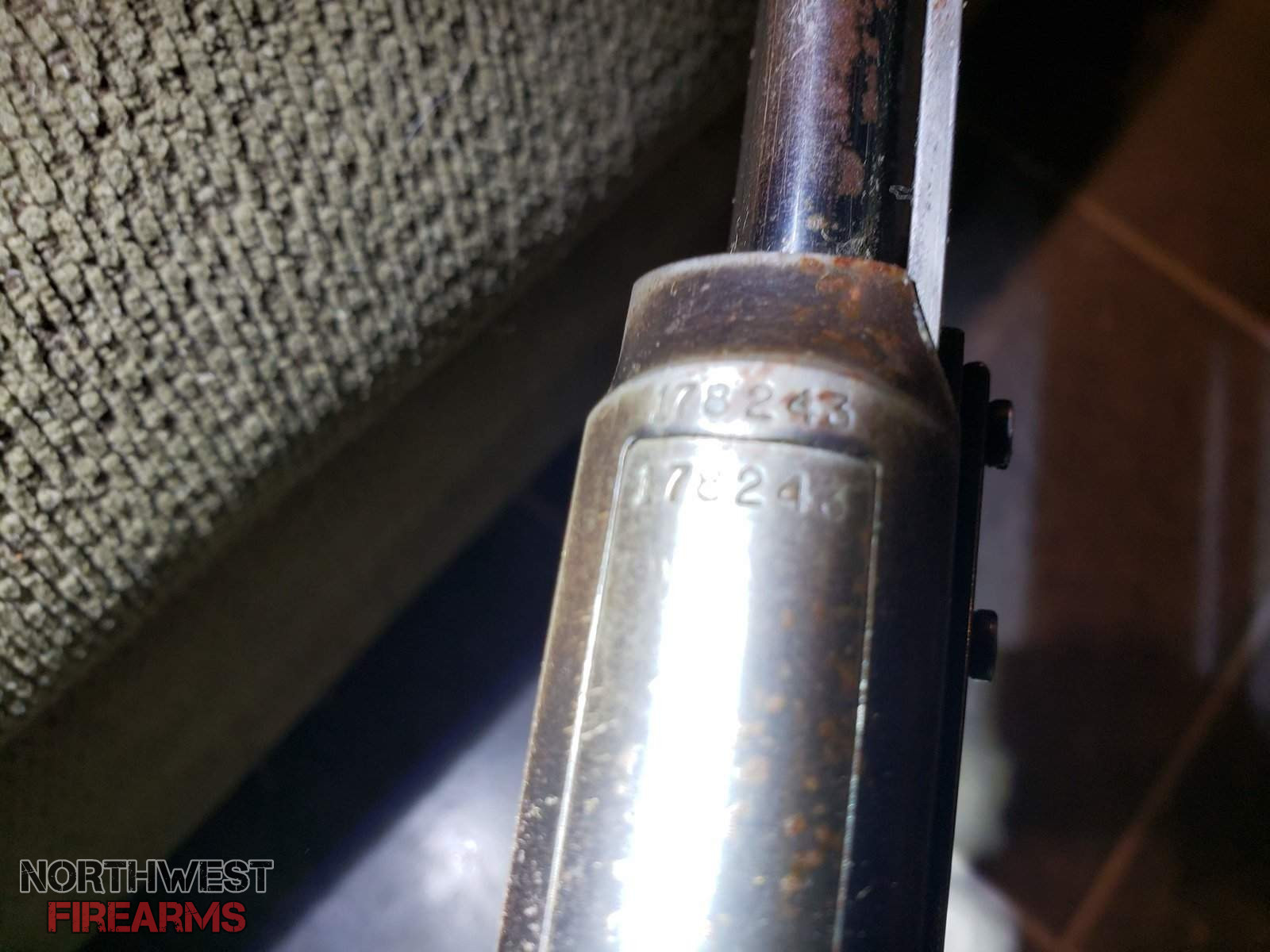

It's the fine line between the bluing that's left, and the rust. If there is rust, there is no bluing left underneath, just what's around it (though visually it can look like more rust than there is)
Oil normally covers up the appearance of light rust, especially if it has thoroughly soaked intro the pores, if you clean out the oil with a thorough degreaser, you can uncover what looks like a lot more rust.
The System I use is Corrosion-X and Stainless Steel Steelwool or Bronze Wool. AND a Very light pressure. My personal feeling is to let the new owner apply the cold blue/finish after they purchase the gun.

I see those old Woodsman's commanding some pretty hefty prices. Don't know if they sell for that much though. That one doesn't look too bad at all. I have a Match Target with a heavy barrel and the target grips. 2nd model I think. That one you have might be a first model? What ever you do, don't take it apart unless you know what your doing. It's not like other pistols inside. If that recoil spring gets away from you........
The Colt Woodsman: A most pined after plinking pistol (VIDEO)
Yes, it's a first model, pre-WWII target made for standard velocity ammo. The box includes the factory cleaning rod and test target. It sold quickly without much effort.
The 61 cleaned up reasonably with the methods suggested and is currently in the rifle classifieds.
