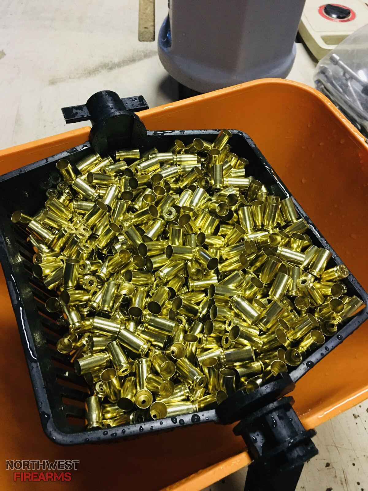

Drop that and stick with the Dawn & Lemishine or just use real lemon juice as I do and your brass will come out like this.
The Armor All probably has some waxy, oily stuff in it that is not allowing you to get bright, shiny and dry brass.
Dawn (1/2 to 1 teaspoon), Lemishine (1/2 to 1 teaspoon), hot water, one hour tumble with lots of pins.
Only fill water about 3/4 full.
Simple rinse & airdry.
These were covered with mud & muck and sat in five-gallon buckets partially filled with water for about eight months before polishing.
I use the whole five pounds of pins.
Hot tap water.
I/4 to a 1/2 teaspoon Lemi-shine
A cap of ArmorAll Wash n Wax
A small squirt of Dawn
Run an hour, drain & rinse.
Fill with new hot water & cap full of ArmorAll Wash n Wax. Run for 15 minutes. Rince h hang on my drying racks.
If they are not where you want them after the hour of run time rince and retumble another hour with new HOT WATER and new Lemi-shine, ArmorAll, & Dawn.
Don't run the brass A full two hours in the disgusting black contaminated water. One hour, Rinse & retumble another hour.

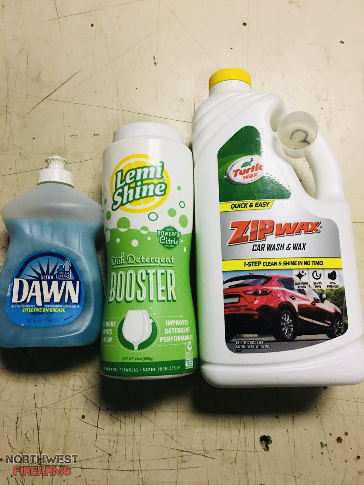

Put 5# SS pins and brass (do not put in more than 5/8-3/4), fill 3/4 with warm water.
In the palm of your hand shake out a out a dime size pile of Lemi-Shine (I never use a measurer), 2 squirts of Dawn and 3) 35mm plastic canisters of car wash/wax.
Tumble for 1 hour, pull and rinse a few to see if they're at desired appearance, if not tumble another hour.

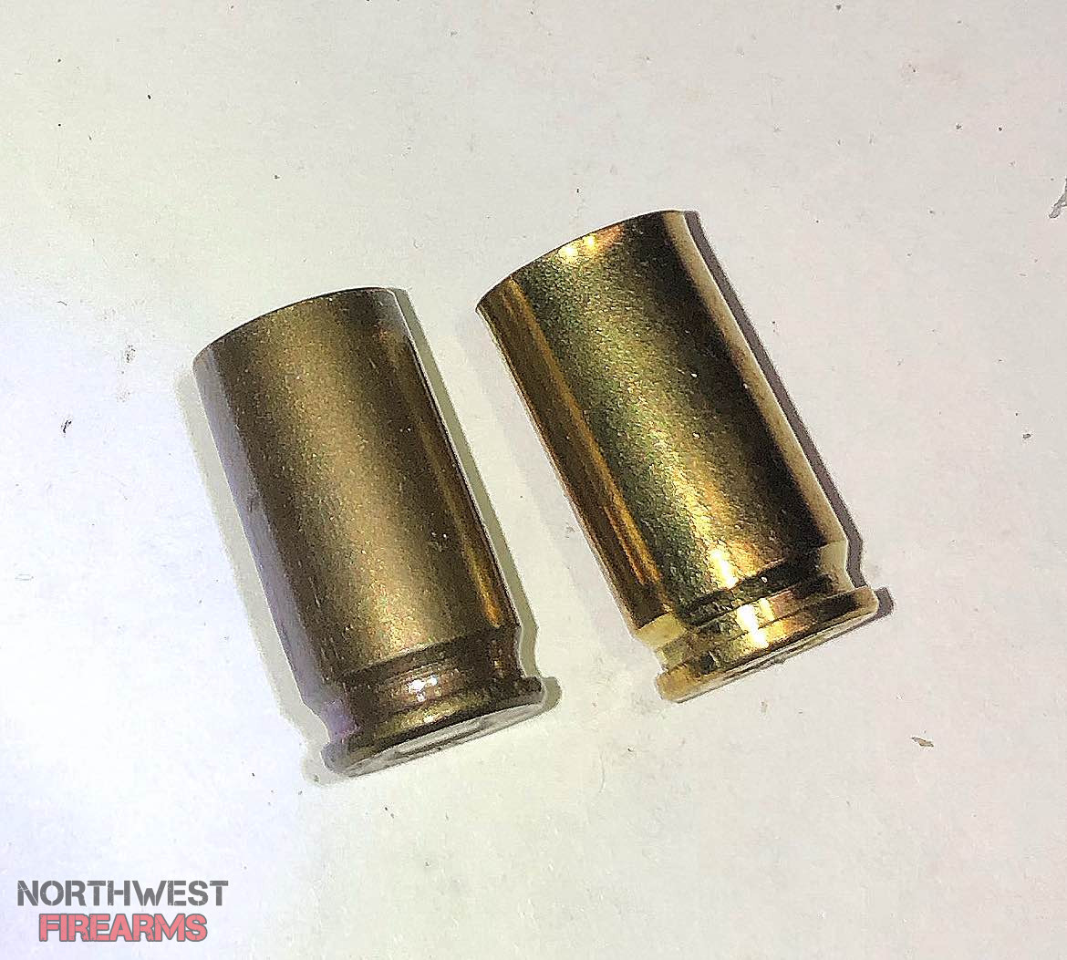

I recently had some pink brass and threw them away. How quickly does the dezincification weaken the case? Will the neck split when firing?
Rose gold vs new
Both shoot fine.

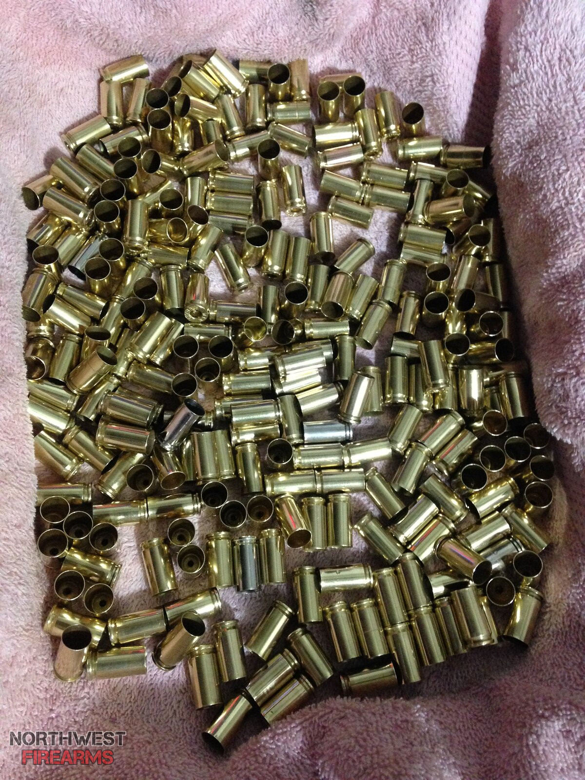

I too use car wash/wax as follows:
- Franford Arsenal Platinum tumbler with S/S pins about 80% full of warm water
- a 9mm case full of Lemoshine with about 3 squirts of Dawn for about 20-30 minutes. Dump dirty water, refill with warm water and add a cap full or two of car wash with wax for another 20-30 minutes.
Results are "mavalus darling!"
