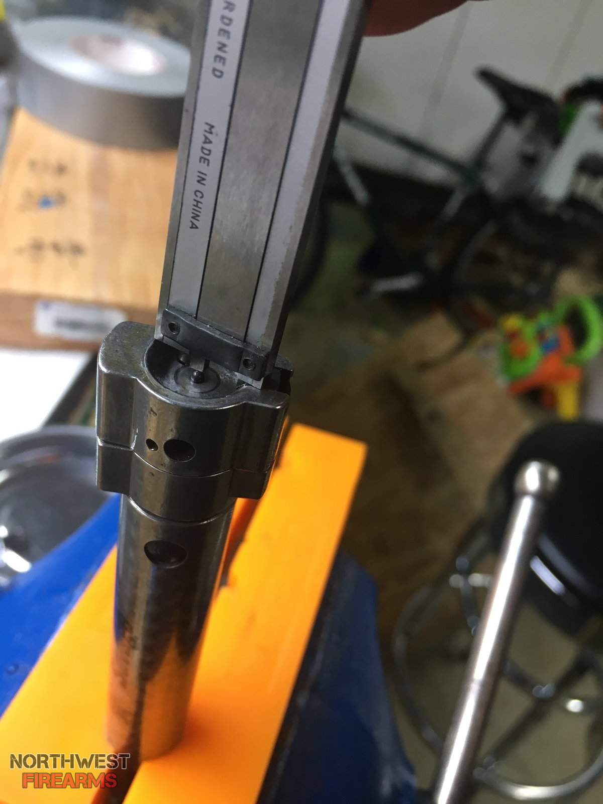

If you're pin extends 0.060" from the bolt face as you say, check the K value of spring or for free movement and no binding.

and this is how i got .061
if i have to measure it from the breachface to the tip of the pin i am thinking im going to have to get a different measuring tool.
It looks like you are measuring from the very end of the bolt to the tip of the firing pin, to get the .061".
You need to measure from the breech face of the bolt (the recess, where the case head rests,) to the tip of the firing pin.
You should be able to do this with your dial calipers, just move the depth gauge part to one side of the firing pin, measure from the very end of the bolt like you have pictured to the breech face, then measure from the very end of the bolt like you have pictured to the tip of the firing pin, and subtract. (say the measurement from the very end of the bolt to the breech face of the bolt is .120" and the measurement from the very end of the bolt to the tip of the firing pin .061", you have a firing pin protrusion of .059".)
At least that is how I am seeing how you are getting your measurement of .061".
Hope this helps.....

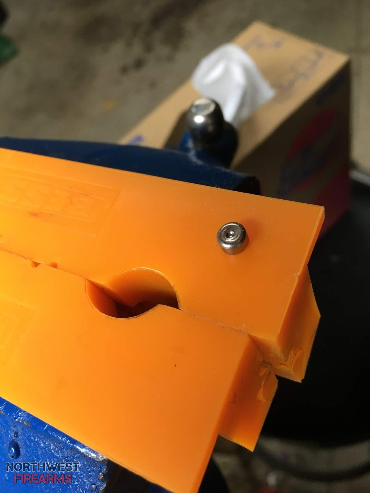

having a heck of a time finding the correct firing pin for this gun. it is not the savage 110 firing pin that is adjustable like previous years. its apparently the same pin as the axis model and i cannot find anything online. any help would be much much appreciated. looks like this:
Here you go..............
Firing Pin, Long Action Gun Parts | 1401130B | Numrich Gun Parts
Firing Pin, Short Action Gun Parts | 1401120B | Numrich Gun Parts
