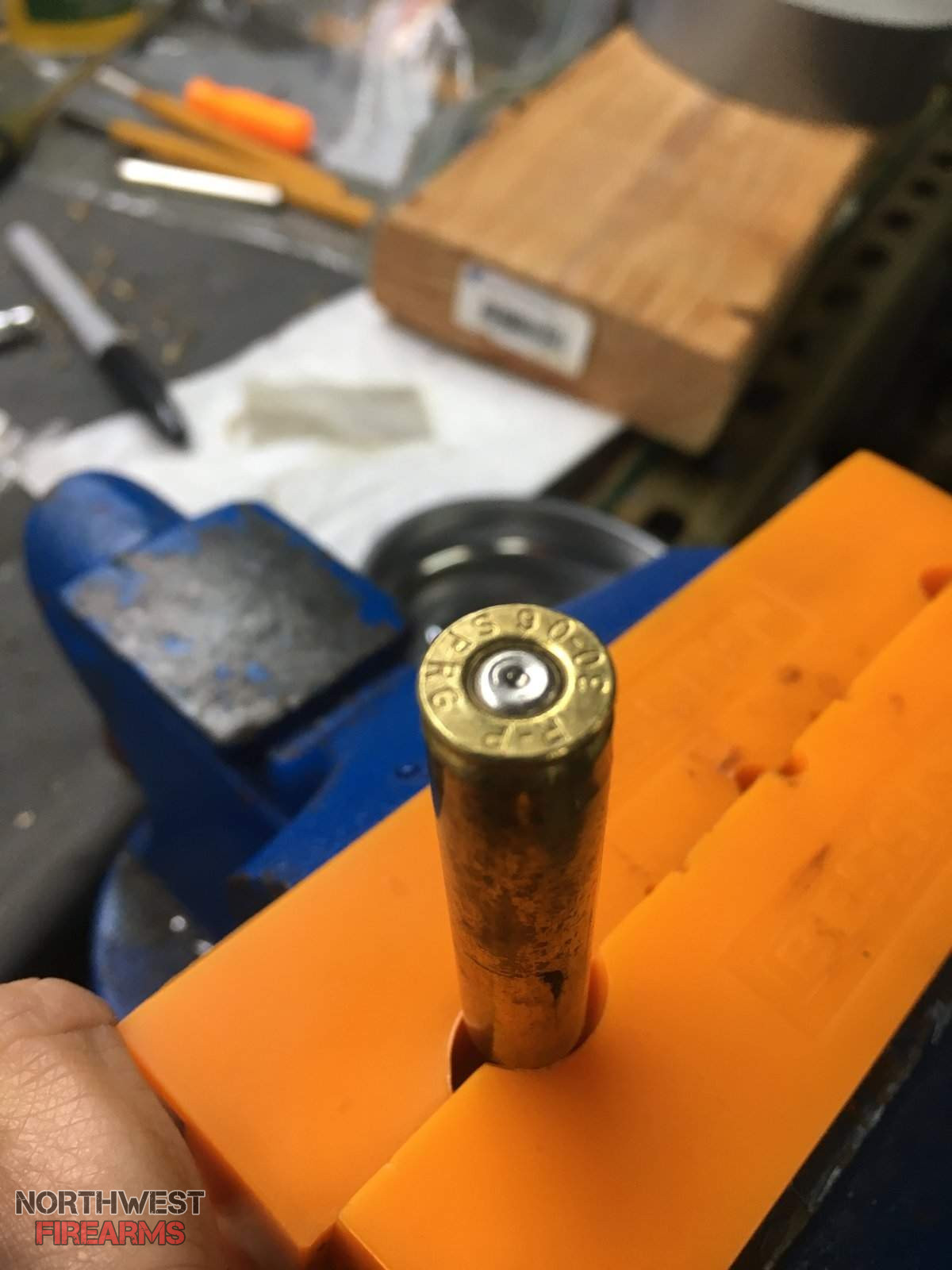

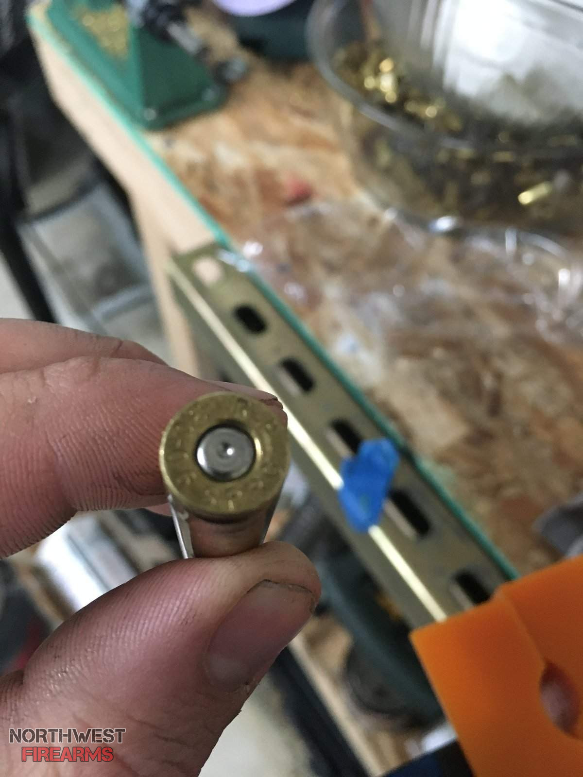

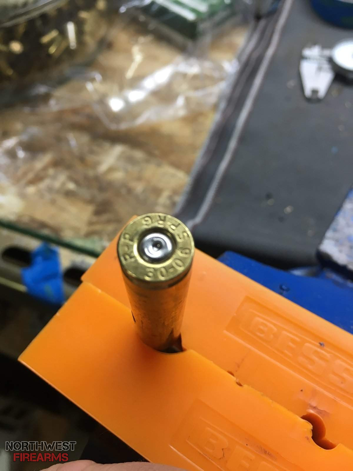

i handload 30-06 for my brothers hunting rifle, a savage 111 trophy hunter xp(rifle has MAYBE 50-60 rounds thru it). when we were sighting in, he had a fail to fire aka a misfire/dud. i told him keep it down range for a bit and once we felt safe that it wasnt going to fire he ejected the round and we inspected. we found that the primer had been hit and it was hit good. i would not call it a light strike. did not have any other issues the rest of the day. when we were hunting he had a deer in the cross hairs and then "click" another misfire. instead of waiting he jacked another round in and shot at the deer. missed. unfortunately, we could not find the dud round to inspect it.
the first misfire was a magtech LR primer and the second was a CCI LR primer.

The first pic...doesn't look good. But, the other pics looks like a good strike.

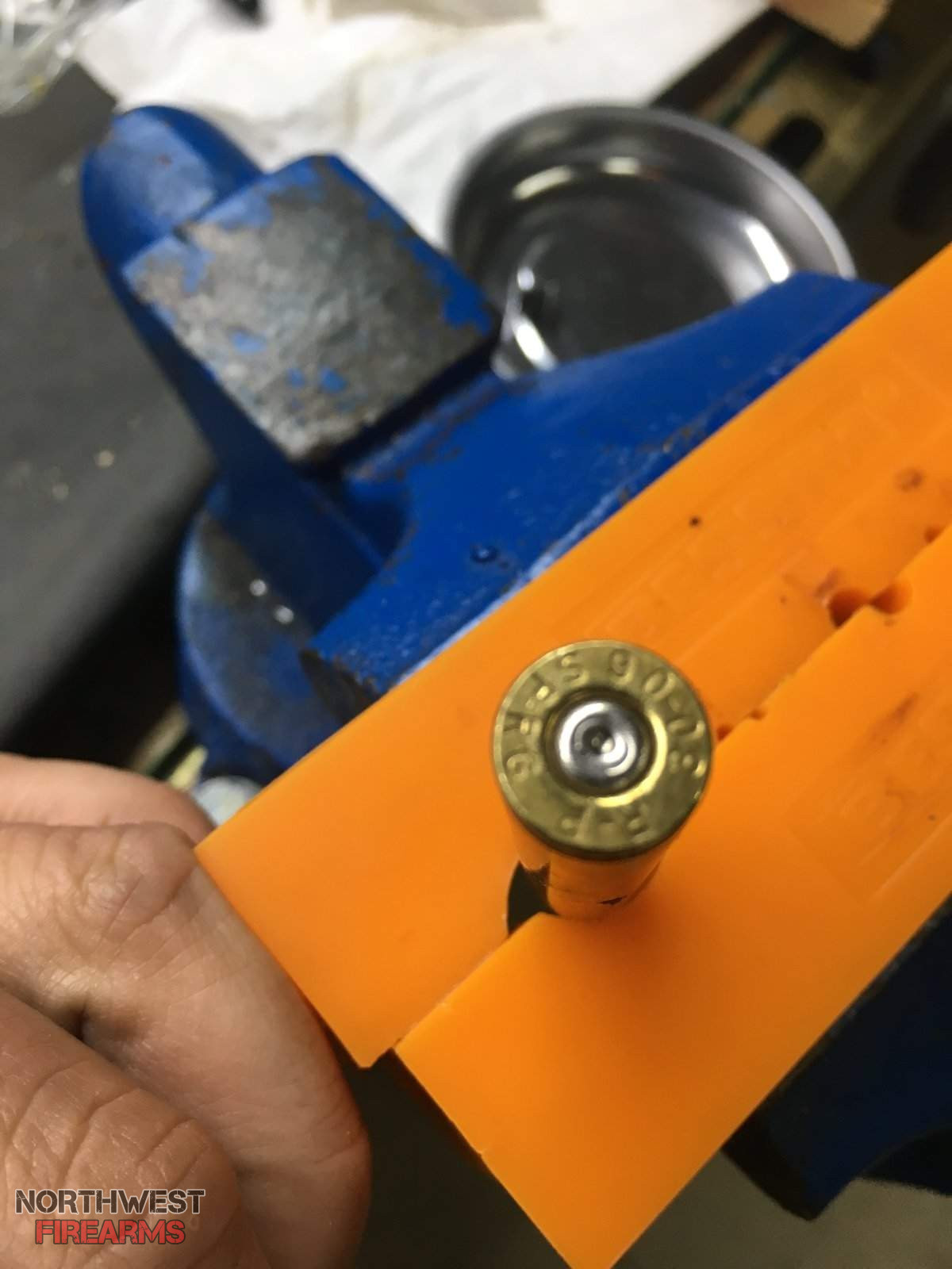

ok i am mistaken. he did not have a hang fire it was a misfire. i will edit my original post. i am starting to wonder if i measered the FP protrusion correctly. i measured from the end of the bolt to the firing pin then the end of the bolt to the breach face. then found the difference. correct me if i am wrong. i can re measure it too and take a picture.

.061 that is from the end of the bolt to the pin
Good enough!
Ok what did the primer pockets look like prior to putting the moist garage primers in :)? Were the pockets dirty?
so i measured all 3 of the savage rifles in my safe. 308,30-06,300wm and they all measured .061. the reason i wrote .050(yeah my math wasnt exact) was because i was subtracting the smaller from the larger number in the pictures
and this is how i got .061
if i have to measure it from the breachface to the tip of the pin i am thinking im going to have to get a different measuring tool.
thank you. for the life of me i couldnt find that anywhere.

I looked at the photos. The first one does look like a light strike. the second one looks like a real hard strike. I was wondering if you pulled the bullets to check the powder in the case?
